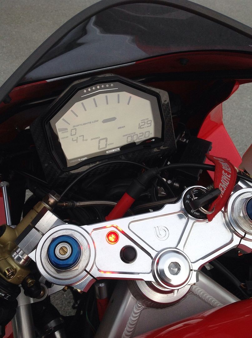

another picture Smile

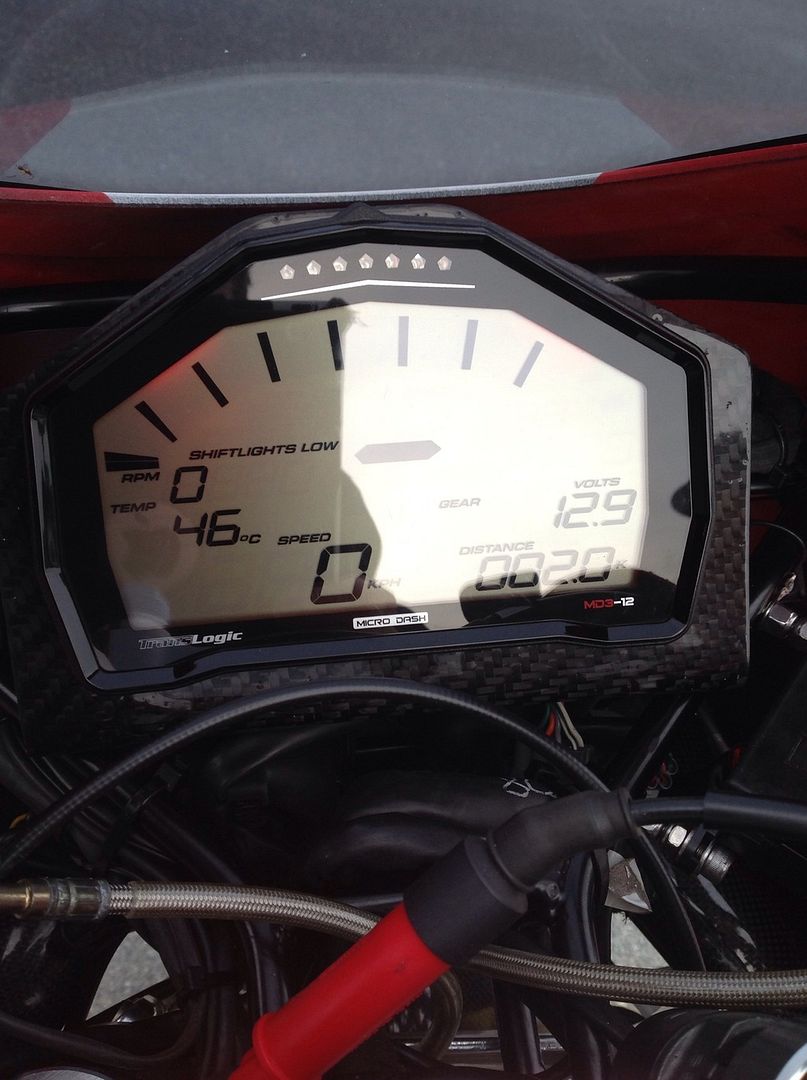

yes this is one of the last fully sorted bikes from Piero.
this is what I did to make it work:
New modified wire harnes ( did not want to cut in the original )
Zeeltronic PDCI-24V
2 new coil + homemade CF bracket ( you can use aprilia rs250 coils)
Translogic micro dash + homemade CF bracket
new rotor from Guido

I felt the timing and exhaust valve curve could be improved.
The PDCI-24V is fully adjustable.
For the zeeltronic to work I needed new coils and a new dash.
The Translogic dash is a hughe improvment of the old one.
I have not had time to ride it, but when I do I wil give you an update.

Had a test drive to the local Cars and Coffe yesterday, and the bike is faster!
Stil needs the some jetting changes.
This is my current settings:
Right:
220
120
60
350
-K83
-2 turns out
Left:
220
120
60
350
-k76
-2,5 turns out
