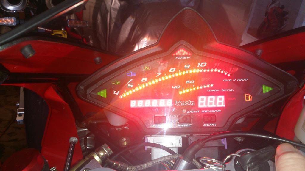

As others are saying...and congrats on getting out and about...I was out on my Vdue on Sunday also...so thats 2 in the UK out on the same day...more of a treat for other bikers as you say...you'll not be short of folk wanting to either chat about it or ask what on earth it is......and "what manufacturer did they get the engine from mate?" is the common one....
Yup rear discs are a high iron content rather than cast iron or SS...supposed to have more friction...fronts will be ss so no issues on when they get wet.....rears are fine, even when wet...but dry them after washing or you'll end up with a golden disc 10 minutes later....the master cylinder can dry out and get stuck...locking on eventually....dont forget the bikes are 17 years old..as are the parts fitted to them....pull the plunger out and remove the rubber cap and make sure the grease under there is fresh...could have dried out.......
Oh and pictures please............ Laughing
And just to shame you...heres Sundays piccies
First Sign of Spring sunday 8.30am
So it was out with the bug spray straight away....let these things breed and its more bugs to spoil the front of your bike at speed... Wink
Pre-start up checks
Yup some things working...some things not..but nothing new...so all good so far....
And out and about...
and "arty" ones to close

inncredible the electronic speedo tacho seems working Laughing
just kidding but all the french V Dues I know with such one haven't got one which work Confused
am older typ on mine so no trouble Cool
PostPosted: Mon Mar 17, 2014 4:31 am    Post subject: Reply with quote
some dipshit has drilled holes all over your fairing Laughing
PostPosted: Mon Mar 17, 2014 12:35 pm    Post subject: Reply with quote
a lot of the electronic tacho works....only bit that doesnt is the water temp...stays on at 40 degrees and doesnt move at all...so I'm sourcing a new sender in the hope that it may one day work...other than that all good...even the low fuel light works...which is good....as it comes on a lot with these bikes...even a 70 mile trip and it will come on.....
