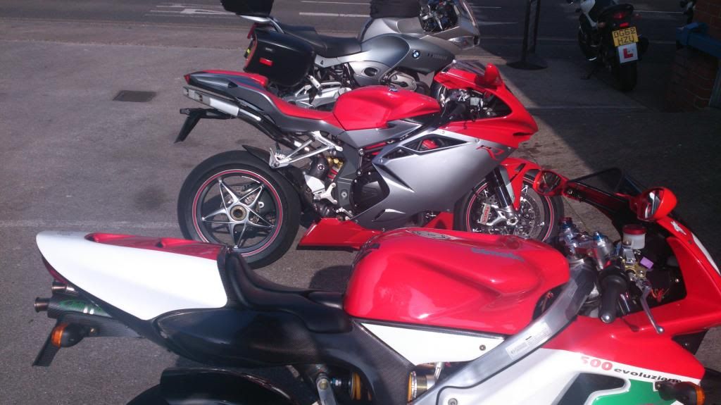

And just to shame you...heres Sundays piccies
First Sign of Spring sunday 8.30am
So it was out with the bug spray straight away....let these things breed and its more bugs to spoil the front of your bike at speed...

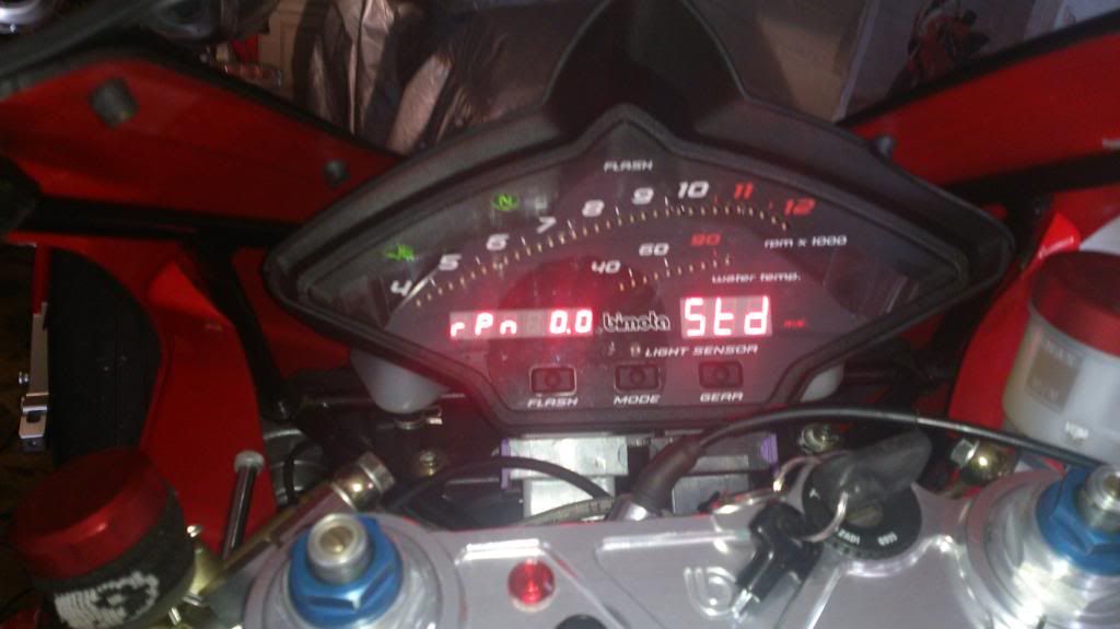

Pre-start up checks
Yup some things working...some things not..but nothing new...so all good so far....

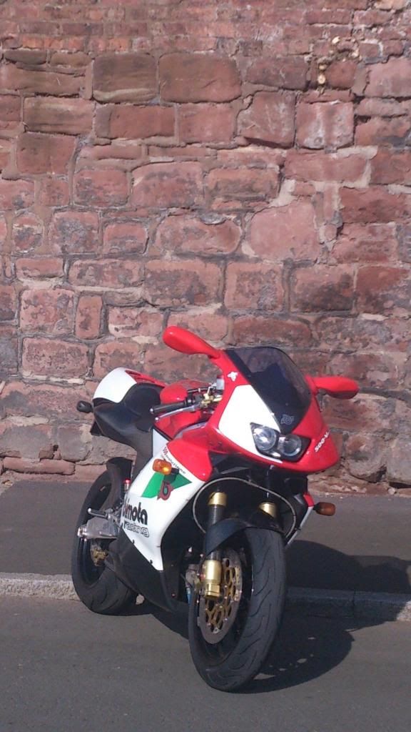

And out and about...
and "arty" ones to close

Posted: Sun Mar 16, 2014 7:18 pm Post subject: |
inncredible the electronic speedo tacho seems working
just kidding but all the french V Dues I know with such one haven't got one which work
am older typ on mine so no trouble  |

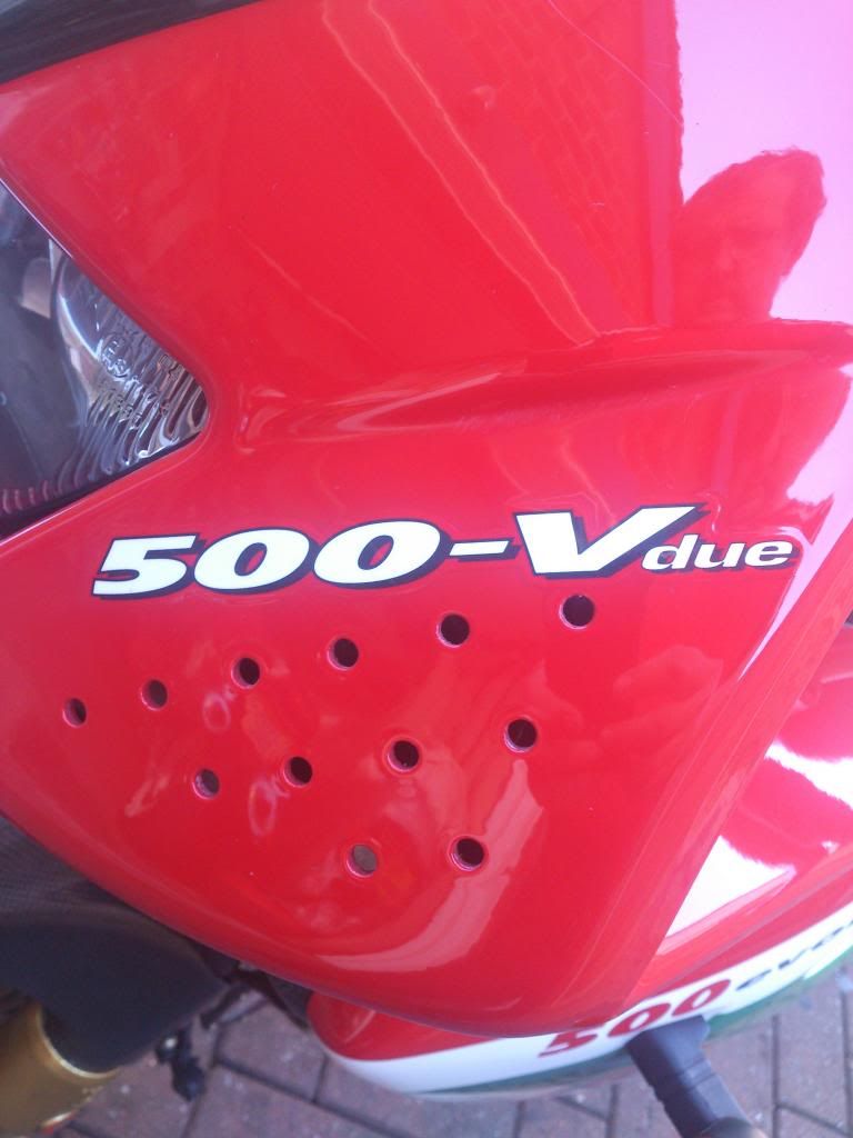

Posted: Mon Mar 17, 2014 4:31 am Post subject: |
some dipshit has drilled holes all over your fairing  _________________ '99 DB4 #104, '96 SB6 #1165, '94 DB2 J #652, '99 DB4 #088, '08 VTX1800, '93 ZXR750R M1, '95 ZXR750, '95 ZXR750 Race Bike, '94 CBR400rr NC29 Race Bike, '94 CB250, '49 BSA C10 250, '61 BSA A10 650, '89 ZXR750, '91 Ducati 851 |
Posted: Mon Mar 17, 2014 12:35 pm Post subject: |
| husson73 wrote: |
a lot of the electronic tacho works....only bit that doesnt is the water temp...stays on at 40 degrees and doesnt move at all...so I'm sourcing a new sender in the hope that it may one day work...other than that all good...even the low fuel light works...which is good....as it comes on a lot with these bikes...even a 70 mile trip and it will come on..... |
