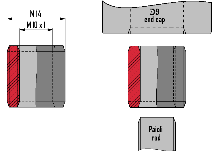

Pin 8,5mm long and 4,7mm thick.
Rubber ring 4mm long 10mm in diameter hole in the middle of 4.5 mm
Insert, outside M14 inside M10x1
Use the ZX9 spring with spacers and rings.
It is not possible to use the Paioli spring, the spring is to long.
For me the ZX9 spring work fine, it’s lighter in weight, stiffer and it feels much better than the Paioli.
I’m not complaining any more.
To connect the rod to the ZX9 end caps you have to use an insert.
The rod is M10 x 1 and the thread of the ZX9 is M12
(I did go from M12 to M10x1, it’s possible but it is a very precise work to make)
I recommend M14 to M10x1 insert.
Drill out the M12 and change it to M14.

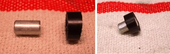

For the re-bound I had made a small pin.
I left a space between the upper rod end and the re-bound adjuster of 9mm. (when screwed together and the re-bound adjuster screwed as far out as possible)
The small pin is 8,5mm long and 4,7mm thick.
Over the pin I slide a rubber ring for positioning the pin in the middle of the preload adjuster.
Rubber ring is 4mm long 10mm in diameter.
The pin should be installed in the space between the rod end and the re-bound adjuster.
Oily made a pin that’s like the Paioli pin only 8,5mm longer.
