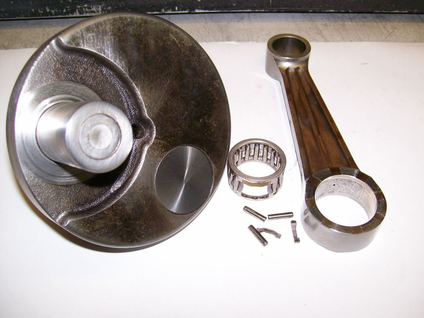

1 crank needs work ! gutted
trev45
Joined: 15 Jun 2011
Location: Sydney Australia
PostPosted: Fri Sep 11, 2015 12:48 am    Post subject: Reply with quote
Better new always
Trev

What is wrong with the crank ?
Trev
EYREY1
Joined: 28 Nov 2014
Posts: 113
Location: WAKEFIELD UK
PostPosted: Fri Sep 11, 2015 4:56 pm    Post subject: Reply with quote
its the big end bearing bearing pin or con rod or all of them
trev45
Joined: 15 Jun 2011
PostPosted: Fri Sep 11, 2015 10:40 pm    Post subject: Reply with quote
So just a rod kit cool , easy fix then
do them both , it will love you for it
Trev

guido says 160 euros for a std rod kit
so im going to order one
save a bit and get some better slotted ones
and put them in when it breaks lol

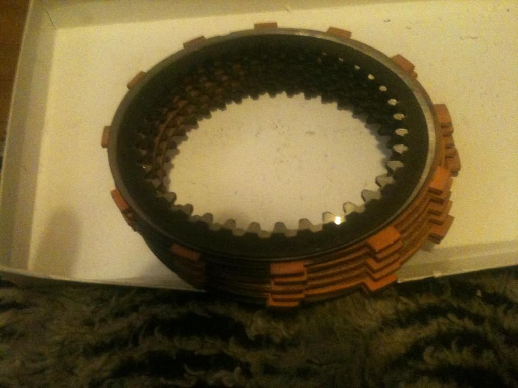

Whilst youre checking and keeping spares...I presume you have a clutch pack? Check how many plates with the friction material you have...if you've bought a new one from Piero you may find theres only 5 plates with friction material and not 6 which is what is needed....a couple of packs that came from Pieros supplier recently both had insufficient number in them......... Sad
EYREY1
Joined: 28 Nov 2014
Posts: 113
PostPosted: Sat Sep 12, 2015 4:01 pm    Post subject: Reply with quote
did he sent you the extra plates ?
i got these just after xmas these are going in the bike so i need to get another set
