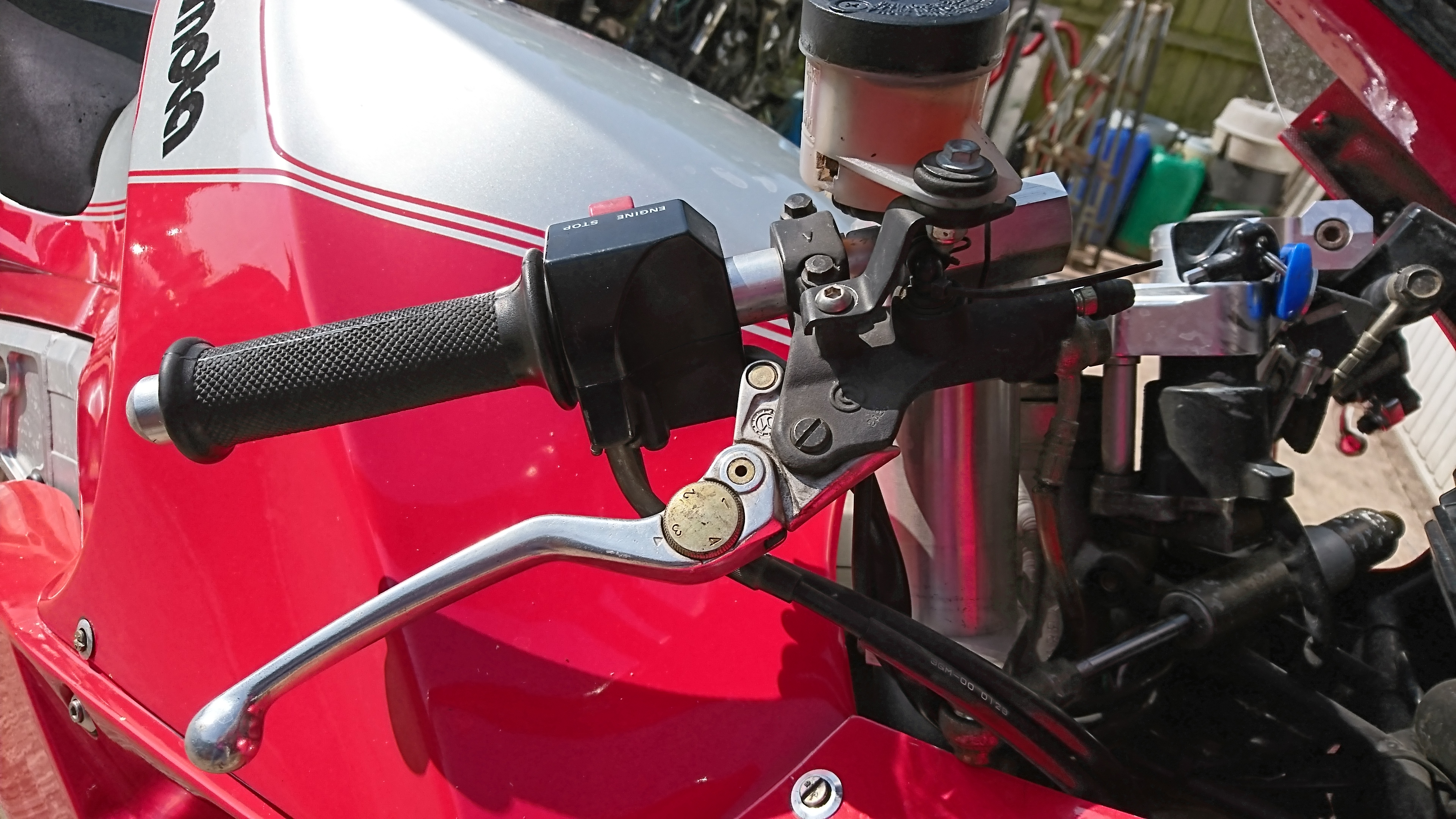

I have a Brembo master cylinder from an Aprilia on mine. Gives the brakes far more feel. Ultimate power possibly not better but I far prefer it.

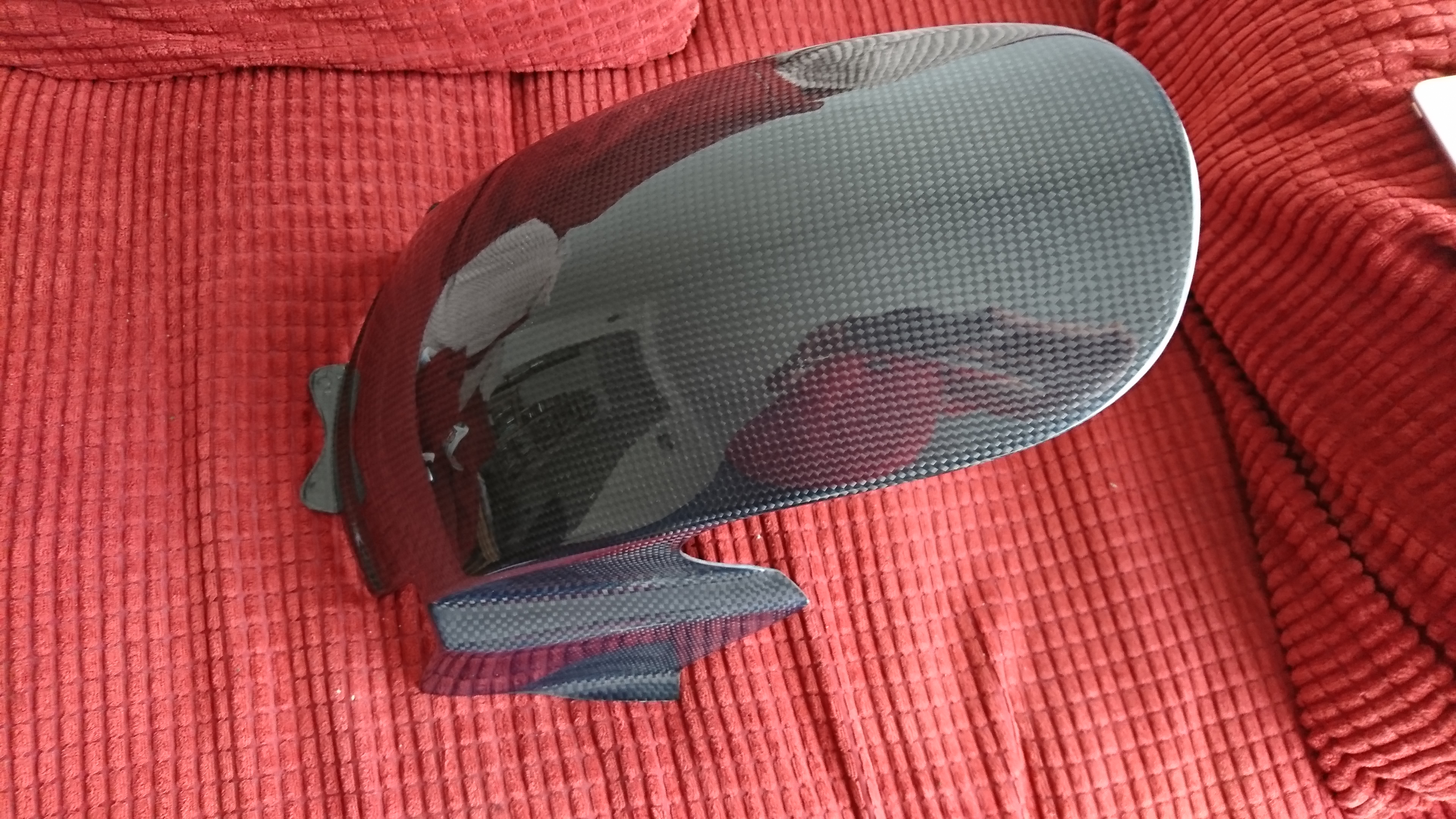

I have a new rear hugger on order at the moment. The original wasn’t great and I have tried repairing it a few times. Ordered a carbon fibre one. Can go on unpainted and I will see how I like it.

Any chance you could put up a pic of your Aprilia master cylinder?

Hiya
This is the master cylinder on mine.
http://www.alfa-pages.co.uk/TempPicture/DSC_0831.JPG
Big piccy so just a link.
On the clutch side I have the original master cylinder but I have an adjustable lever fitted (sourced from Wemoto , on the fzr1000 section).
Katy

Thats a brembo black series brake master...used on Ducatis also.....the slightly more modern Gold series is still available new...like these below....although you'd still need to buy the reservoir pot, short run of brake line hose, 2 clips and the alloy perch/support

Katy, i pulled my rear hugger off. Some cracking around the mount and previous repair. Its in a decent shape so I thought about getting it repaired and refinished but after reading about your CF hugger I am interested. Please post a link so that i can take a look. Thank you.

Ordered from here
https://www.motoforzafairings.com/rear-fender-hugger-bimota-yb10-91-93
They do them in grp , carbon fibre or Kevlar. While cf is more expensive than grp the postage makes it less difference than it first appears.

Hugger arrived just now.
Big piccy so a link:-
http://www.alfa-pages.co.uk/TempPicture/DSC_0842.JPG
