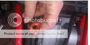

Vort28 - is there a special way of getting the fuel pipe off - or is it just a straight pull to get it off and on?? Sorry to ask just don't want to break it. Thanks. Bob.
PostPosted: Tue Jul 04, 2017 12:48 pm    Post subject: Reply with quote
Hi Bob.
I assume you mean quick release under the tank ,
You have to push the red coupling ring along the black coupling body to release the internal clips. Can't remember if you push away from coupling or towards it , but one way will release the coupling.
