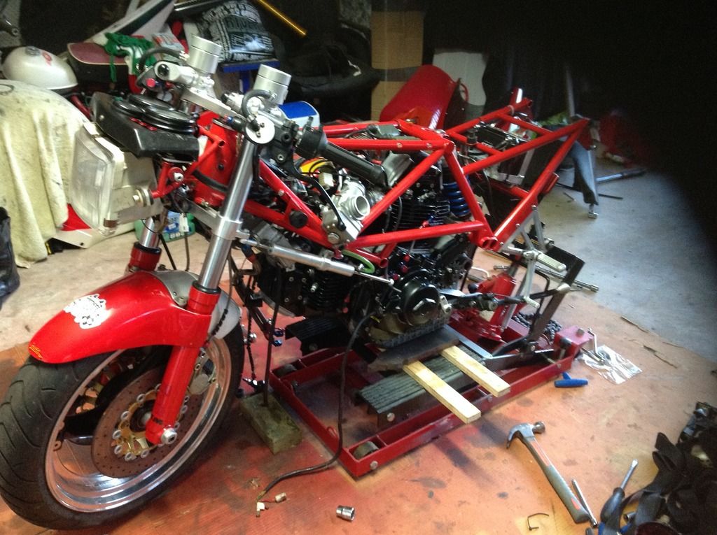

Wrestled with getting the motor back into the frame by myself tonight for 2 hours. No joy!
Will get my hrother to help me tomorrow after work.
Easy to take the motor out but hard to line everything up when refitting the motor .The spacers are a bastard to fit to the mounting bolts for the engine as they are a very tight fit between the engine case and the frame.
Hope to get it back in tomorrow arvo.

Posted: Sat Jan 07, 2017 10:11 am Post subject: |
This bike has nuts seperate to tighten mounting bolts.
My brother came over and helped me . It was still a pain but we got there now to put it all back together and take to Mr Gowanloch.
Carbs need rejeting and hopefully Ian gives the bike a good going over.

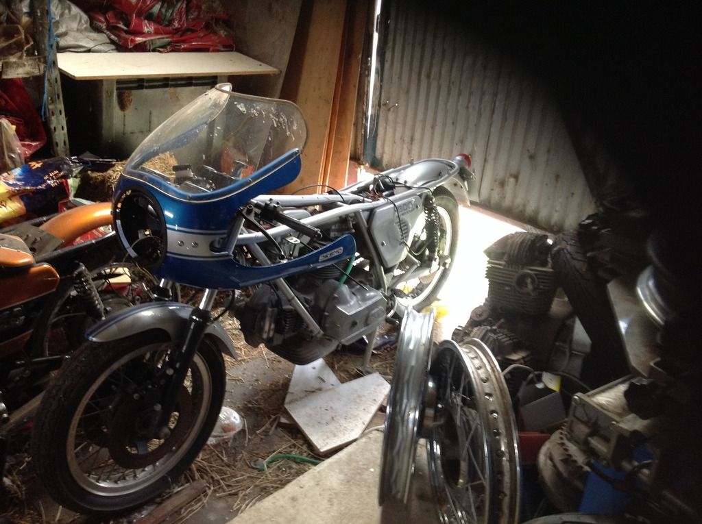

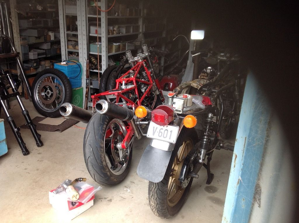

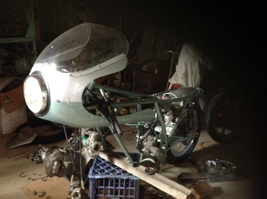

In the shop ready for some attention.
How's this for a rare bike
And this,
A great day out, everywhere I looked there was a bike that was interesting !
