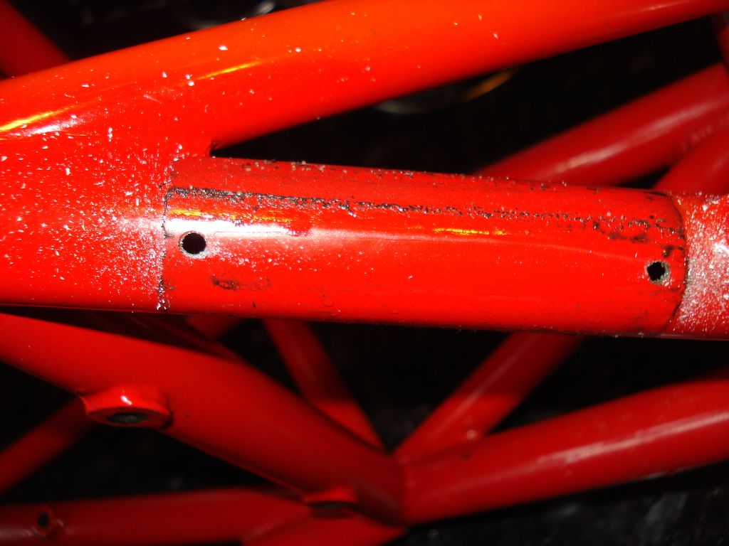

Cheers Chuck....most of the wear to the frame and swingarm is just to the original Factory Bimota powder coating......something that other manufacturers still dont do today...surprising really....that bikes that are often so cared for or just plain not used get such a protective coat direct from the factory....
Yesterdays task was finding a powder coater still in business....the old place I used to use now has new houses standing on the land where there warehouse used to be...the 2nd place I tried the whole landplot has been sold off to a supermarket...so it was onto the 3rd place on my list...Hindley engineering...who purely do powder coating...and glad to see things have moved on....He had all the RAL numbers and colour patches to choose from for frame red, silver valve colours and Ohlins yellow shock....as well as some fandango metallic finishes also....

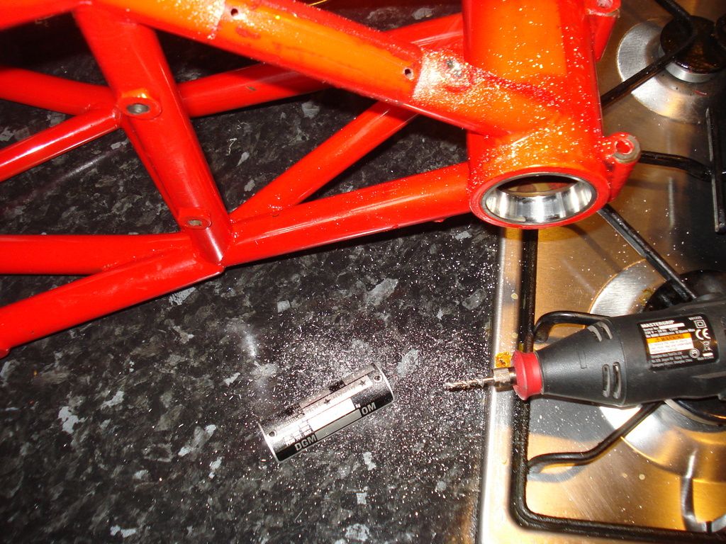

I'd prepped the frame griinding flush any imperfections or previous grind marks from chain rub....and masked off areas I didnt want powder coating.
Blokey down there outmarkets the grit blasting so that the grit in the air doesnt comtaminate or get into his painting service and ovens....he assures me that once back from the grit blasters he fine emery cloths down the surface to get really fine flat finish....then bakes the bare parts at over 200 c to burn off any residuals....then air blasts clean....then heats bare clean metal to over 200 again and then powder coats on to that and bakes again.......he did show we the air gun arear...and emery cloths etc etc....and then gave price of 150sovs for the 12 parts I took down...4 valve covers to silver, one spring to yellow...and 8 separate frame parts to red....ideally he and others prefer one colour everywhere...and the more colour you choose the higher the price....there were colour matches for frame, engine covers and ohlins yellow...oh and of course he blanks and plugs all tapped holes and areas you dont want doing...like the inner "hub" where the rear wheel concentrics go....
Prior to taking down it was the all important task of removing the vin tag delicately...so it can be re-rivetted back on later...
Always use my mini dremel and steel bit to drill out the old rivets rather than big hand drill..more precise and less likely to slip or drill right through to the otherside....

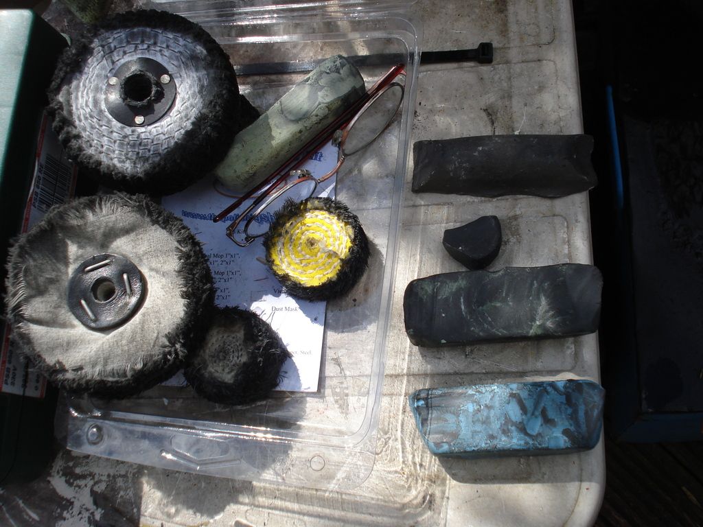

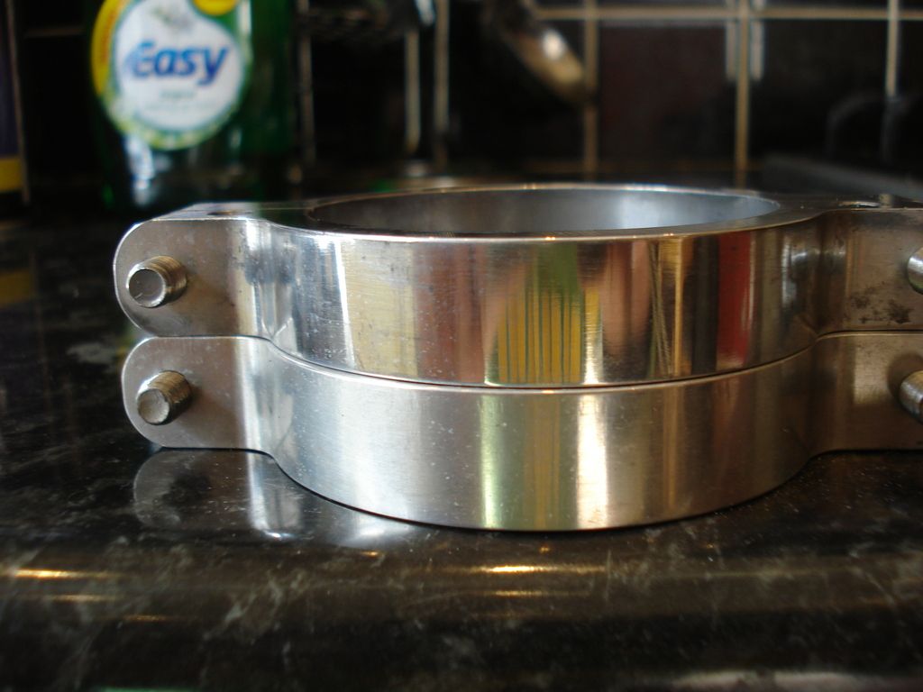

Polishing time as the sun had come out....although only 6 degrees today...and it did snow later on also...so too cold for painting....

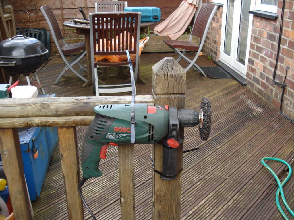

Got the old mops out and waxes///....Coarse nylon mop on power drill for deep corrosion/tarnish...then coarse sizel and grey wax...then medium sizel and green wax...finishing with fine cotton sizel and blue wax....
Rigged up the variable speed Bosch power drill to decking ballustrade with newly bought cable ties....."on" button can be locked for continual polishing...vari speed essential as certain mops work better at high or low speeds...as you can "burn" the wax you're applying to the surface if too high
PostPosted: Wed Apr 27, 2016 11:31 pm    Post subject: Reply with quote

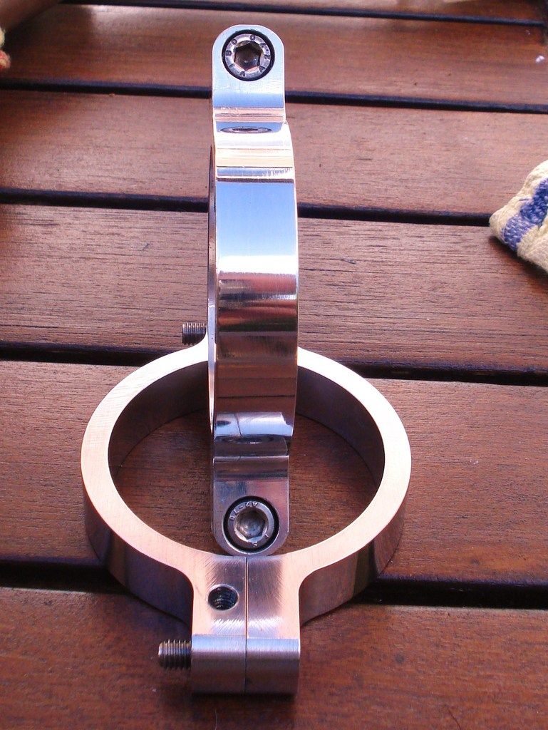

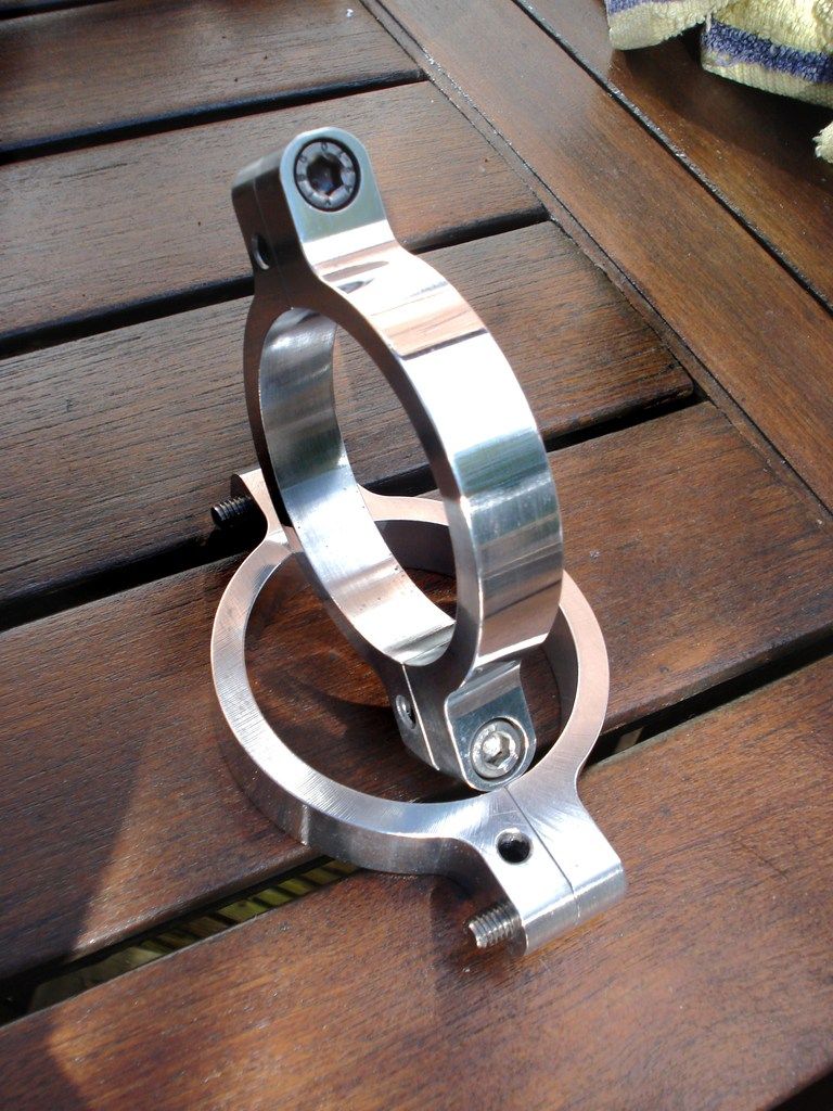

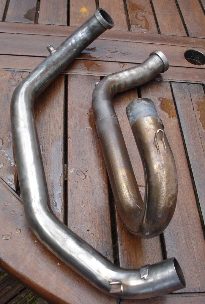

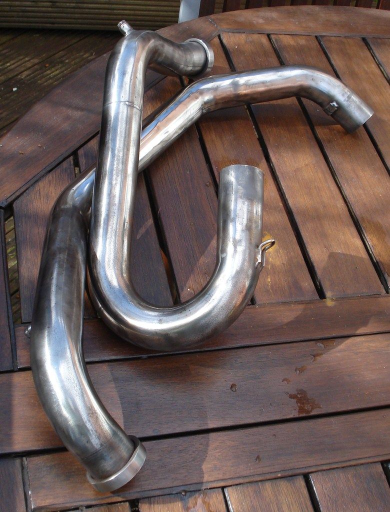

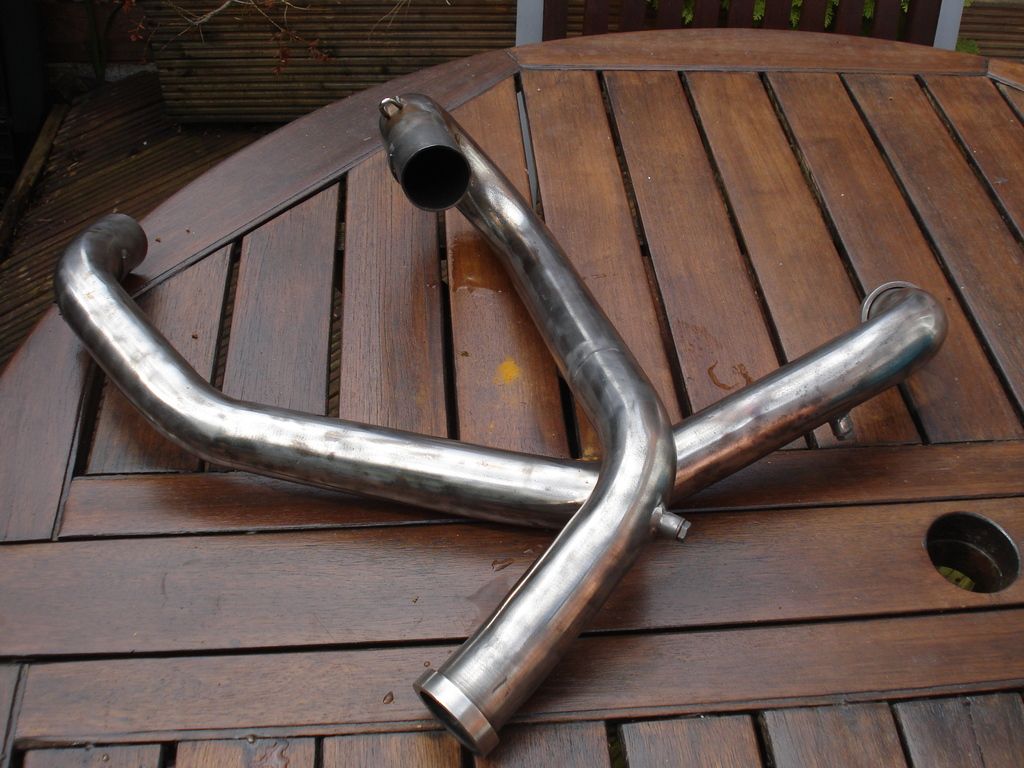

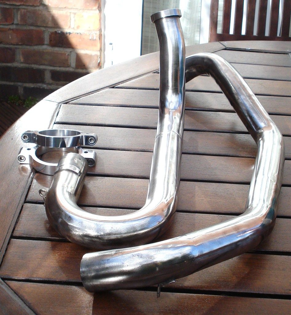

First up was the Exhaust front and rear headers.which have stood up well from their last polish some 6 years ago....Was thinking about ceram coating them...but I still prefer polished SS look....and despite what ceramcoat say...their coating does need polishing from time to time...albeit less work than what I'm about to undertake....

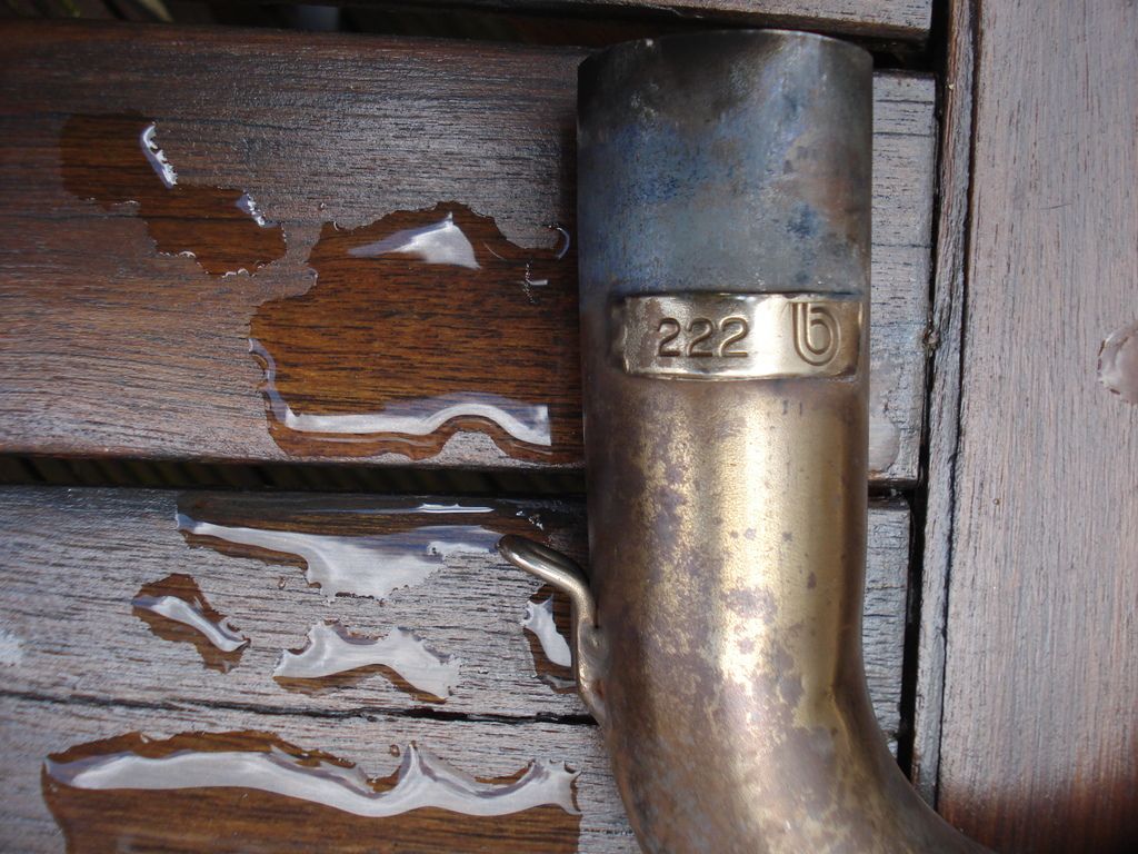

Old headers prior to any work:-

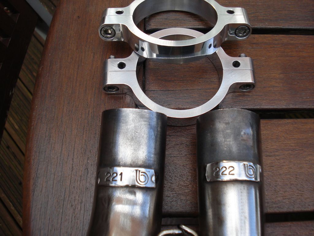

Bimota welds numbered tags onto each header so that they match with the follow on link pipes...evidently showing each one was hand made...and lengths/bends may vary otherwise....the top of the tabs indicates where the next piece pushes down to....so you dont need to polish this part as its not seen...
First and 2nd pass of the process...evidently one on the left is "after"...RHS not touched yet
Both sets part way through
getting closer...just one step left
and heres the final items after being hand finished with fine wire wool...
You can also use powdered lime (the white limestone stuff..not the stuff that grows on trees) to clean off any burnt on wax...and it cleans good also...just dont get it in your eyes...or mouth or up your nose...so protection always....
Its these puppies or GUARANTEED conjuctivitus before the morning comes...or worse still.... Embarassed

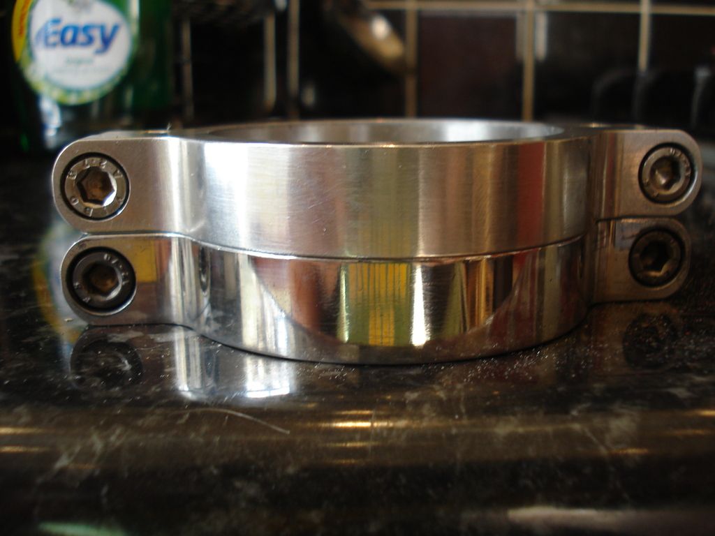

Also polished up the Front mudguard mounts...but only the last 2 steps are needed with ally....the first 2 steps are too aggressive
one part way through and other untouched
and now both fully done...and after solvol and fine wire wool again...

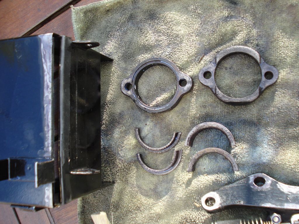

Thats the shiney stuff out of the way for now...so its onto solid steel/cast iron humdrum rusty stuff...

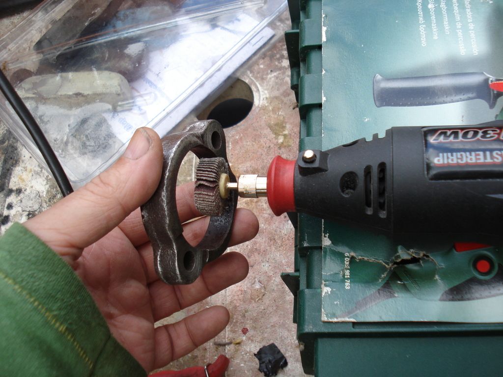

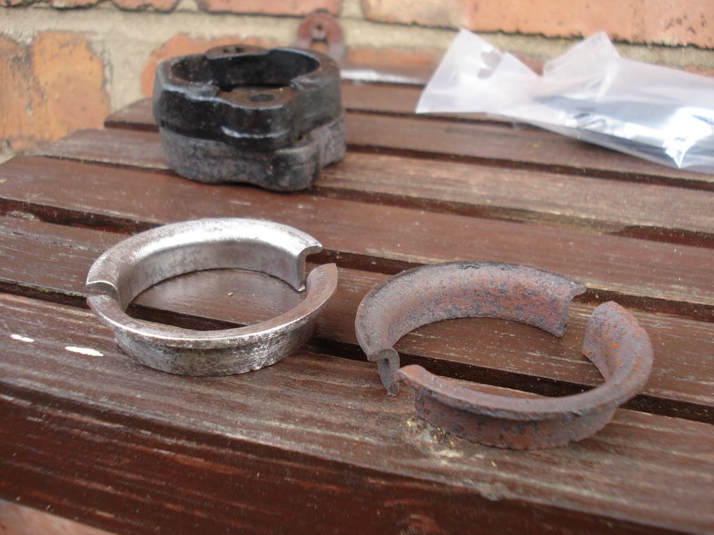

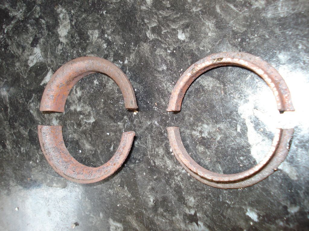

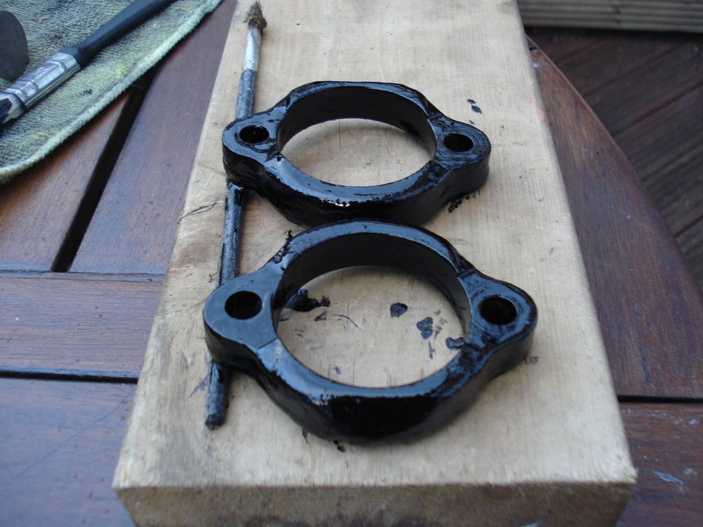

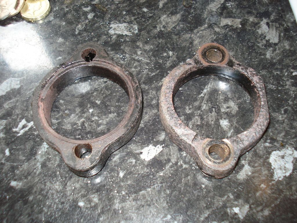

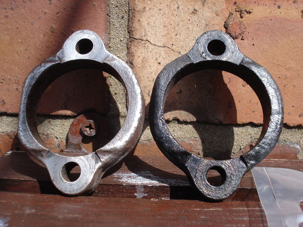

Exhaust header collars and half moon collats that hold them in place...
As straight off the bike:-
first stage of clean up..one done
Mini dremel again for inside collar

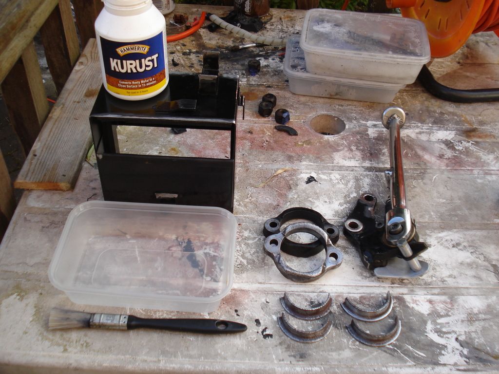

then its rust treatment time...turns rust back to metal (but grind off loose stuff first)
and then its high temp engine coat paint
Then its repeat the process for the collats

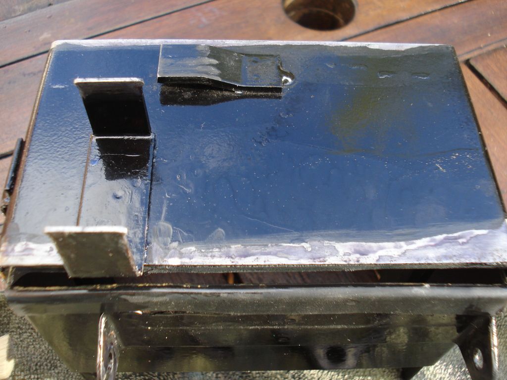

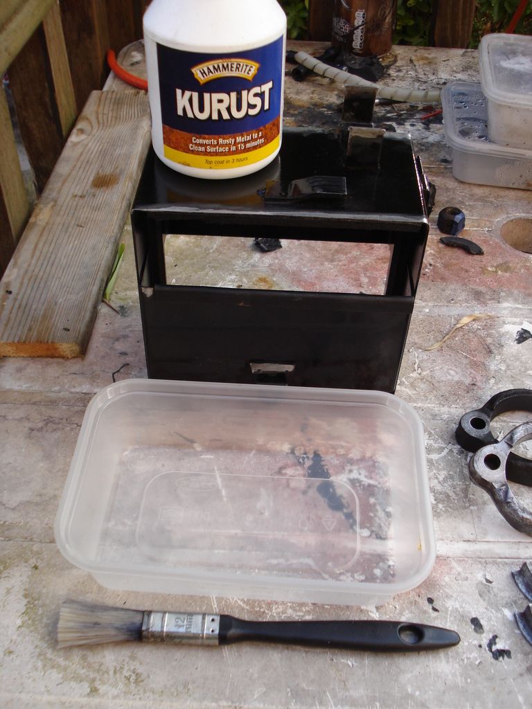

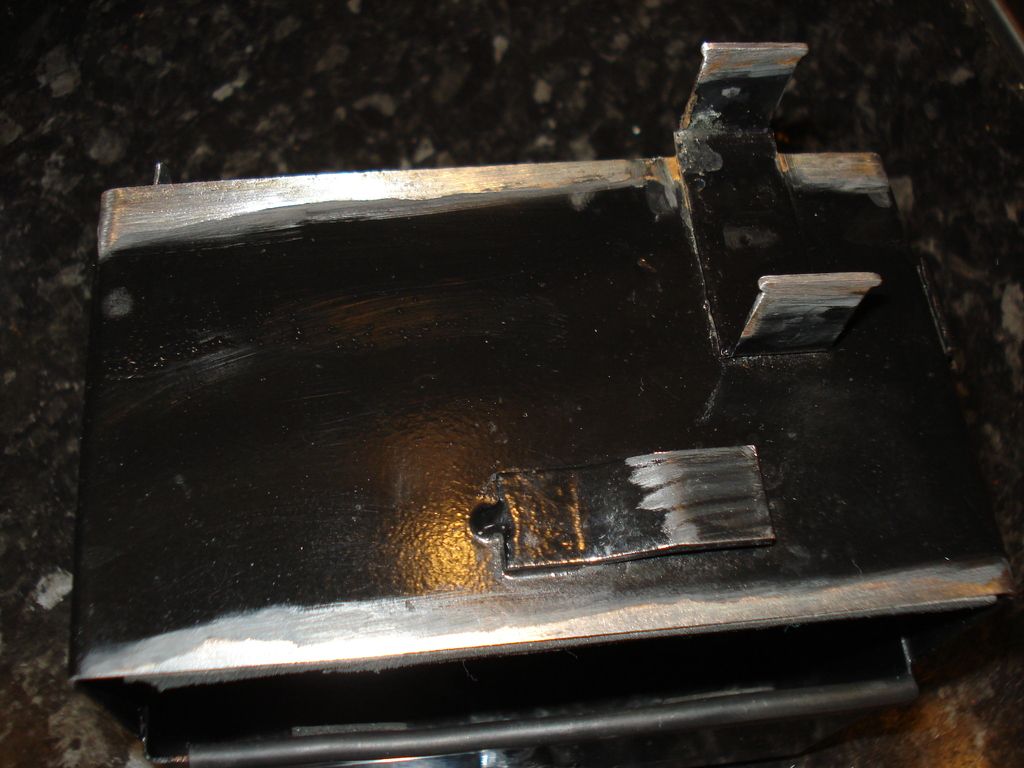

And then same again for the battery box that had some light flaking to a couple of edge and at the fixing points....
Battery box will be primed, top coated and lacquered by rattle can when the daytime temperature crawls above 10 degrees at least...I have done some before in the dining room but its amazing how much airbourne powder comes out...takes forever to clean...so I use a sheltered draft free space outside for painting with rattle can...

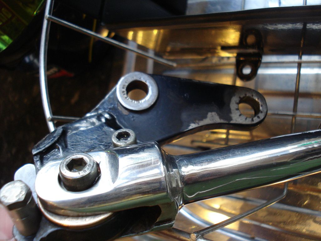

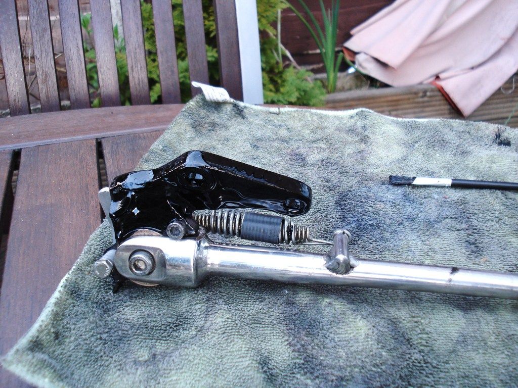

Sidestand same treatment...And I know I'll get slated here...as Bimota sidestands are notoriously heavier than the Titanic....and can often help a bike go down like the very same ship due to wrong lengths/angles etc etc....but the finish and depth of the chroming on the sidestands is beyond reproach.....This things 22 years old and taken the weight of my bike and kicks from my boots over many periods....and really all it needs is a wipedown with a wet rag....Perhaps Bimotas knew that their bikes would still be around in 20/30/40 years time...so at least built the sidestands to last that long...afterll it is the only thing that (most of the time0 keeps your bike off the ground

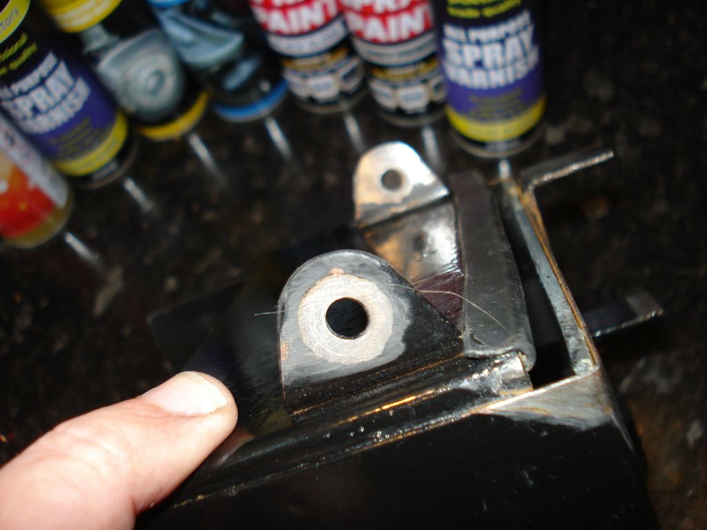

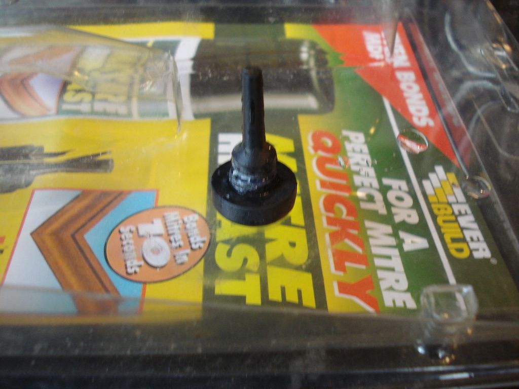

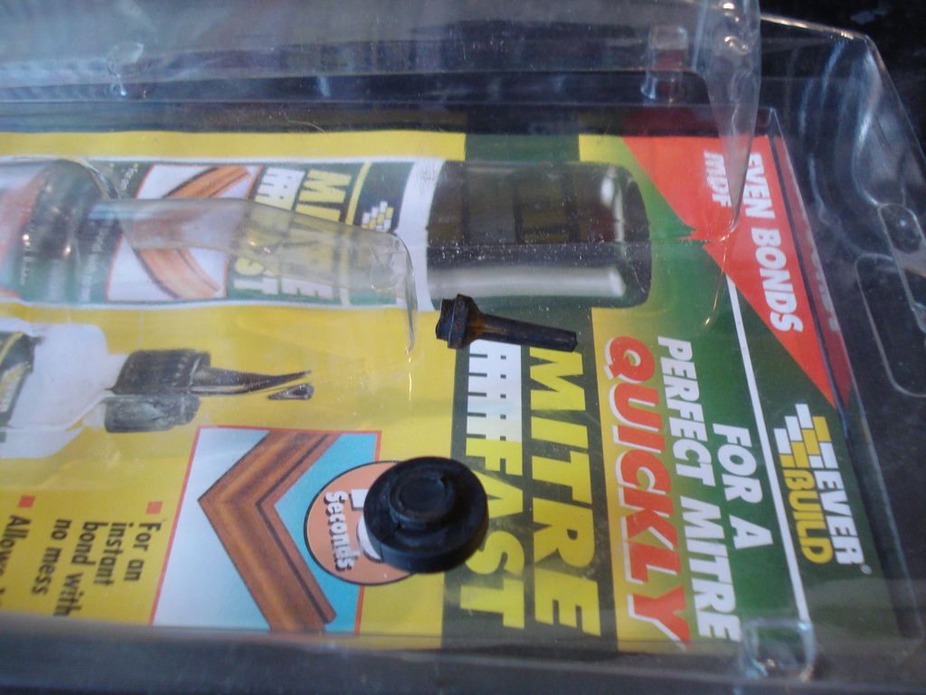

When I was removing the 3 No rubber plugs that the petrol tank sits on ...pushed into the frame....the first one I pulled out I was a little "brutal" and the plug part snapped off and stayed in the frame....I used a small pick to prise the other 2 out...fortunately the one that snapped off was the middle rail where the shock top mount bolts on...and there is a hole in that tube (the other tube for the 2 other mounts is flush welded at both ends)....Fortunately I managed to rattle it out...and superglue works wonders with rubber....
