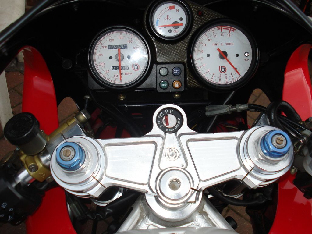

Not sure about the yb's, but my sb6 and db4 both have solid alluminium bars with rounded ends... All one piece. _________________ '99 DB4 #104, '96 SB6 #1165, '94 DB2 J #652, '99 DB4 #088, '08 VTX1800, '93 ZXR750R M1, '95 ZXR750, '95 ZXR750 Race Bike, '94 CBR400rr NC29 Race Bike, '94 CB250, '49 BSA C10 250, '61 BSA A10 650, '89 ZXR750, '91 Ducati 851 |

Maybe a bit late...but further confirmation....standard braided lines, gold series clutch master and standard banjos.....cantered back at around 15 degrees and it clears the clocks (if your YB11 has these clocks...2 types fitted...these are the earlier ones)
Oh and yeh...as others...clip on bars are solid alloy...so bar end is part of bar...it being the end bit....you could always chop part off and drill and thread an insert f you wanted to fit "proper" bar ends......my addage though is if it aint broke, dont fix it |

I have a later clocks but no braided lines. When the wheel turned to the right clutch line connector/fitting is touching my dash.
From pictures I gather that fittings ha e 15 degrees and pointing down. I would have to try to install clutch line fitting horizontally so it would pass right over the dashboard
