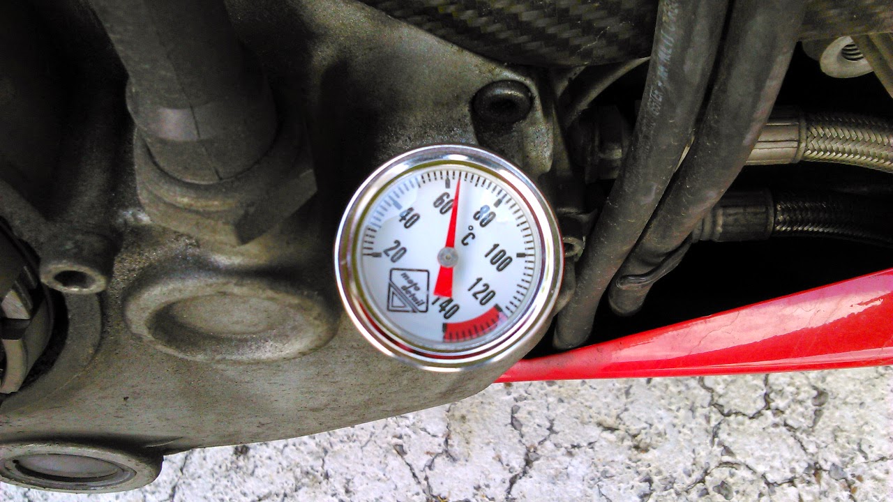

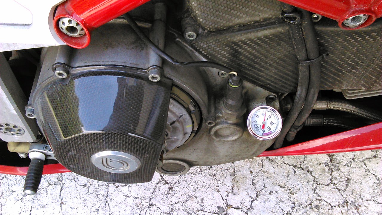

I found that I needed an oil temperature gauge on the DB5R. Only because I just want to know what the oil temp is.
At the pictures you can see how I did it.
I made a carbon bracket.
The location where I have placed the sensor.
Works perfectly..

Very neat job, looks excellent!

Hi Steve, You have eye for details. Laughing
The time was a bit off, I had disconnected the battery for the winter.
The toggle switch is for the headlight. That way I can switch the light off when I start the bike. Normally when I push the starter button the headlight is immediately on, and because it isn’t a bike that will start easy so I think all the power from the battery should go to the starter.
Since I have the switch and a new lithium battery I don’t have any starting problems.
The kit is with the brass thermistor. Only the plug I adapted so that the thermistor is threaded into the plug.
Answer to Your last question, No …… But …. It’s possible to have a second thermistor so you can switch between them.

Great job Vince! Have you done some tests already? I'm interested about the top temperatures... Which oil do you use?
Thanks.
I have taken her for a few short rides. The temperature of the oil was at max 95 ͦC (city traffic), only the ambient temperature was not very high (max 17 ͦC from memory).
I'll keep you updated (If you remind me).
I use 10W40 semi synthetic .
vince
Vince thanks for info!
