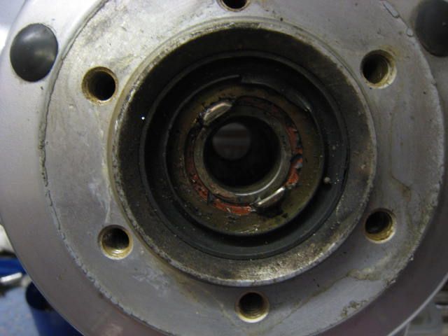

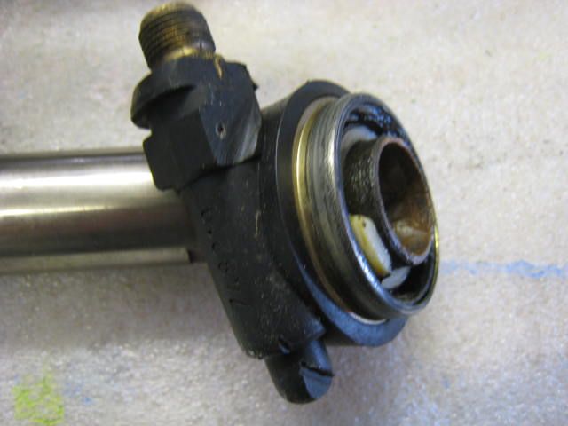

Hey Phil. Could you do me a favour. I am changing the wheels on my SB6 from the Oscom set up to the later Antera type set up , disc's , wider hub etc.
Could you take a picture of the drive dogs in the front wheel and the speedo drive , also any numbers on the speedo drive, and dimensions would be good.
Either dymag supplied wheels wrong or the speedo drive is not a 900ss like if thought.
Thanks

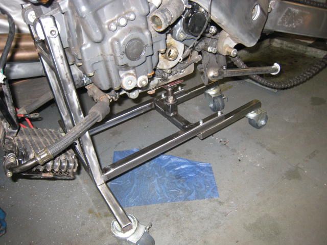

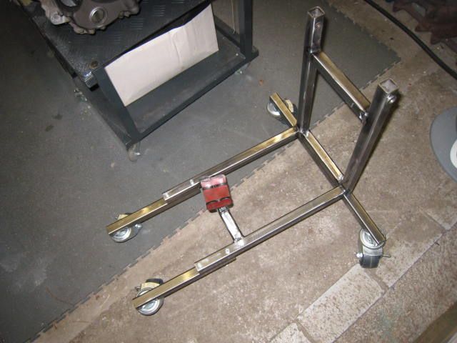

I quite like the idea of your stand Phil. Nice Exclamation
Thanks

No not putting antera on, got dymags, just went for the wider antera hub set up which means I need to change speedo drive and the 900ss set up I thought it was does not seem right. But have nothing to compare it to.

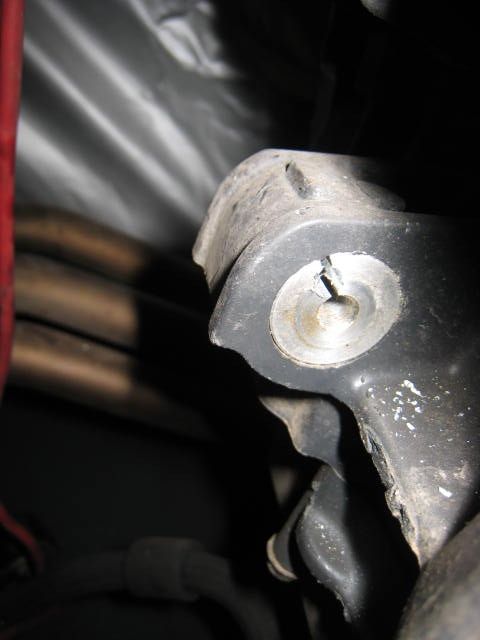

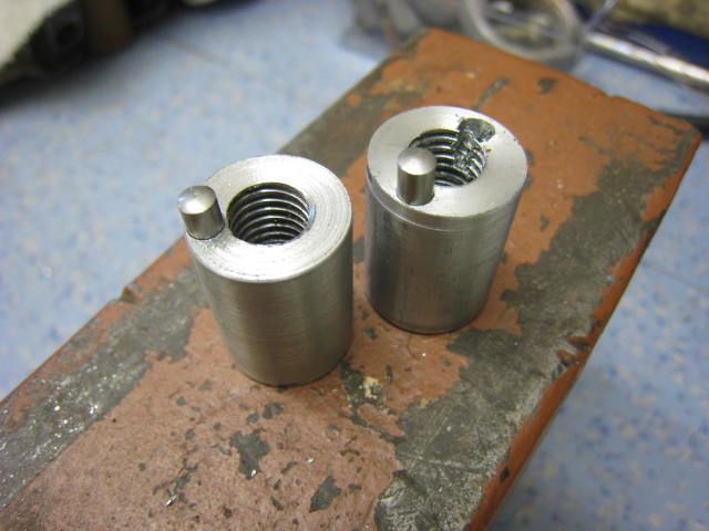

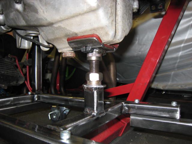

the stand works great, had to make some little alloy inserts, there's a 4mm dowel pin on the back, had to drill out the groove in the front engine mounts [I guess that's what they are in the engines usual location- GSXR] to accept this, required to stop the insert rotating when screwing the bolts in/out. As you can see I screwed up on one hole, trying to get an M4 dowel in a 4.3 mm wall is tricky, should have used the pillar drill really!
So stand is super stable, can haul the bike around the drive with one hand. Dead easy to remove the frame too

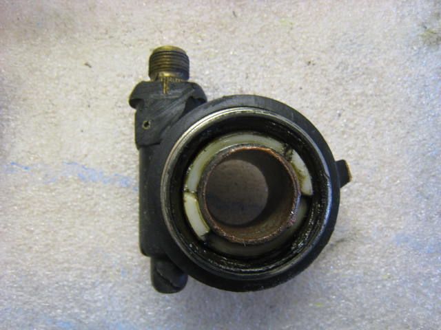

Vort- I called Oily about your issue, I bought one off him ages ago for the 851, his had been bored out to 20mm for an SB6 and I had to get it sleeved again for the 851. The pics are of mine now, you'll see where it's ground away, I'm pretty usre the one I had of Oily 3 years ago was ground back similar. Says CEK on it, 20mm bore
pics!

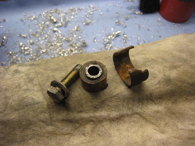

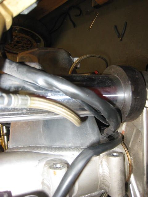

oh yes, 1st pic, the rear exhaust mount has failed, I'll make another and weld it on

Thanks for the speedo drive pic's Phil. Sort of confirms what I thought. Oily once had the same issue as me and ended up getting the early 900ss speedo drive and drilling it out to 20mm . Now I thought it would be easy to get a later 900ss 20mm drive, but guess what the 20mm spindle one is bigger in ever dimension also and can't find the CEV748219 one anywhere, so doing an Oily and boring out a 17mm one.

Loving the stand design.
I have an 1100 oil cooled motor stand that I think I will mod in this way.
