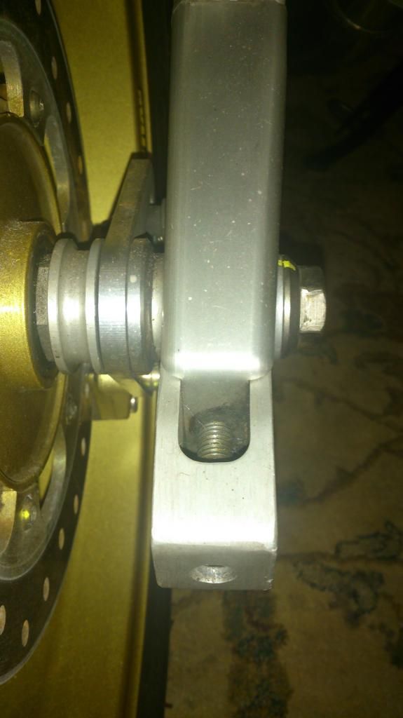

Seems that my RH chainadjuster have not yet passed the complete manufacturing process. Wink
Is it some kind of spacer between the LH chainadjuster and the chain wheel carrier ?
deebee4 wrote:
Confirmed...spacers are on the disc side......and the brake caliper bracket goes over it....the threaded insert is so that the wheel can be centered properly for chain alignment....either pulling in the swingarm...or pushing it out
Threaded part of the caliper bracket assembly goes in the RH chain adjuster and will stay there. Has to be tightened all the way. So when adjusting the chain the complete assembly will slide towards the front or to the rear. The hexagon part (the nut) will rest on the rear wheel bearing when the rear axle is tight.
So you might have to have the threads made in the RH chain slider.
Removing rear wheel means removing rear caliper only (hang it to the side). Chain wheel carrier and wheel will ease out when rear axle is removed. Brake caliper bracket will stay in place with the chain adjuster.
Warning: do not tighten the rear wheel axle with the specified torque of over 100 NM. That will quickly strip the threads in the LH chain slider. But it looks as if your LH adjuster has a steel thread insert while mine screws into the bare aluminium.....

A picture or confirmation by looking at actual DB4 would be very helpful.
I really do not trust the italien partlist or workshopmanuals being Bimota or Ducati.
I'll be home from work tonight so can check my stock db4 and answer some of your questions tomorrow. I'll post some pics for you if you like.
From memory the engine spacers are on the right side
deebee4 wrote:
Nope, the spacers go on the LH side. See spare parts list picture 17 item nr 15.
Monster 1100 -96 for the road / 1100SS for the track / DB4 new track project

PostPosted: Tue Dec 30, 2014 3:25 pm    Post subject: Reply with quote
Before I posted that the spacers were on the LH side I checked it on my db4. The bike is always inside the garage in my house. 10 meters from my bedroom. Now you know where I spend the night when I can't catch the sleep and don't want to disturb the misses.... Wink

PostPosted: Tue Dec 30, 2014 5:34 pm    Post subject: Reply with quote
It looks like in one of your photos that you have the rear caliper hanging bracket also...made of 8mm think plate....here are some pictures of the DB4 rear end.....and a few measurements
It all comes down to what rear wheel you are going to use....the sprocket cush drive...and size of rear disc...standard Bimota Antera wheels have a 230mm diameter rear disc that works with that caliper bracket....I think you are missing another spacer for the right side disc side......the left side sprocket side has another spacer that push fits into the pair of bearings that fit inside the cush drive assembly....and then presses on the outer race bearing surface...to be clamped tight against the chain adjuster.....

PostPosted: Tue Dec 30, 2014 7:41 pm    Post subject: Reply with quote
Looks like your rear caliper bracket assembly is complete except for the correct chain adjuster.
It consist of 3 parts: the collar that fits tightly over the threaded bush (with hexagon on the other end), the bush and - sandwiched in between - the actual caliper holding plate.
You might be able to have the correct thread cut into the inner side of the RH chain adjuster. Is is a "detachable" bush? That should do the trick, provided it has the right dimensions.
On the other hand: when you cut off the threaded part from the bush and just stack everything (chain wheel carrier, wheel and caliper bush&bracket) on the rear axle it shouldn't be a problem too and you even can remove the rear wheel without the need of taking the rear caliper off its bracket.
Just make sure the wheel alignment is spot on when shimming everything up. That will improve handling characteristics.
If you want to I can measure it up after I've taken the wheel out this weekend
http://hexengineering.se/wp-content/uploads/2014/12/DB4_rearcaliperspacer_b.jpg

PostPosted: Tue Dec 30, 2014 10:33 pm    Post subject: Reply with quote
I will try to do it as original as it goes, not to mess it up to much.
So if you have the spacer on the left side of the engine so will I.
Same with the caliper bracket spacer. Just a matter to thread the chainadjuster
With M25 threads.
But it really all depends on how my rear mag wheel will fit.
