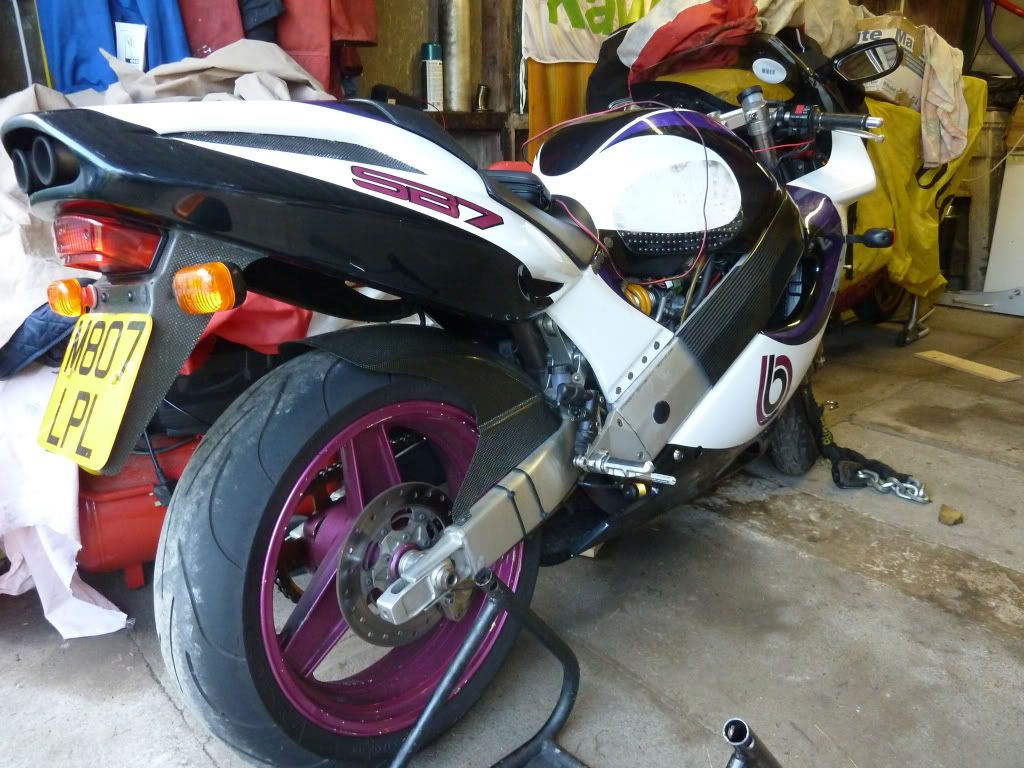

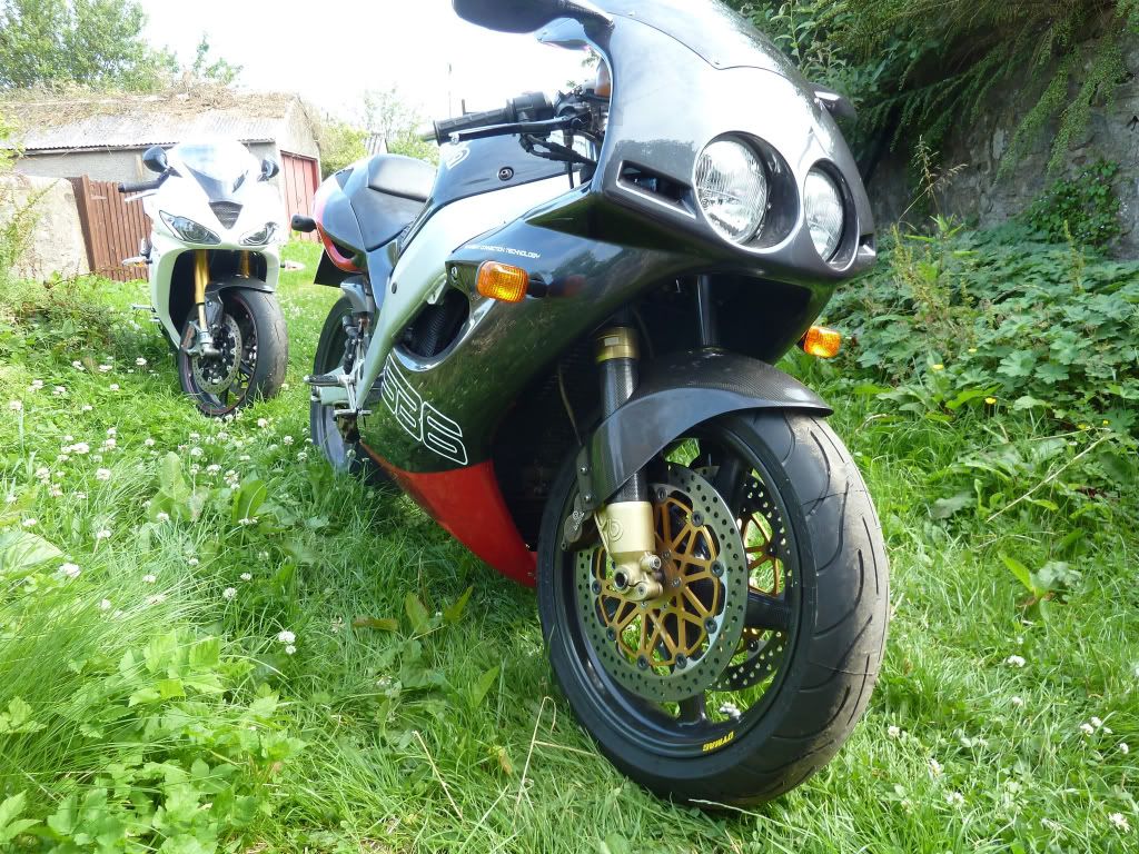

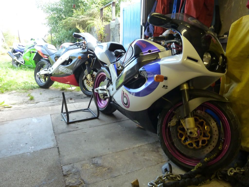

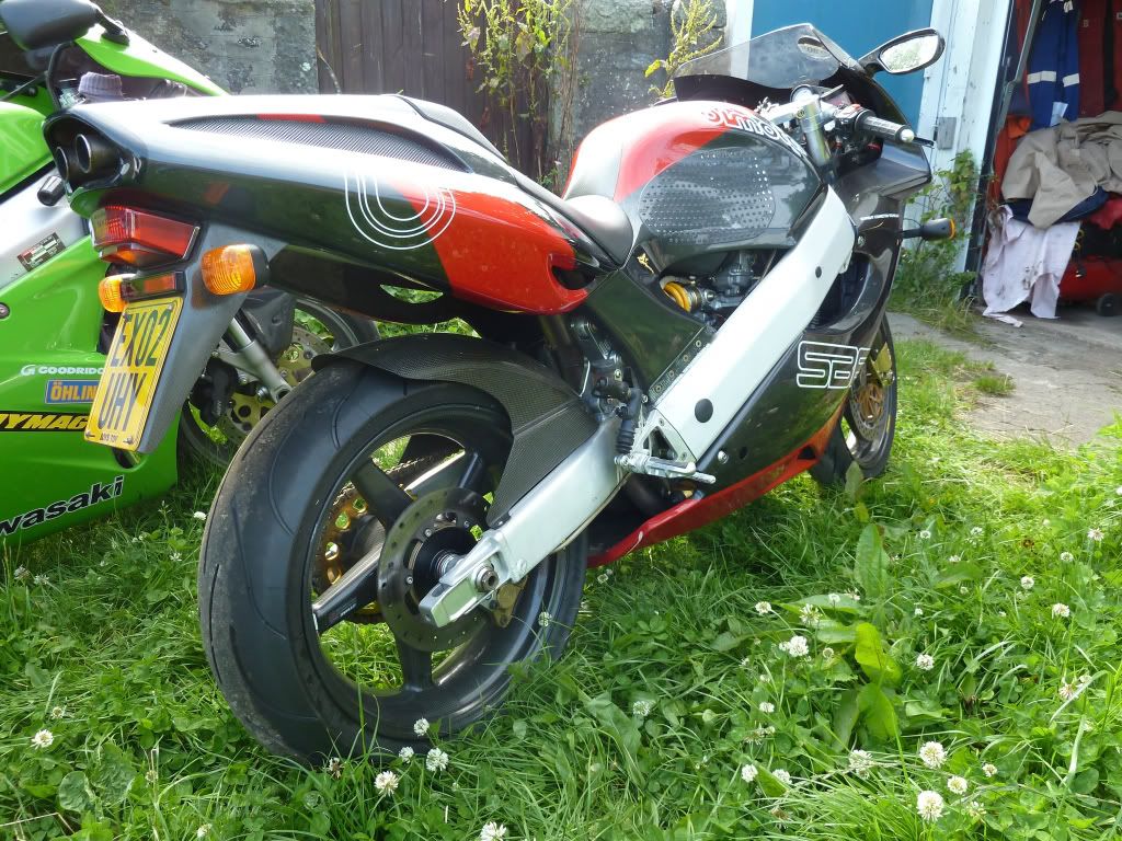

				|  Posted: Sun Aug 12, 2012 7:30 pm    Post subject: |   |
				| Some more photos:
 tried the long bolts for the engine vibes - but no luck perhaps I have the metal mounts?
 Cheers.
 Bob.

				|  Posted: Mon Aug 13, 2012 12:34 pm    Post subject: |   |
	  | bob wrote: |
	  | Some more photos:
 Cheers.
 Bob.
 No, that's definitely a Mk11 bob and the mount plates are totally different and not interchangeable
 ...There is definitely a spot in my garage for that SB7 so hurry up and decide you want rid of it.......
 Oh yeah...your grass needs cutting

				|  Posted: Mon Aug 13, 2012 7:43 pm    Post subject: |   |
				| Nice colour the SB6 and looks good with those wheels.
 For cutting the grass you have already a lawn mower I see….a green one asaki or something like that.
 vince
