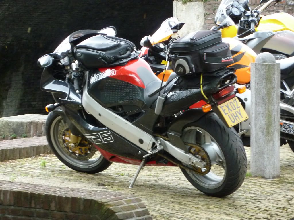

				| Photos - hopefully!

		| oily
				|  Posted: Sat Aug 11, 2012 6:18 pm    Post subject: |   |
				| Lovin the SB7 bob   When you've finished playing with it, just pop it down to the midlands and I'll take it off your hands
 That's a late registered SB6
   Glad to see your not frightened to use it
		| Back to top |  |
		| bob
 Joined: 09 Jul 2010
 Posts: 31
 Location: Aberdeen
				|  Posted: Sat Aug 11, 2012 6:38 pm    Post subject: |   |
				| Don't think I could afford the oil to get it all the way down there!!!!
 Still hopefully have that fixed soon thanks to the Forum.
 The sb6 has now got carbon dymags fitted - but I don't seem to have any photos of them and the bike is at the back of the garage - probably laid up for winter now!!!!
 Cheers. Bob.
