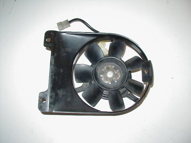

Thanks for your reply, appreciated. Luckily I don't need a rad yet. I did suspect it wouldn't be that simple. What I need just now is a fan, which I never had with the bike. I was hoping, if the rad could be identified, that would lead me to the right fan. I am going to try one off an early FZR 750 which looks like it might fit though.

I'm pretty sure this is the same as the fan on my YB4
ebay: 300639727711
but you're right, you can probably get anything to fit with a couple of brackets.

Thanks for getting back. You are right, it certainly is the one. Originally off an FZR 750, circa '89. Item was fitted to other bikes too.
I bought one off ebay,gwo . The only thing I had to do was cut off the bottom mount and weld it back 180, so that the bolt hole is outside the shroud. I'm sure that would have been what Bimota did.
