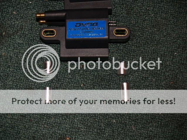

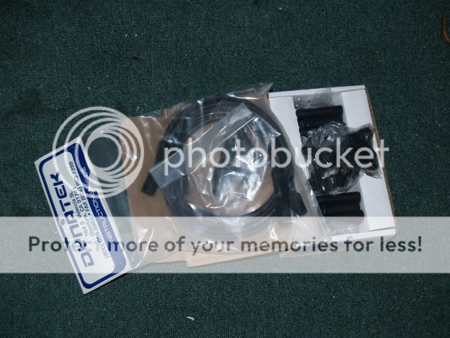

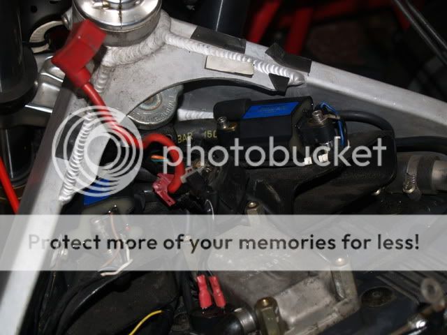

And here they are......

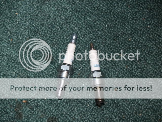

Got to fit the plug nuts to the new plugs. The plug manufacturers don't seem to supply them with the plugs these days but never fear......A set is supplied with the new leads...............

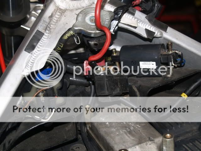

measure up the new coils compared to Suzuki San's and I've had to turn down the support spacers
One new coil one old coil......

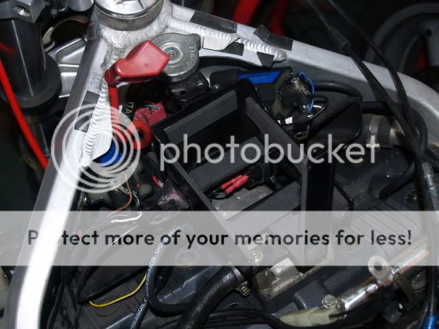

Both new coils in place.....these mini coils are about the same size as Suzuki's coils.....I would never have got a pair of the big old green Dyna coils in here.....
Fiddling about with the awkward bolts that hold the battery box on.....

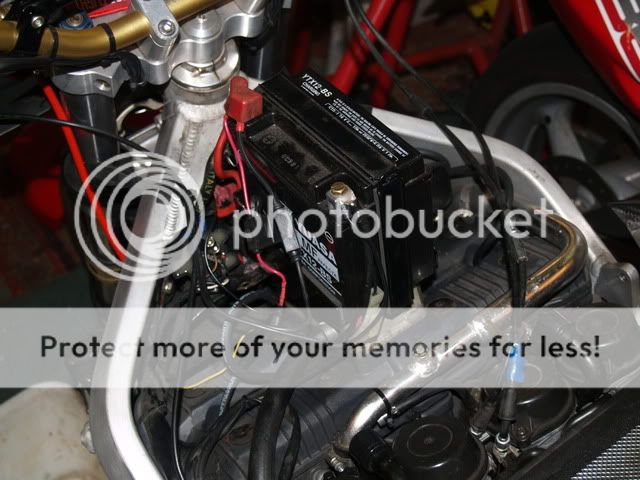

Battery back on and all connected up...............................................

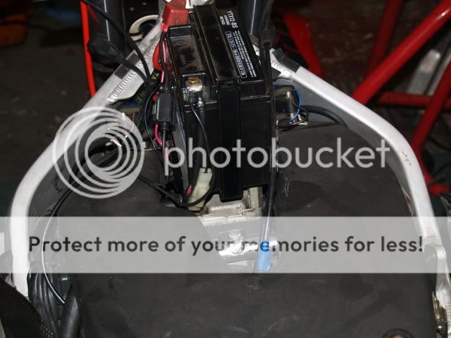

Air-box lid/ram air scoops back on and all that leaves is.....................
.........The bodywork to replace and a test ride. The roads have dried up a tad so there's no time like the present

Quick footnote on the DYNATEK MINI COILS, unlike the lardy old green coils, the mini series are polarity conscious and the +ve terminal is marked with a red dot. You can just make it out in some of the pictures  |
