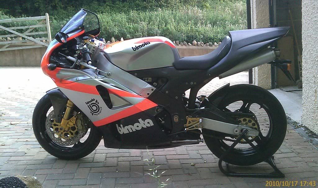

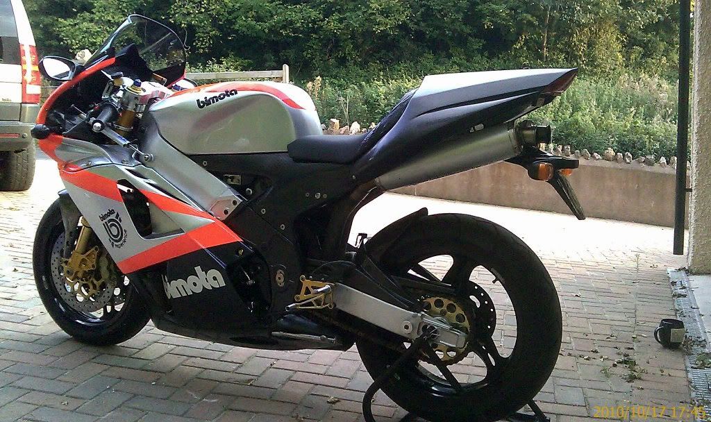

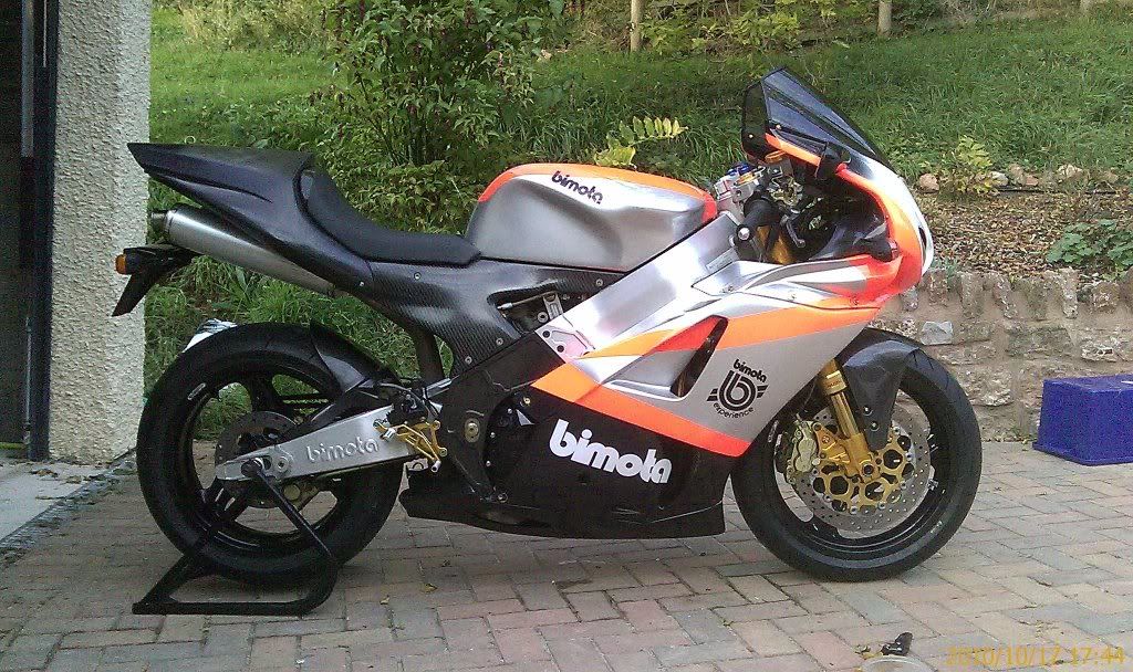

Please see some more pix of the almost finished Gobert LE.
The rear end fairing is now polished raw carbon fibre and the number plate is the genuine carbon item...both items provided thanks to Ezio Rosboch at Rosmoto who supplied everything for the rebuild.
Left side....
Right side...
Left Rear
Only a few more things to do now...then VIC test and it should be back on the road... |
