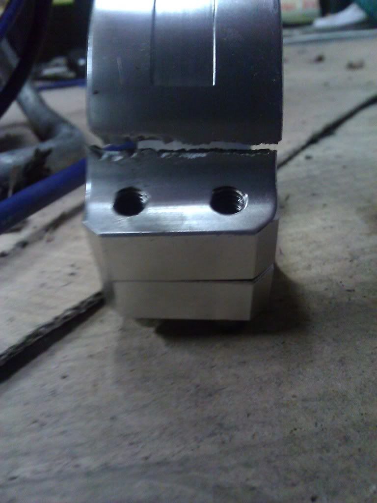

A handlebar clamp on my SB8K fractured for some reason. Think someone walloped it just right going past the bike or sommat

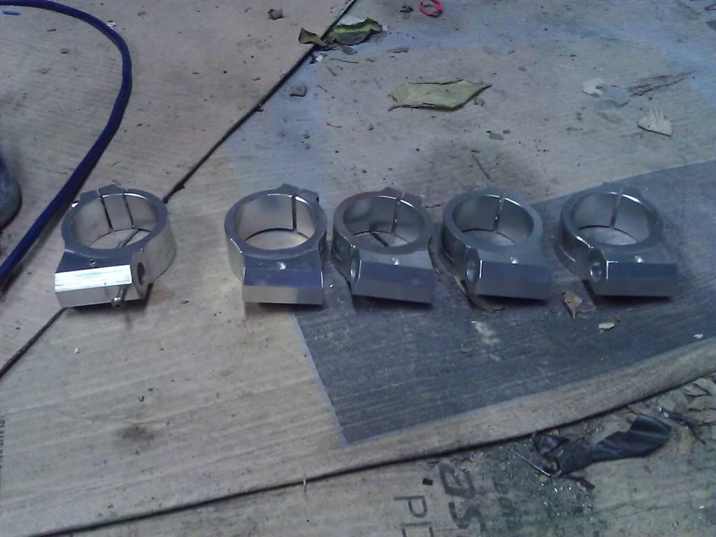

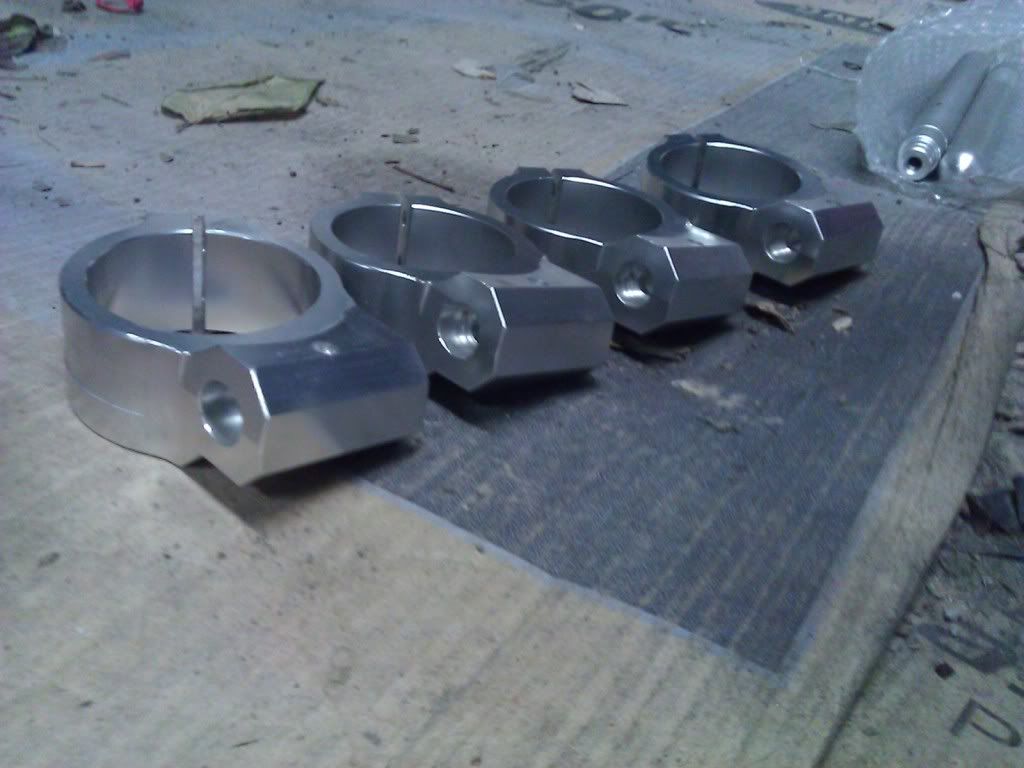

Well I thought it would be an easy fix as I have 4 spare handlebar clamps!!..............
Then I looked more closely and found that they are all spares for the left hand side the broken clamp is on the right hand side.
The clamps are different and can;t be just turned upside down or something...as you can see from the picture below!

Was parked up, med-high camber street, 90 degrees to camber, back wheel on curb.
Glad bike did not get knocked over and pleased it happened before I started riding
Thought that the clamping screws had mysteriously unscrewed, but after tightening the allen screws to no great result, finally realised the clamp was actually broken!!
My theory is it got winged by someone trying to reverse into the car parking space???
It was a very cold day - could even have been contraction. |
Posted: Mon Jan 02, 2012 1:18 am Post subject: |
tough luck, sorry to hear it. But as you say it could have been a lot worse. looks like a tear apart rather then compression, maybe at some stage they had been over tighten screws and a stress fracture was just waiting to happen. Will keep an eye out, good luck. It may be easier to get it manufactured although no idea what the costs would be? _________________ Pomps

Looking at the picture that would be my guess. overtightened and then contracted with the cold, something had to give
