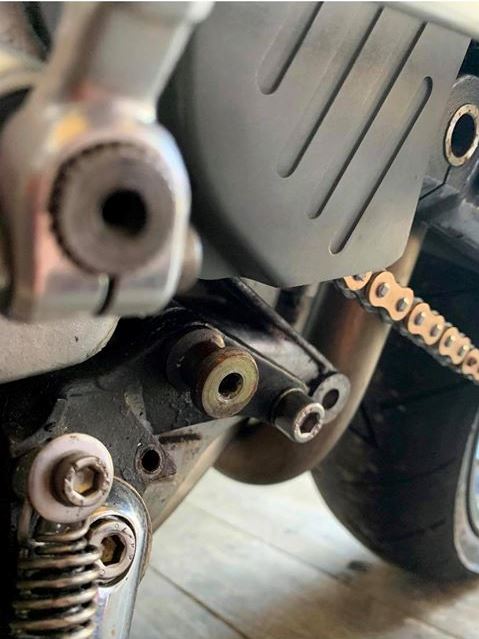

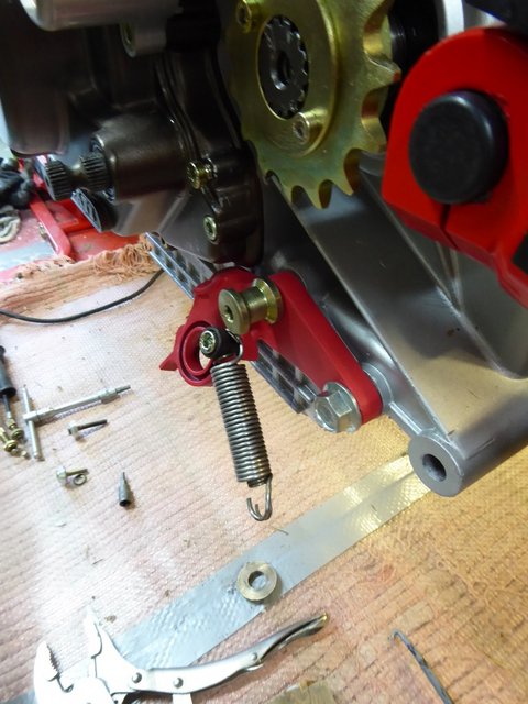

PostPosted: Wed Mar 23, 2022 7:06 pm    Post subject: Reply with quote
Here is a clearer photo of the OE spacer/mount on my rebuild bike.

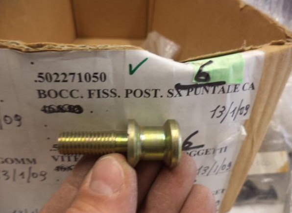

and this is the part itself
The main dimensions are
M8 thread 26mm long (incl 5mm undercut) (or M10? will check tomorrow and re-edit this post!)
The spool is 21mm long and 20mm diameter drilled and tapped M6 with a broached hex opening 6mm deep before the M6 thread starts.
The OE part is tapered into a 'cotton reel' which probably saves 3g in weight.
However if I was making one I would just machine a couple of flats to allow you to tighten it into the crankcase and then just drill and tap the central hole for the M6 fairing attachment capscrew.
