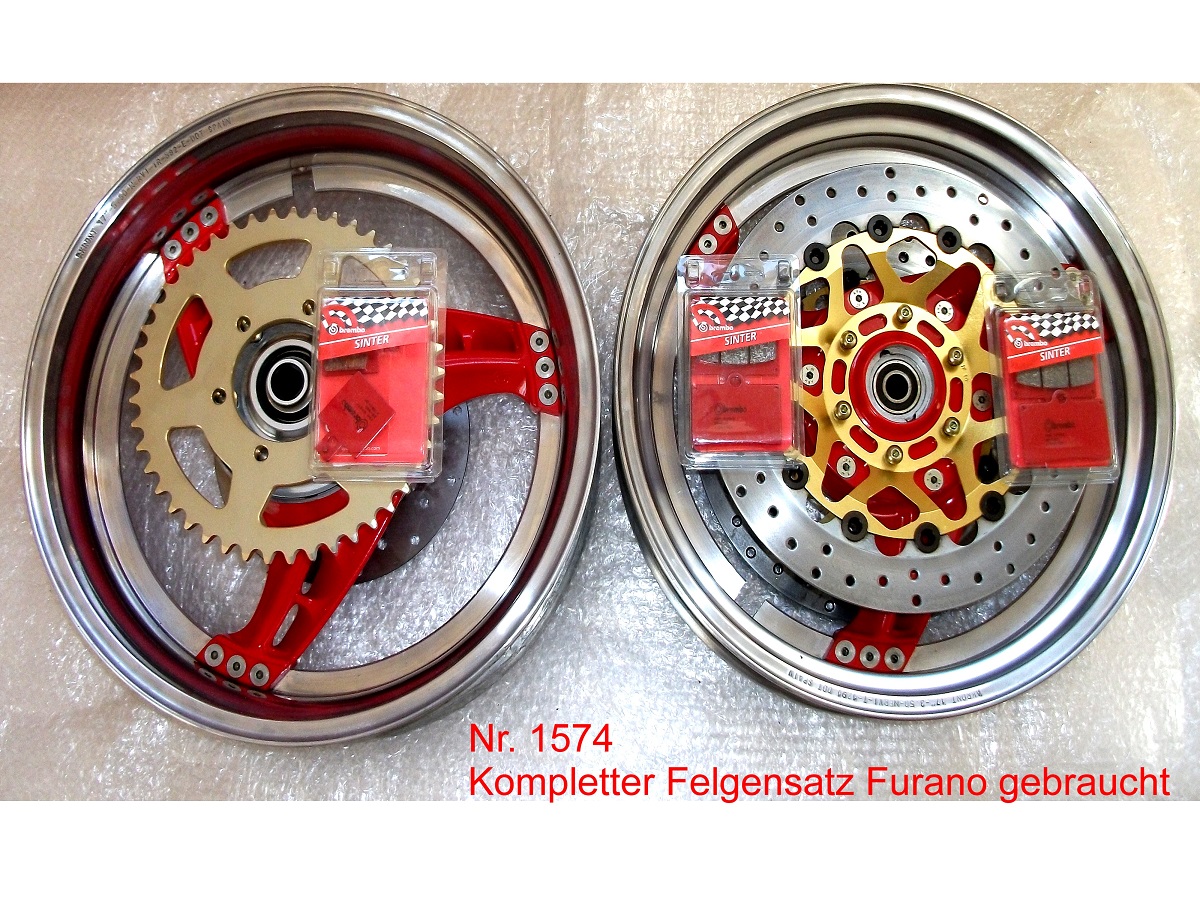

These would make nice hoops
http://www.bimota-parts.de/images/dscf3339.jpg
Pricey...but where else are you going to get one of these from???
