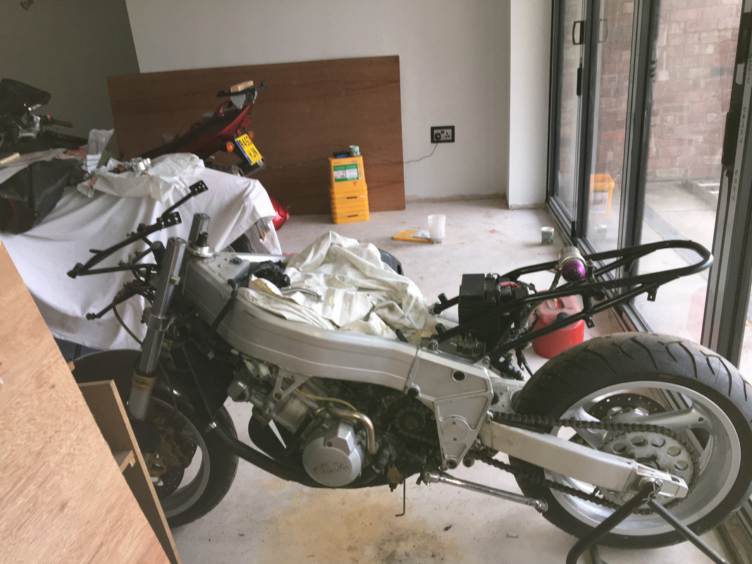

				 Posted: Fri Nov 27, 2020 8:26 pm    Post subject:  |
Stupid question time. I have taken some pictures but have no idea how to get them loaded on this site, any clues would be greatly appreciated _________________ Bimota YB9, RD500,Z1 1974,Z1 1975, Benelli 750sei, 900sei, GPZ 750 turbo, Rudge super sport, S.O.S, BSA Rkt 3 1969, 1966 Bonnie, Egli Vincent 1954,Guzzi 850T, Commando fastback, Commando Interstate, Enfield Interceptor 69, 72 H2, 69 H1, Suzy Gt750 J |

				 Posted: Sat Nov 28, 2020 12:03 am    Post subject:  |
				https://postimg.cc/4KK2zK1f
https://i.postimg.cc/g049b8XZ/57-BAA578-7-DE1-4297-B45-D-6-A5-EED22-A3-DE.jpg
[57-BAA578-7-DE1-4297-B45-D-6-A5-EED22-A3-DE.jpg](https://postimg.cc/4KK2zK1f)
[](https://postimg.cc/4KK2zK1f)
<a href="https://postimg.cc/4KK2zK1f" target="_blank"><img src="https://i.postimg.cc/4KK2zK1f/57-BAA578-7-DE1-4297-B45-D-6-A5-EED22-A3-DE.jpg" alt="57-BAA578-7-DE1-4297-B45-D-6-A5-EED22-A3-DE"/></a>
<a href="https://postimg.cc/4KK2zK1f" target="_blank"><img src="https://i.postimg.cc/g049b8XZ/57-BAA578-7-DE1-4297-B45-D-6-A5-EED22-A3-DE.jpg" alt="57-BAA578-7-DE1-4297-B45-D-6-A5-EED22-A3-DE"/></a> _________________ Bimota YB9, RD500,Z1 1974,Z1 1975, Benelli 750sei, 900sei, GPZ 750 turbo, Rudge super sport, S.O.S, BSA Rkt 3 1969, 1966 Bonnie, Egli Vincent 1954,Guzzi 850T, Commando fastback, Commando Interstate, Enfield Interceptor 69, 72 H2, 69 H1, Suzy Gt750 J
