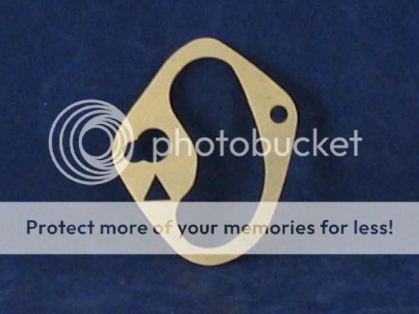

[img]Found this on the www.mdinaitalia.co.uk site, is this an equivalent to your anti-flick up sidestand plate 2Bims ?[/img] |
Posted: Tue Jul 05, 2016 11:20 pm Post subject: |
Hi Rich......found the part on MDINA parts site....for a 750/900ss.....sort of looks the same as fitted to those bikes.....but on those bikes the spring is infront of the side stand....plate fits to a bolt above the retaining bolt of the sidestand...and spring loops onto it and then the spring fits to a lug on the outside face of the sidestand...so its really just a replacement part for that bike and that sidestand.....On BImota DB2's the spring is on the back of the sidestand....so something different is needed to move the fixing part of the spring further forward...so that when the stand is pushed forward the pull direction of the spring changes to holding it open rather than auto always pulling back.....I can post piccies of what was done to mine if you like as I have it off the bike at the moment.....mine also had longer bolts put in and spacers behind the fixing plate to push the whole sidestand further out as I have recently found....(Didnt have a previous example to compare to previous...) |

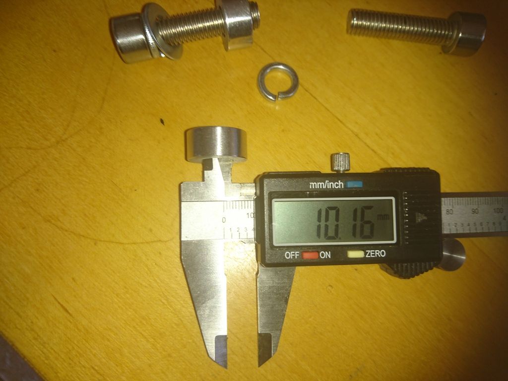

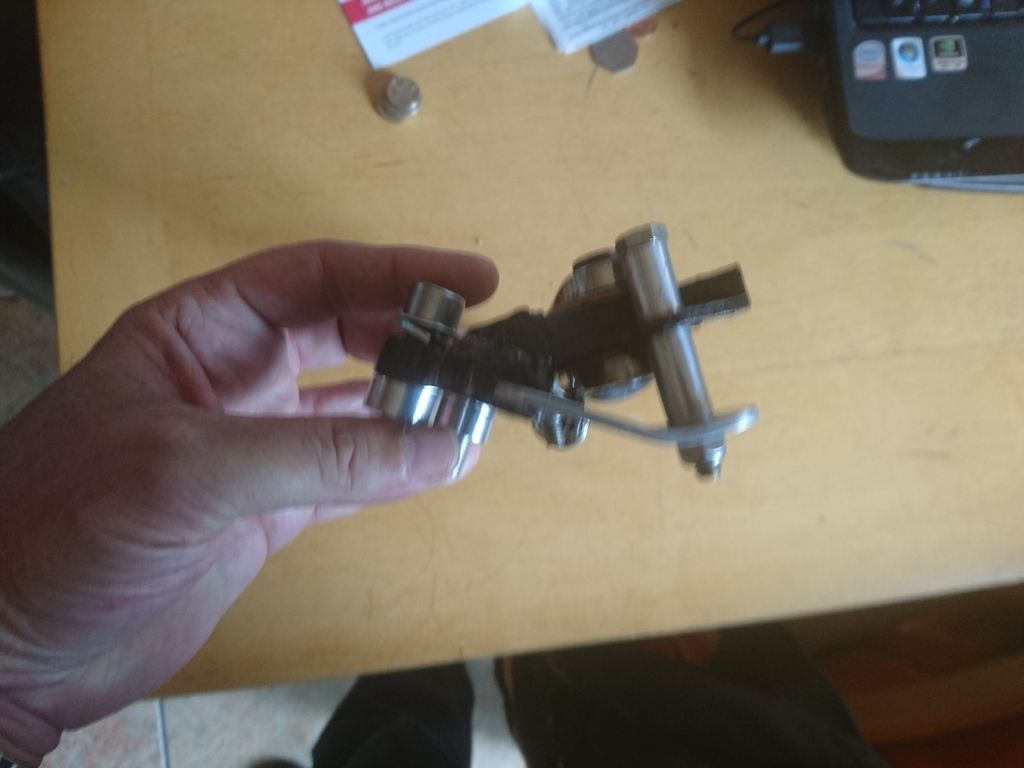

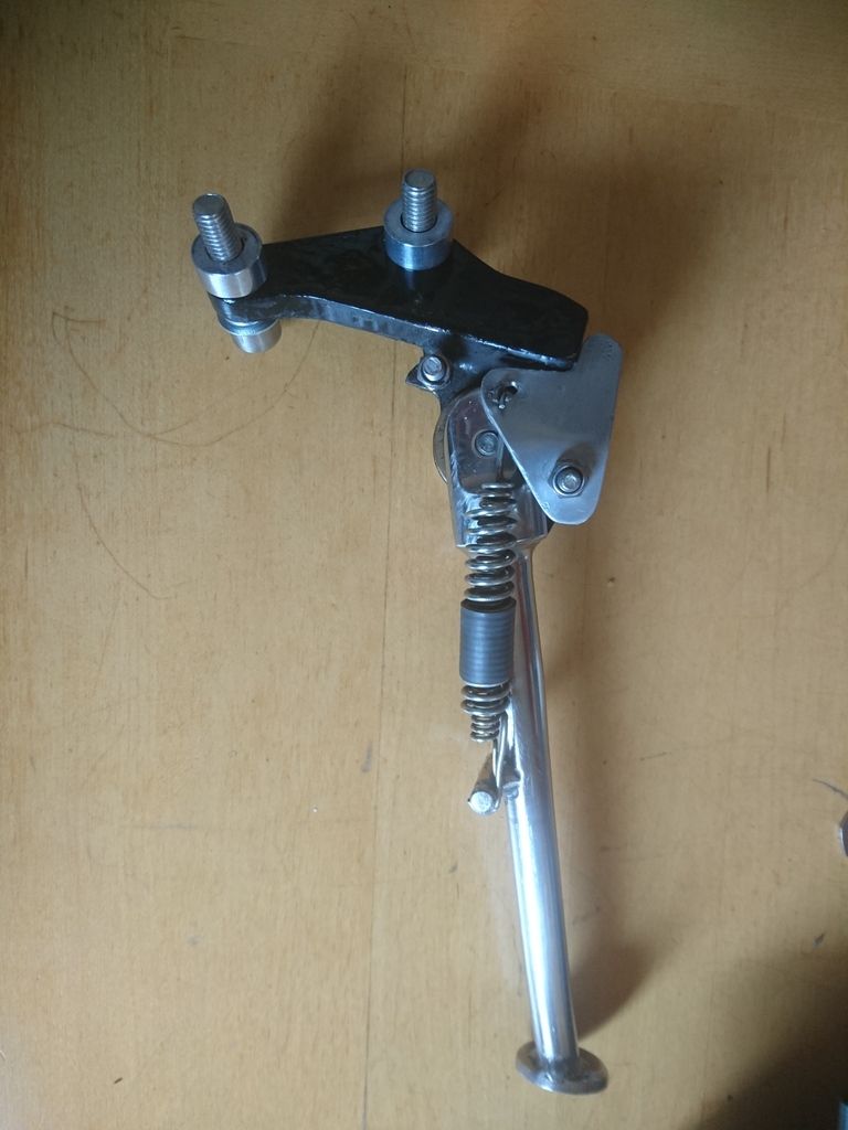

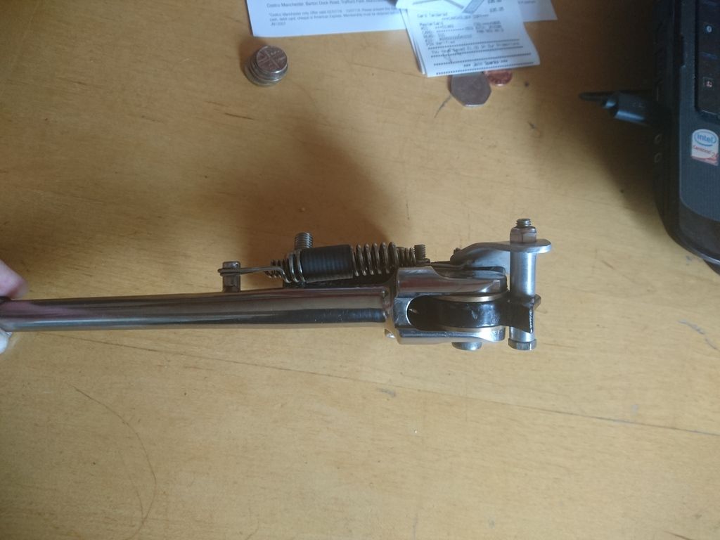

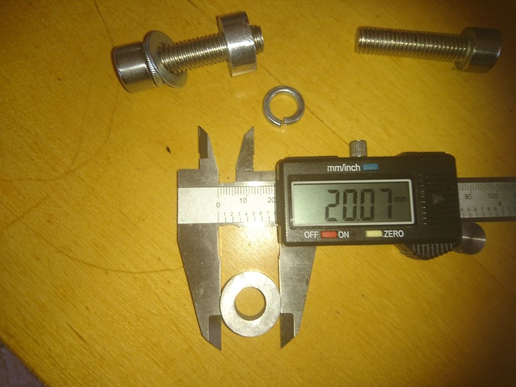

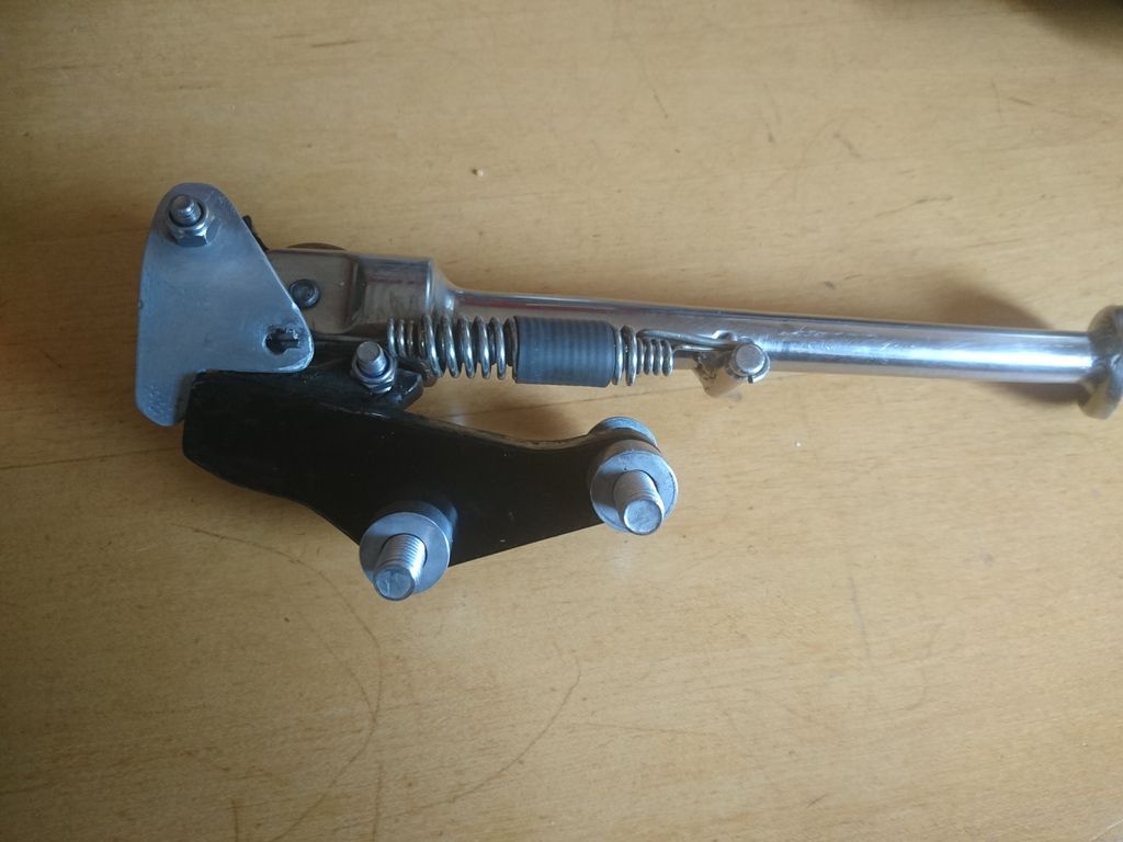

Posted: Thu Jul 07, 2016 10:44 am Post subject: |
The "New" longer bolts (2 No.) that screw into the crankcase LHS of the engine are M10x40mm (threaded length is 40mm)....and the spacers are ally 10mm thick, 20mm OD and 10mm ID....and I use a locking washer on the front face....so its locking washer, bolt through this and through the sidestand plate/bracket, then the 10mm thick ally spacer and into the engine casing.
Looking at it closer with it off the bike I can see that the back alloy tube spacers are there to allow the repositioned spring to "travel without hitting the engine casing....and that these spacers could in effect be just 5mm max really
Sidestand in "open" stand out position....held all by itself...as the spring has been relocated past its pulling point in one direction and into a pulling position in another direction to keep it open...
Sidestand in its closed position "up"...a simple tap with your left boot pushes it back to its closed position and retracts and stays up....
I'm assuming that the same original springs are used....and that the top spring fixing is simply being relocated some 20mm or so from the hole on the black steel plate onto the added ally plate 20mm or so further along to give it its "2-way" holding position....so that it can stay open or closed/retracted..

I didnt realise when I bought my DB2 that originally it would have had a suicide stand....only when I rode anothers DB2 at the Isle of Man did I know....I'll dig out another thread I put up somewhere where I dimensioned up the ally plate that I fabricated to make the mod for another person.....which is then held by the "spare" hole at the front of the sidestand where Ducati would have put a sidestand switch....the right angle on the plate holds it against the plate of the sidestand... |

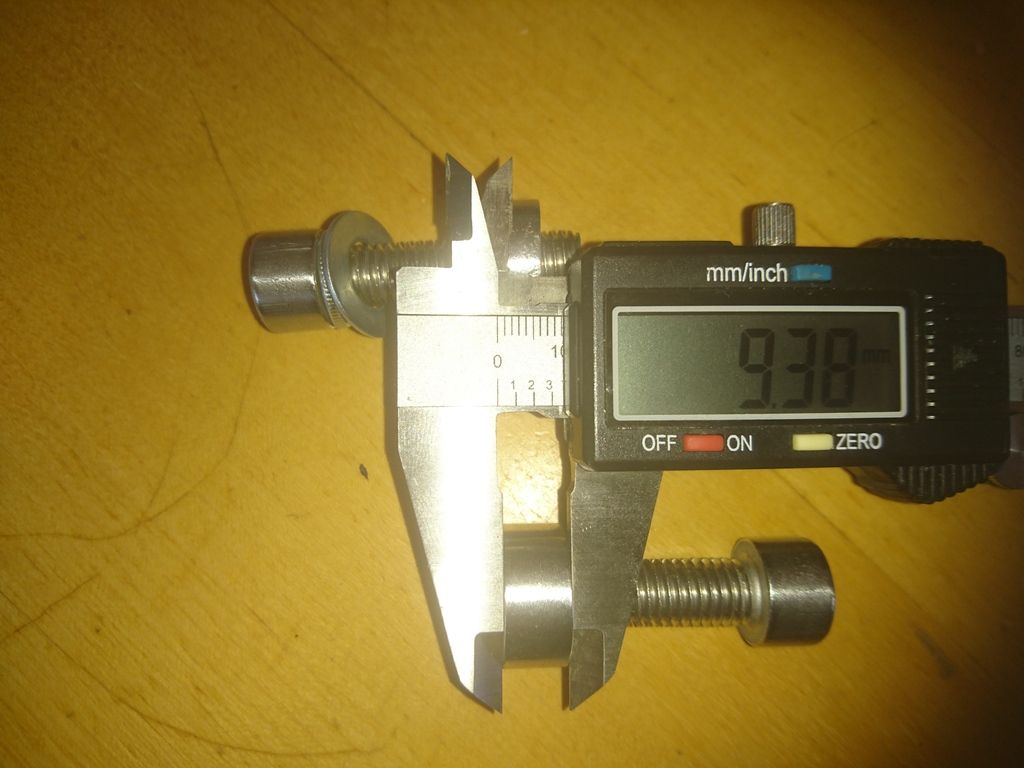

Hi Steve,
Thanks for the pics and explanation great stuff. Just one question, what are the sizes of the long spacers and the bolt on the one which attaches the ally plate to the steel plate the stand is pivoted from?, is the spacer on the front side a stop for the stand when fully out ?

Rich. |
That hole on the original sidetand is threaded....the bolt is an M6x50mm long bolt...and each of the spacers are 10mm OD and 15mm long at the front and 20mm long at the back.....spacers not a necessity...you could just use a further couple of nuts to lock it either side of the sidestand main plate...and one each again either side of the ally additional plate....the front part extension for me is a bit of engineering overkill...it just means you can locate a spanner on it to check and keep tight the nut on the bottom of the bolt under the alloy fabbed bracket...but if you used an allen headed bolt you can forget the "extension" long bolt and just use a M6x30 bolt with the lock nut behind the black steel original plate and a further 2 nuts either side of the alloy plate beneath that...that would do its job....as the extended length on the front face isnt a stop for the stand when fully out....the stand still stops in its original suicide stand position.....and hold there as the relocated spring now works in a different direction as the opening of the stand has pulled the spring past the pivot point of the stand...keeping it open....and with safety of a good 15-20 degrees of movement back before it auto retracts back.....a video may be the best way of showing you its action...so I'll see what I can do...maybe eve with a commentary.....a simple solution when you see it in action...although I take no credit for coming up with the mod to make it work.... |
