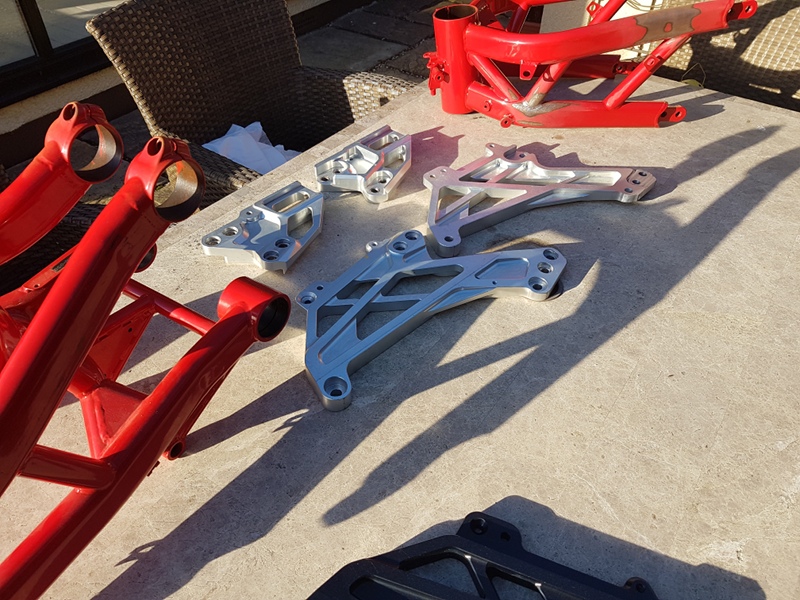

a contact found a frame for sale.....a factory 2008 DB7 frame
and swing arm with no frame markings, RED and self induced
rust marks, although the swing arm was stamped and marked as it
should be...although it had a relieved welded section near the shock absorber.
There was nothing wrong with any of the items...
they had not been down the road or the subject of a crash
for example BUT looked like someone had tried to 'age' them or 'devalue' them.....who can tell or knows.
The alloy CNC frame side plates were supplied in Silver but also a set in Black...

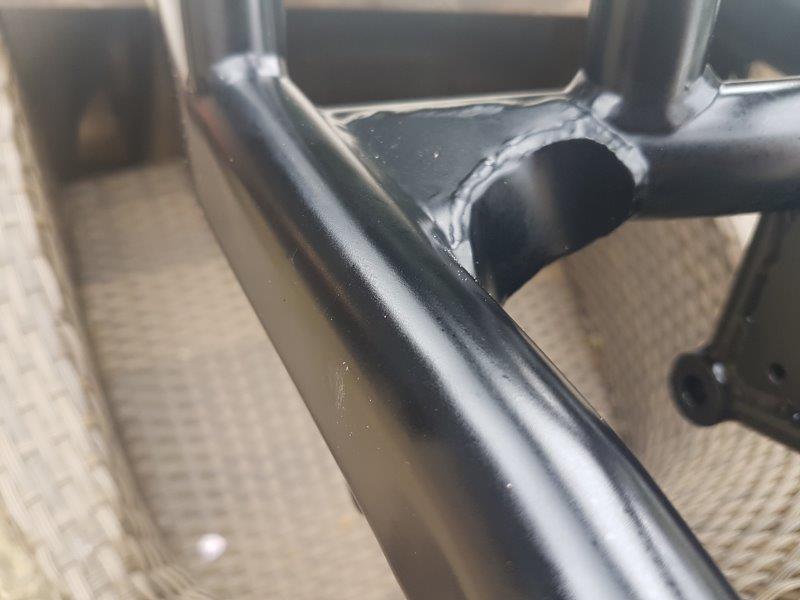

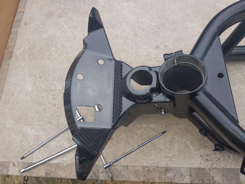

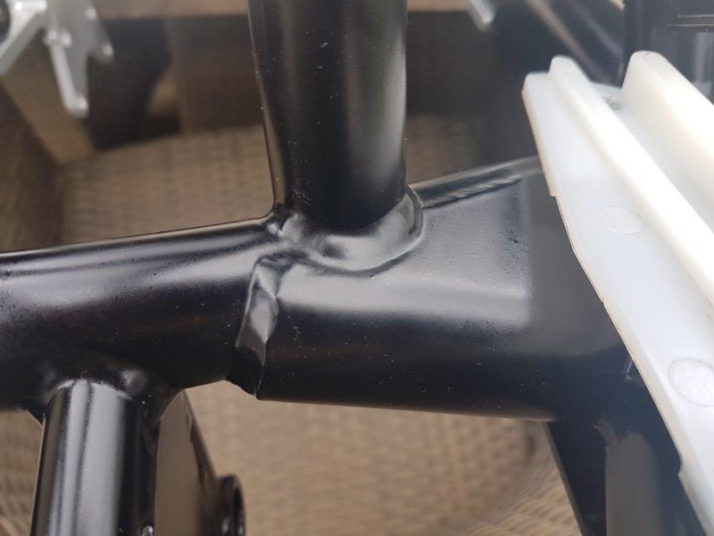

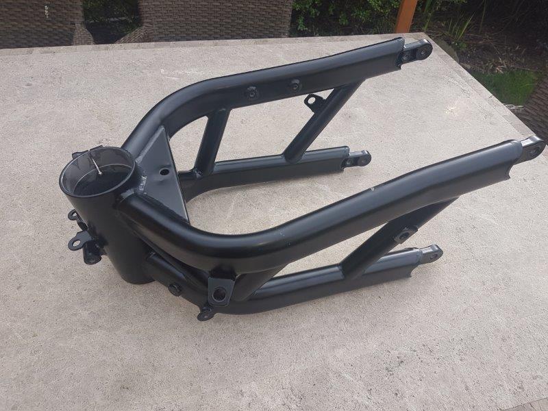

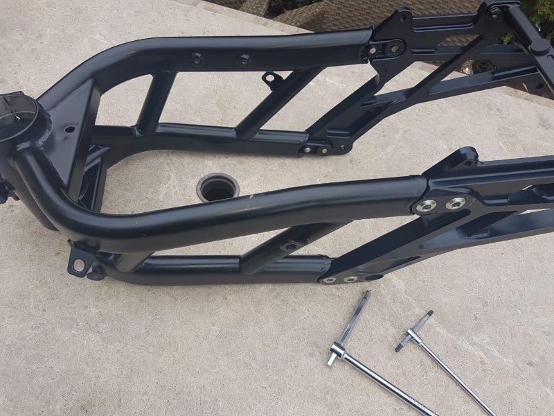

The frame came back from the powder coaters and after an initial rejection and re coat .........all was ok.
The rejection was caused by 'fluid' coming out of the 2 tapped M6 bosses on the inside of the frame section at, roughly, the airbox level.
You can see the tapped bosses welded into the frame spars.
The worlds most expensive fairing bracket at 650 Euro was offered up to see if all fitted....it did and I cried once more at the attached invoice.

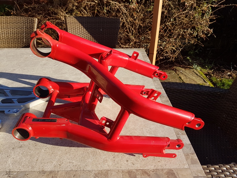

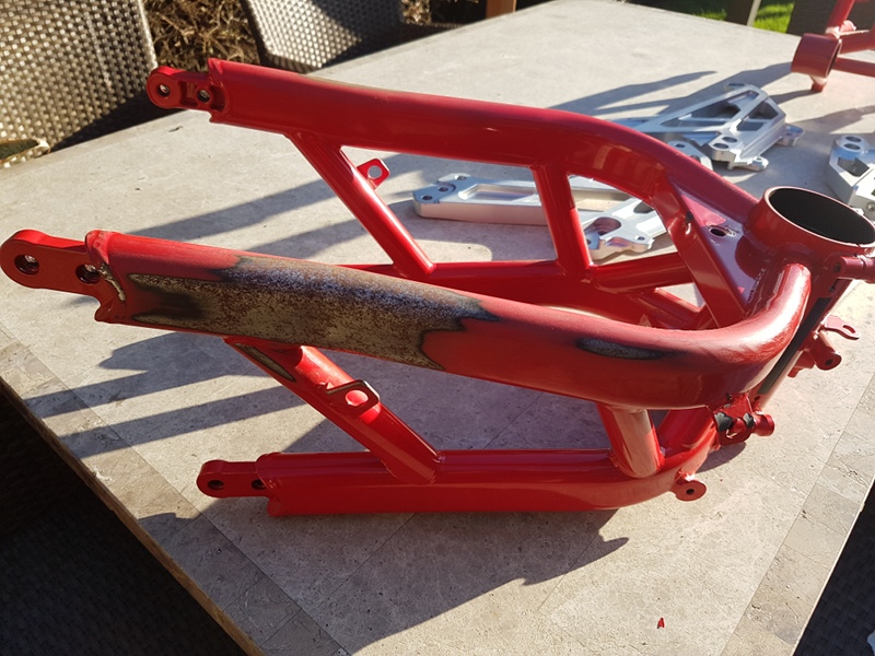

Here we have the swing ing arm.......
An internal shot of the swinging arm.
Shows the cut away for the shock...I had a similar issues on The DB9
The spring 'moves as it is used' and rubbed against the inside of the arm.
The sring on the EXTREME is of a smaller outside dia than OHLINS or MATRIS
