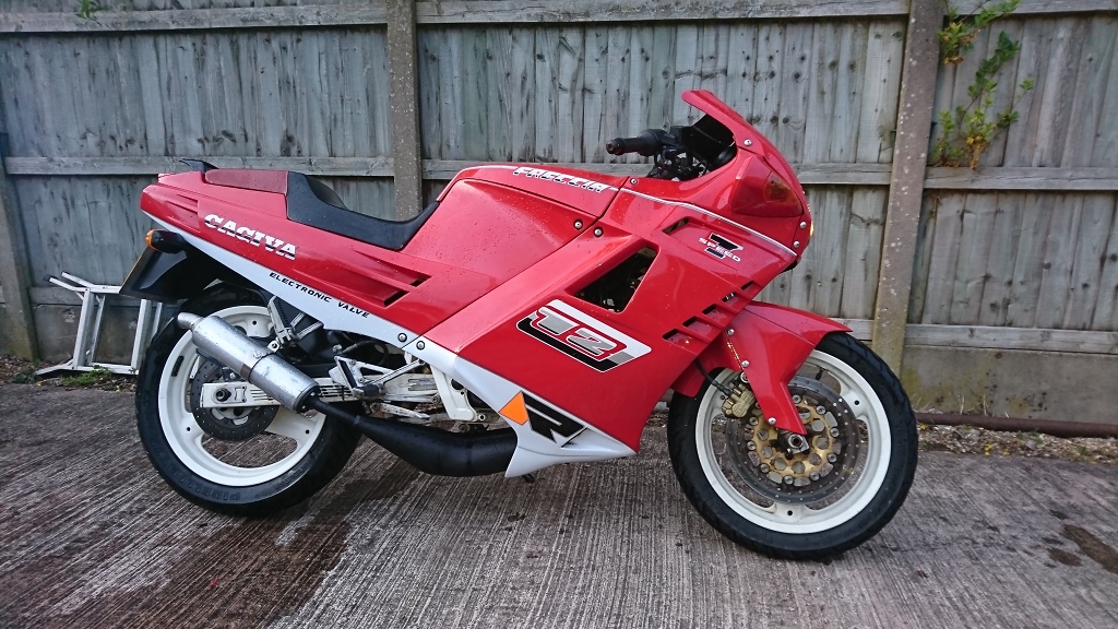

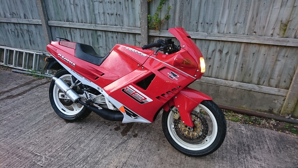

Another Italian 125 2 squeak.
We have 2 Cagiva Freccia C12Rs. One is the ex road test bike and one that was bought for spares but was too good to break. Also some remains for spares.
Friday I stripped the carb on one of the Freccias to get it running again yesterday (the one bought for spares). And painted the exhaust, and fitted a fuel tap. Bled the brakes as well.
Managed to start the bike but it would only run on choke.
Had another go at the carb yesterday and got it running OK. So rang up and got an MOT booked, and it passed.
Last tax disk ran out in 2004
Still needs a bit doing. Whatever had accumulated in the carb has corroded the atomiser tube, so need to order a few bits.
