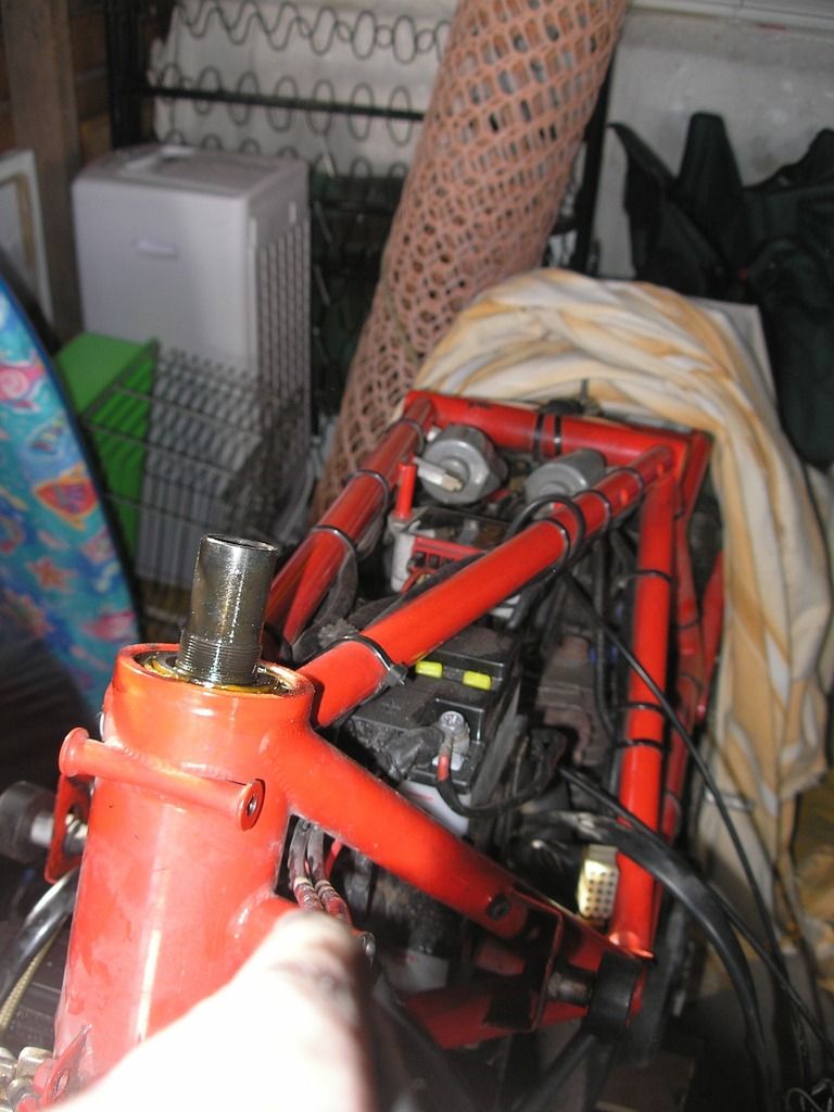

First shot is original battery, positive terminals to the front, positive on the left when sitting on the bike as you noted.

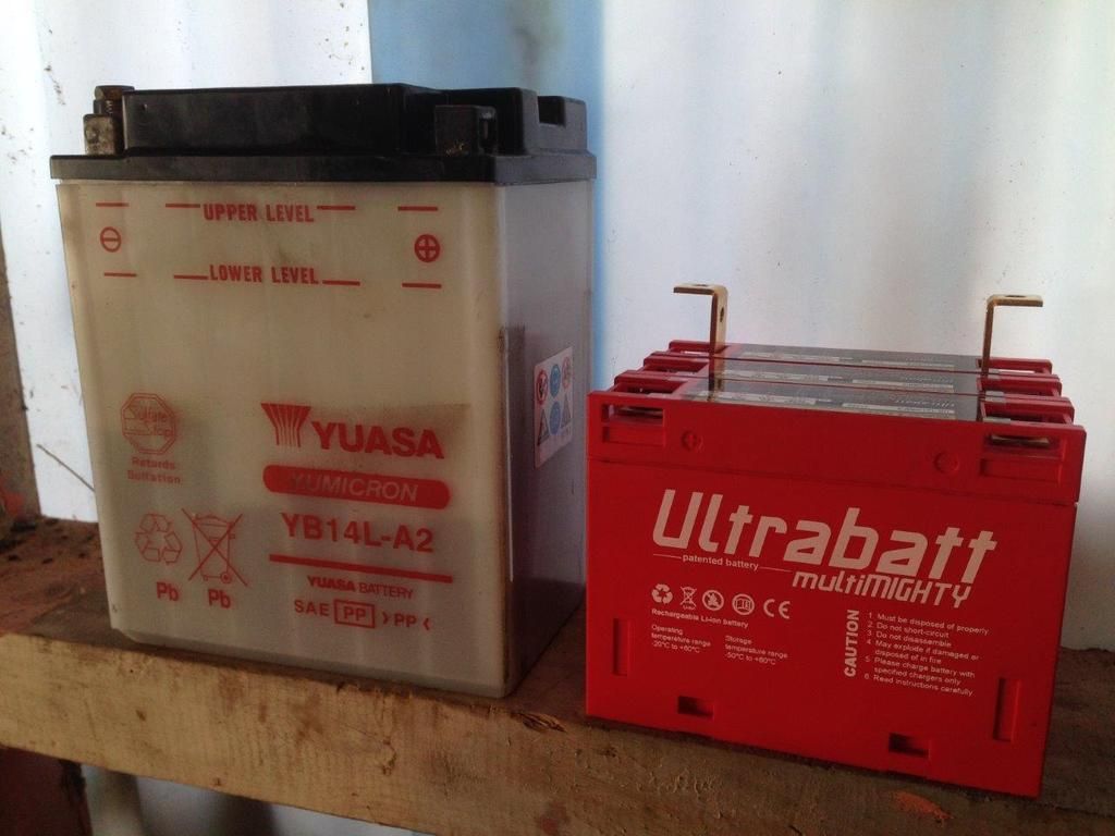

Second shot is comparison with Ultrabat - 3 module (not Motobat as previously mentioned)

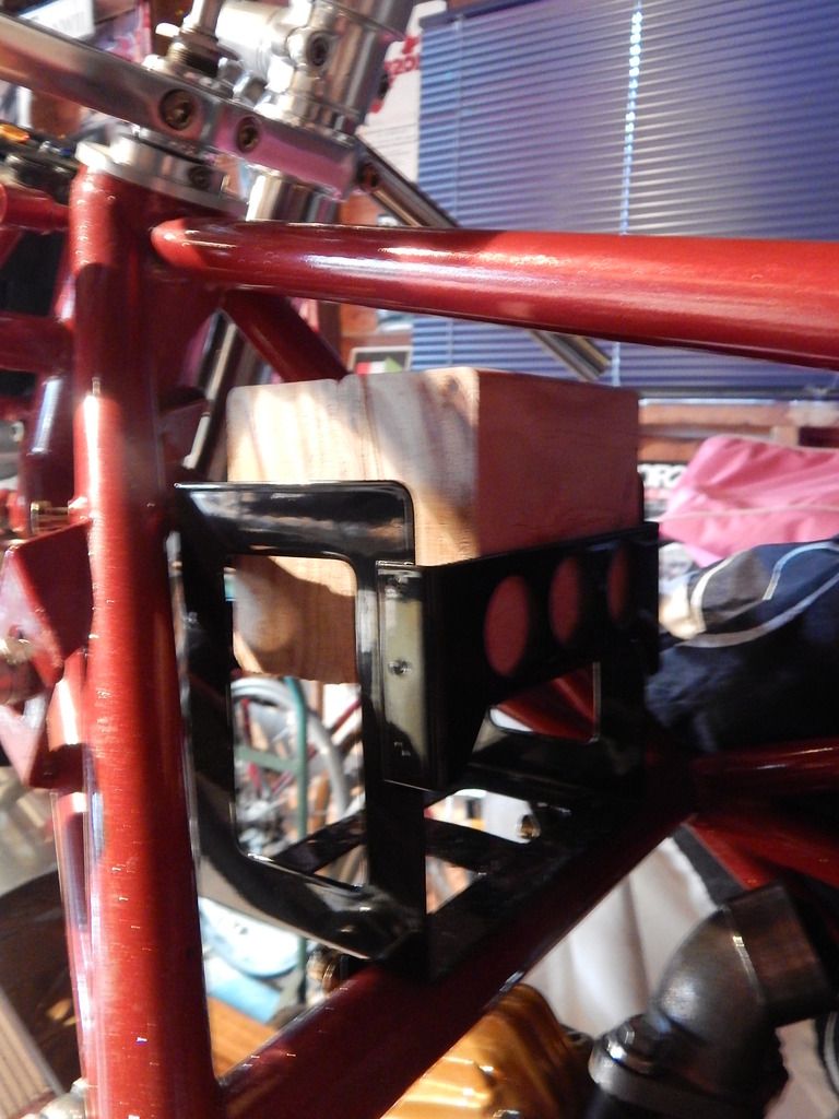

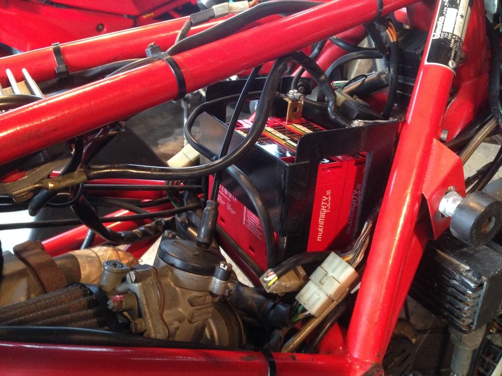

4th and 5th shots are my mock up of ultrabat install from the side and front. You can see the extra opening available below the battery to let air over the rear cylinder head
Battery box was lightly modified with a hole saw to get air over the LiPo battery and tin snips/vicegrips to create a landing for the smaller battery to sit on, then all off to the powder coater for a fresh coat of paint.
