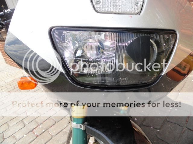

TVRRICH
Joined: 05 Feb 2016
Posts: 211
Location: Coventry UK
PostPosted: Thu Jan 12, 2017 4:38 pm    Post subject: Reply with quote
This is mine, From the replies im getting the impression swapping a UK spec one would involve more than a straight swap![img][/img] i would love to see a close up of your original 2 Bims and the numbers off it
PostPosted: Thu Jan 12, 2017 6:34 pm    Post subject: Reply with quote
Its a bit complicated if you were swapping to a foxeye unit with their special expensive bulbs....but going back to standard for the UK is straightforward...each of you beam unit will have 2 spade connecters.....the standard unit has 4 spade connecters....one for low beam and one for high beam so wiring and connecters would stay the same...and still work as norm off the LHS switchgear...I'll photo up my original unit back and front...the standard lamps are also shallower with the back box so no space issue there...I had to fiddle around with my speedo drive cable and cut a slot in the back of the twin beam Vdue unit to get it to fit...evidently as you have a separate sidelight unit atop the main unit that is cut out in the bodywork...you'd probably keep that but you could also pull those 2 connecters and connect onto the sidelight in the main unit.......

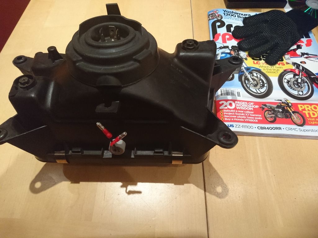

PostPosted: Thu Jan 12, 2017 6:50 pm    Post subject: Reply with quote
In fact...mine looks just like this from front to back....rubber cover plug on back of bulb is missing on this one though that "seals" the unit.........
http://www.ebay.co.uk/itm/Yamaha-FZR1000-FZR-1000-RV-1992-Headlight-Unit-Headlamp-Front-Light-/381726127170?hash=item58e0a67442:g:m1sAAOSwARZXpHYz
Number and words on front are
H4
motorcycle
110-31696 japan
PostPosted: Thu Jan 12, 2017 7:16 pm    Post subject: Reply with quote
Numbers on the front lens real difficult to read without a torch shining on it....on the back and front it says Koito, Japan, on back its stamped SAE M 90 12V 60/55W...I've taken piccies and will upload later...3 pin connecter bulb on the back...think I have photos of how mine was connected before I changed it...only pliers needed...kept same connecters.......rubber grommets in plastic casing 4 no are electrical hole rubbers from Halfords as fitted by BImota to keep vibes down maybe as Duc engine fitted to this bike and not a Yammie unot...Early FZR600 units seem to be the same...1991 ish

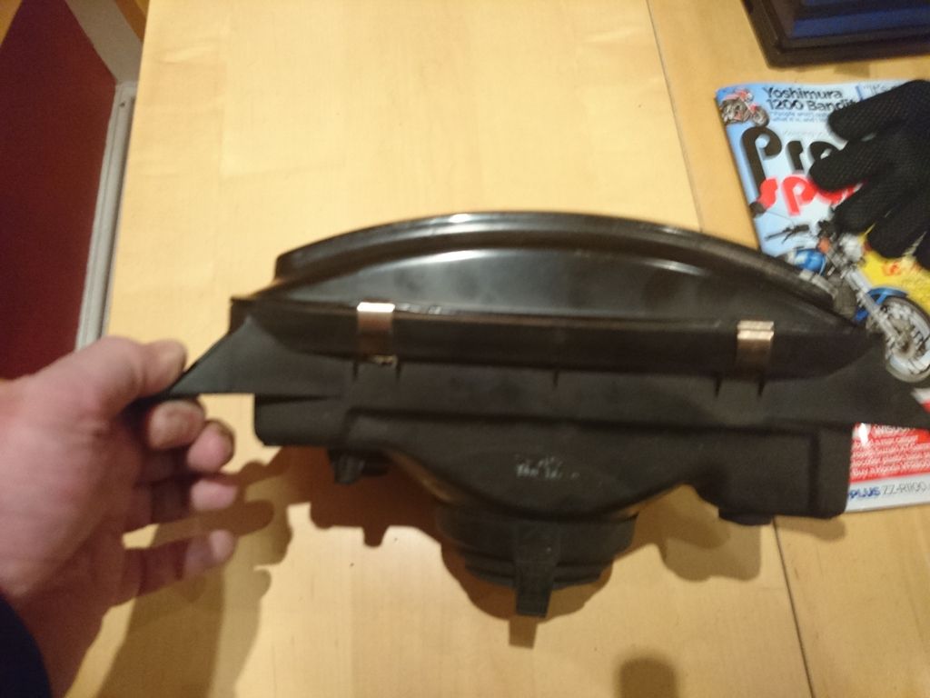

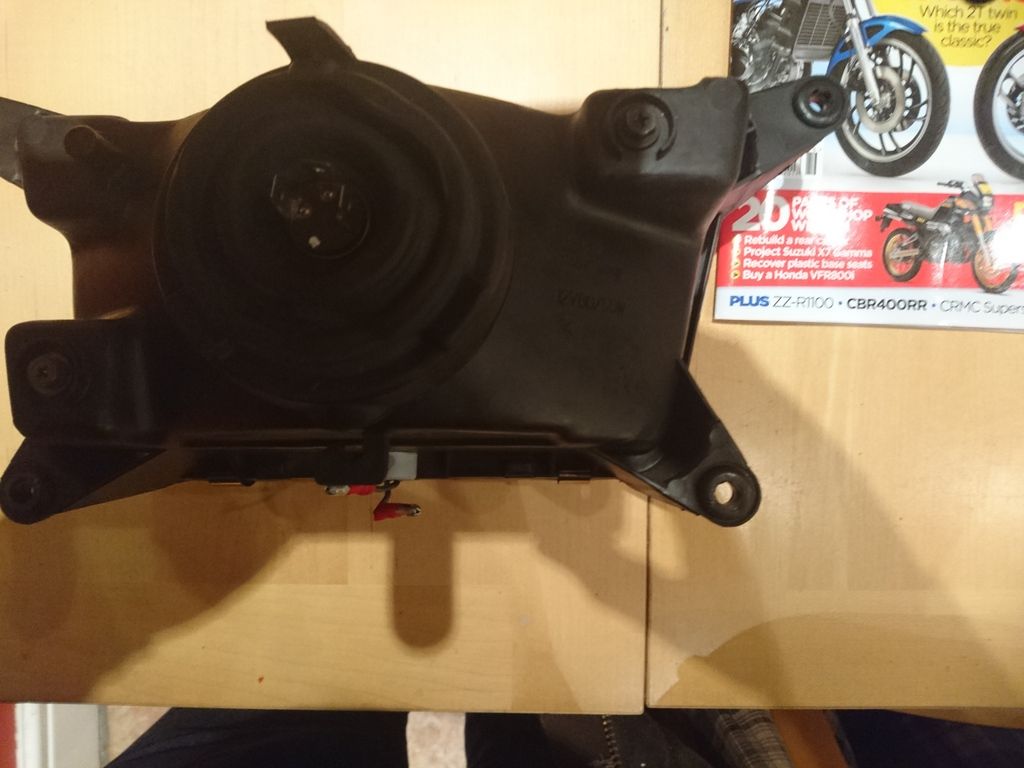

PostPosted: Thu Jan 12, 2017 9:17 pm    Post subject: Reply with quote
This unit is exactly the same as the one removed from my DB2...same codes on front and back...and still has the rubber cover in place..."snapped" top 2 brackets not such an issue...glue the rubber grommets in place...fit the tube ally insert and bolt and large flat washer and it will hold itself in place on the standard DB2 front subframe...and at the bottom...still desperately waiting for photobucket to upload pictures..I swore it could never get worse but I was wrong....
http://www.ebay.co.uk/itm/Yamaha-FZR600-FZR-600-3HE-Headlight-Head-Light-Lamp-1991-/332064066301?hash=item4d508f8afd:g:g9AAAOSwI2dXFVoP

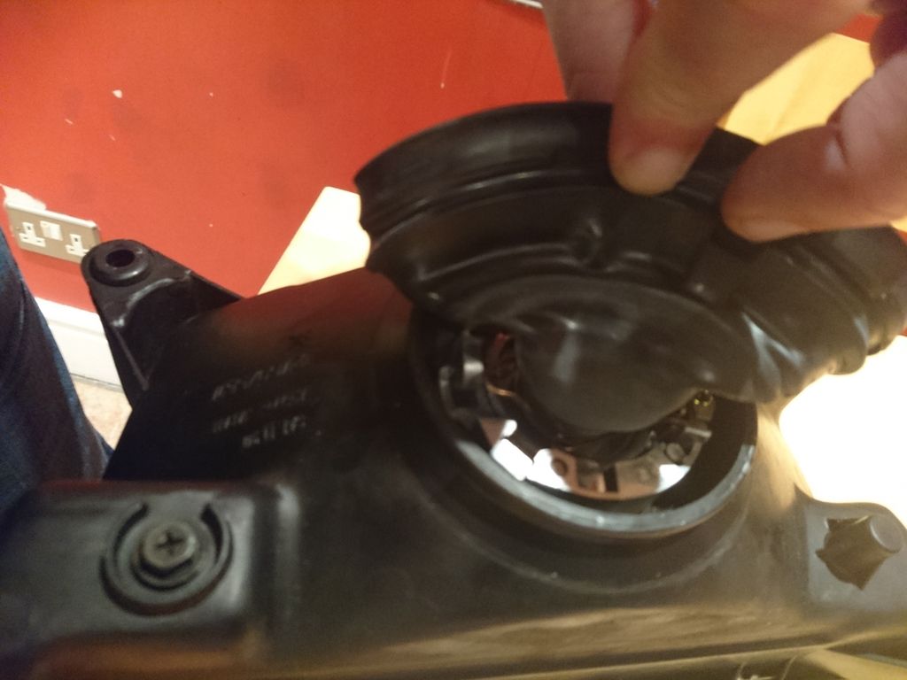

PostPosted: Thu Jan 12, 2017 9:26 pm    Post subject: Reply with quote
Just ask the seller if the bulb and P clip are beneath the rubber cover if interested...as the P clip fits to the unit to hold the bulb in place and in the right orientation...hopefully pictures now
