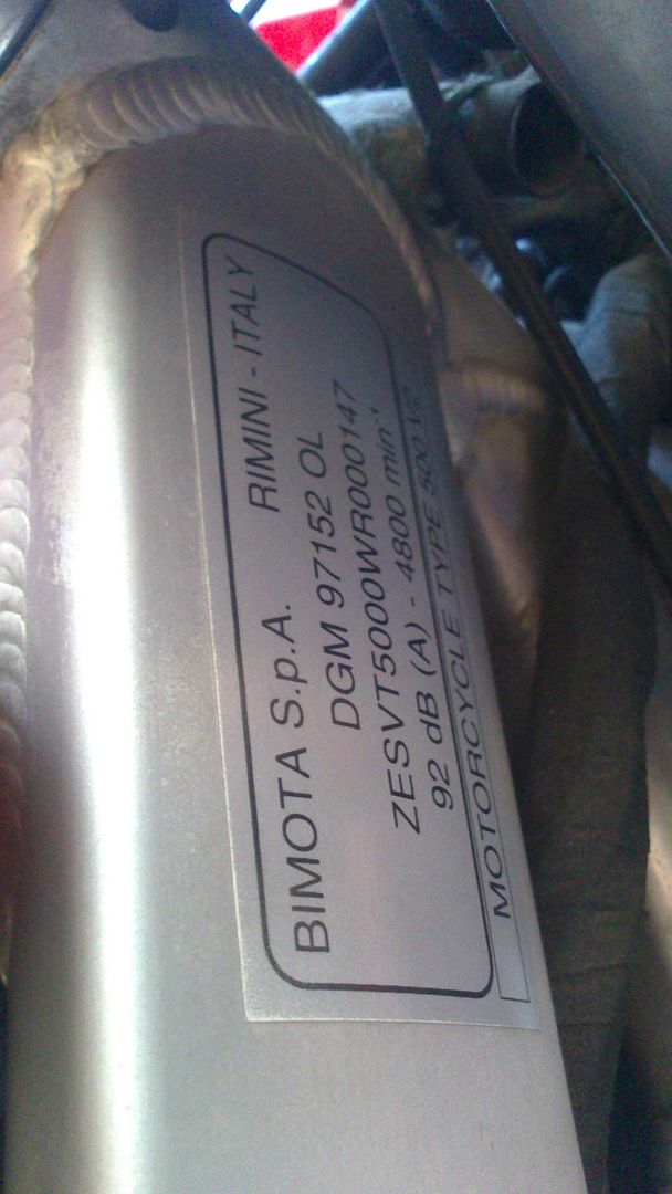

Hi Guys,
So Wikipedia mentions the first 150 units as being the problematic ones :
"The first production run of 150 bikes suffered from major problems including oil leaks, seized pistons and intermittent power delivery. Many new owners simply returned their bikes at this point. In 1999 Bimota managed to fix most of the initial faults and made 26 units, all however were not road legal. In 2001 Bimota gave up with its problematic electronic fuel injection and fitted carburetors, first producing the non-road legal "Evoluzione Corsa" model of which only 14 were produced and finally the road legal "Evoluzione" model of which 120 where produced and sold."
Mine is frame # WR00000147 and looks like a corsa, no headlight, GP clocks, tucked pipes and fitted with carbs. Still have no firm answer, documents just say Vdue Racing.
Odd Bike article adds this :
Bimota went bankrupt in 1999, after having produced 340 V-Dues of the proposed 500 example run, 21 of which were the Evoluzione.
My question is because its frame number #147, does it mean its one of the problematic original batch?
It has 0km, so my thoughts are its part of the original batch, yet wasn't sold and was then corrected later on?
Anyone have insight into serial numbers on these bikes?
Just interested to know where mine fits in in the story, and facts/stats differ slightly from webpage to webpage.
Thanks guys, keep smoking Smile

Bimota are quite famed in that the frame numbers are often meaningless in year of production....consecutive frame numbers can be a few years apart in "registered" vehicles......different specs, colours etc...
For the Vdues...the 2 letters at the beginning have a sort of meaning...the R is place of manufacture, being Rimini...and the capital letter denotes the year
V is for 1997
W is for 1998
X is for 1999
Y is for 2000
1 is for 2001...running to 9 for 2009.......these would be the era when Piero bought the remaining stock and started conversions......
At the time of the debarcle...Bimota were accepting returns...either for a full refund or part exchange for say a SB6 or YB11....and stock went back to the factory......some were changed, some people didnt return the bikes...and when they finally went bankrupt, Piero bought the stock of completed, returned and uncompleted Vdues and the rights to the name Bimota Spa......and started the process of changing, refining etc etc.....I think only a strip of the engine or at least photos etc would confirm whether it was a full, part or next to mods version....I'm not so sure if Piero kept records based on the frame numbers........

PostPosted: Thu Jun 09, 2016 7:47 pm    Post subject: Reply with quote
Thanks 2Bims, much appreciated!
I know of the basic story, but didn't know of the frame numbers and corresponding years.
Here are some images, if you could maybe give me your opinion as to where this one might fit in?

Where abouts on frame number do you mean? Mine for eg is ZESVT500WR000147, I assuming the WR bit means its a 1998? the #147 would maybe point to this, although you say not to pay too much attention to this.
Did you guys see the Vdue on Ebay frame number #0026 and the claim that that is the last of the 26 Trofeos made?
PostPosted: Wed Aug 17, 2016 11:26 pm    Post subject: Reply with quote
Yeh thats right....they all start ZESVT...then 500 for the cc then W as yours is for 1998...then its R for place of manufacture, being Rimini...then the frame number....but that again is when the frame was made and not necessarily the bike itself due to the stalled production, recall, registration etc...we have a choice in the UK for road registering it correct to year of frame...or if "new" and never road registered before...a new vehicle registration current to the current year.........
