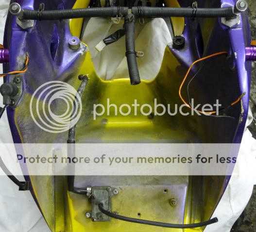

I bought a Mantra with dodgy paint and the tank disconnected. I've loaded up 3 pictures. How does it plumb in?

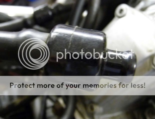

The carbs have pipes with bulbous inline filters. Are these air intakes? Do they connect to anything, or just hang?

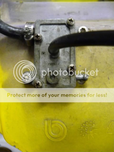

The tank has a link pipe linking the 2 halves, and a T-peice. At the rear of the bottom of the tank there's a place with an 'in' arrow, an 'out' arrow, and a thinner pipe that looks like a drain or breather pipe. Again, what goes where please? No guesses please - I can guess, but I'm hoping that someone actually knows.

| Hi, thanks for putting the pictures up. Engine runs fine on a drip with the tank off, but runs only a short time when using the tank - sounds like tank not venting, needing a vacuum from the engine or something fairly simple. I got the bike with the tank off, and given the above, the previous owner probably didn't know how to put it back correctly, hence the question. |

I know you don't want guesses BUT I think the oblong shaped thing with the in, out and small bore pipe is the fuel shut off. in and out are obvious and the smaller pipe is vacuum from the carbs  |

So the T peice goes to the in, the out goes to the carbs, and the vacuum goes to the inlet manifold? I can rig all that up off the bike and see if it flows. Never heard of a Bimota workshop manual - do they exist? Had a SB6R nuda before, but sold it as uncomfortable. Wish I'd kept it, but if I kept every bike I liked, there'd be a garage full of bikes. Come to think of it... |

I figure it plumbs in exactly like you describe  |

Got the bike stripped of bodywork and running from a bottle with tank off. Then put the tank on, having cleared the taps of rubbish, and runs fine. So, blocked taps (looks like powder from last paint job), and a leaking vacuum takeoff from inlet mainfold, which won't have helped.
