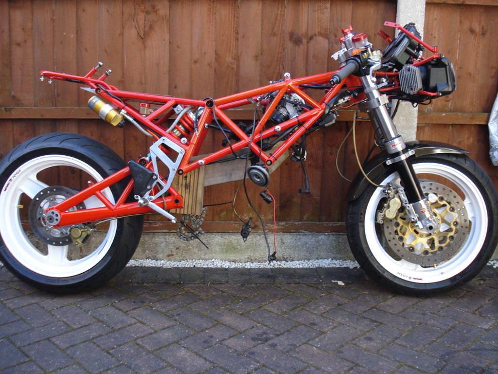

Suitable for electric power installation only......Or pedal power with fixed rear wheel......really quite nice and light but maybe a little overbraked for its capability.........

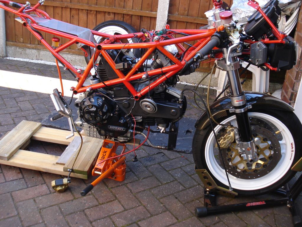

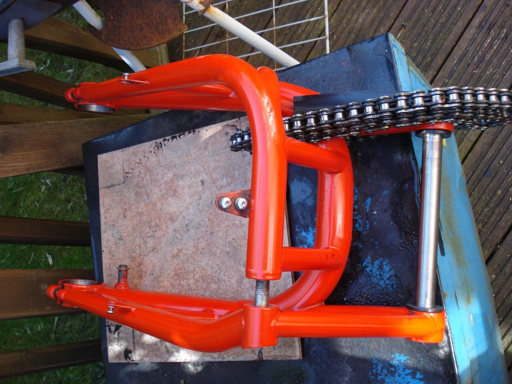

Or could it just be the start of a full on restoration? Been some 6 years since she first became my first ever Bimota...and has stood the test of time and trials...and many belated promises of a full on engine out resto......sun is shining and Db4 fit and ready to be used...thus DB2 came out and simply fell apart in my hands....well that and every ruddy socket and tool at my disposal...What an absolute bitch to get the rear swing arm off...held by a low head 7mm...yup...7mm allen bolt...that you cant get into no matter which way you tilt the engine or frame.....other than jacking the bike 3 foot up in the air and letting it hang down at the back wheel out...and then just...small drill hex bit and a pair of adjustable wrench....as no space on either side to get a ratchet driver in place....
Was nice to find that all bolts, swinging arm bolt, engine mounting bolts and shock bolts came out easy enough...and still some copper slip on the ends of the threads also...previous owners spanner boy was OCD and a demon for detail.....
Will open up full resto, powder coat, engine refresh section in DB for anyone interested??? Is there anybody there???

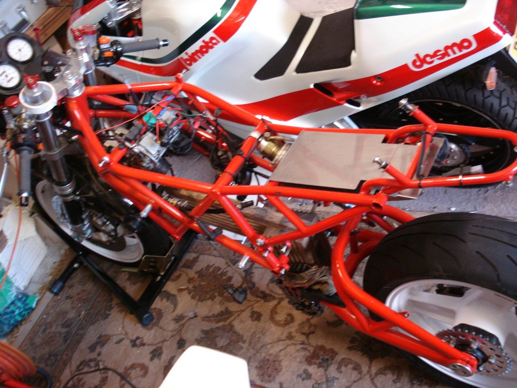

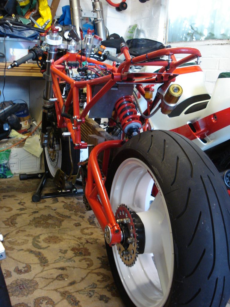

Few more closing shots before full strip and farm parts out for refresh....
Rolling chassis for easy storage whilst mind deliberated over full strip or mini resto

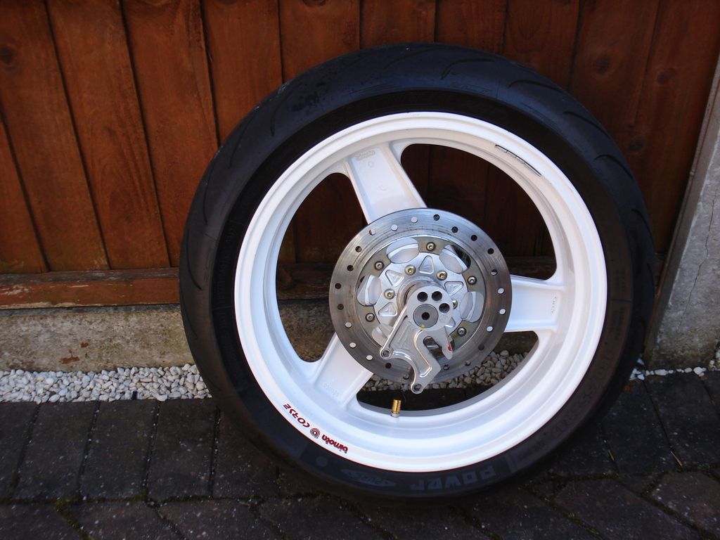

Rear concentrics and half moon retaining collats makes rear wheel removal a doddle

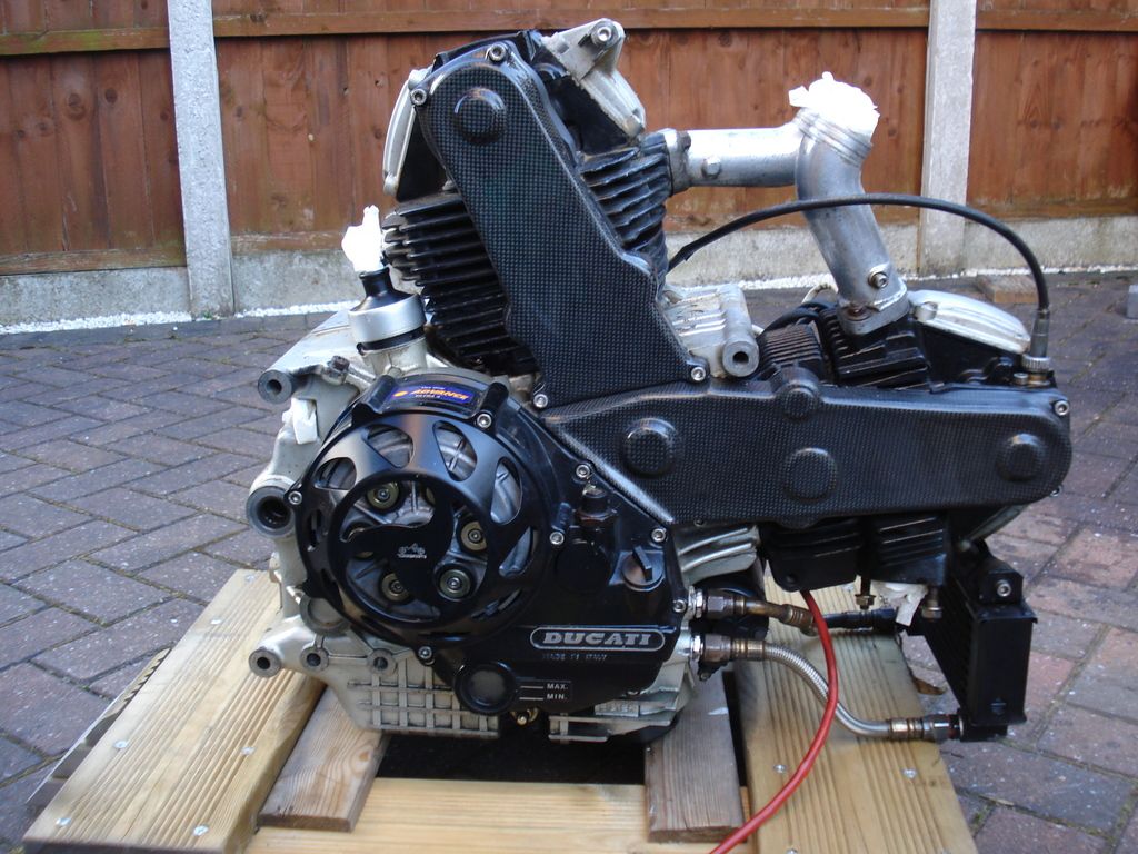

Moto corse titanium end system stored away
Finally...rear swingarm is out

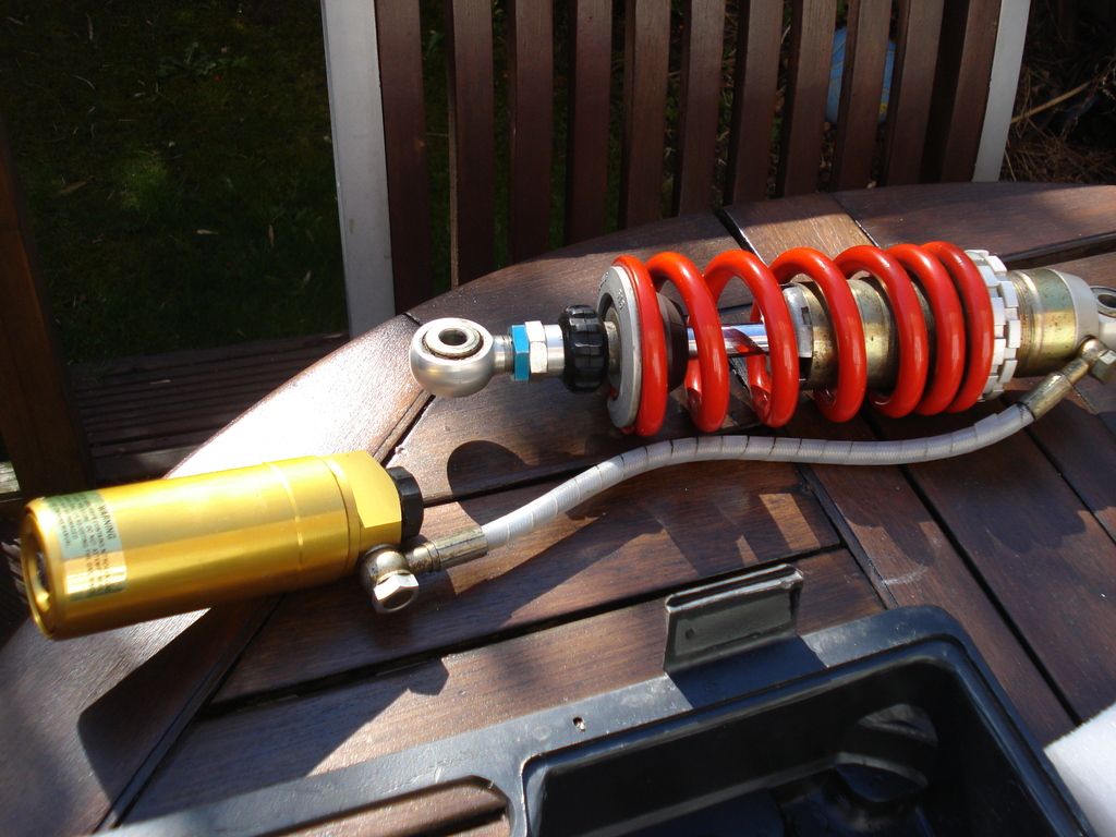

Ohlins shock spring will be going back to classic "yellow"...or should I stay red as it came? Nostalgia biting?

Think the red spring looks better, but yellow is Ohlins... Actually think a white or black spring would work better though.

| Oh jeeso...thats 4 yes's already....and the Yanks and Aussies havent clocked in yet...might have a new task for posting then.....White...Hhmmm...smacks of White Power or Paiolo...which it aint...yellow traditional Ohlins yup...red matches frame...Black???....perhaps green to go with the tricolor theme??...or green/white/red banding???.....That would throw the powder coaters into a spin for sure.... |

I vote for returning the spring to its original yellow. Yellow makes it really pop out from under the seat and the utter simplicity of the cantilever is enhanced. Your first picture does a great job of showing just how minimal the DB2 is ... frame, motor, forks, brakes, wheels, and a thread of electrical harness. Simplify and then add lightness. Unbeatable. _________________ 2013 retro Italian agricultural device

Removal of swingarm isnt impossible....it just seems so when you've never done it before....and the manuals dont bother to tell you......Best procedure is....Or rather only procedure is....
Clothes off - Bike that is - remove rear hugger
Front wheel in chock stand or head stand to keep upright as rear will need jacking up
Remove front sprocket cover
Remove front sprocket and pull chain with it, also eases rear wheel removal.
Remove rear brake caliper
Remove half moon concentric holder shells from rear of swingarm
Twist concentric and wheel pops out
Now remove rear shock retaining bolt from swingarm to free the shock
Jack bike up in air using chocks of wood under the engine to spread the load on the crankcases
Keep jacking to allow the swingarm to fall to its lowest position, which is when it hits the engine, trying to lift it up and it hits the frame and access still isnt possible
Then find a 7mm hex key....drive into allen bolt and turn with adjustable pliers as there still isnt room for a ratchet to fit on....RHS clashes with clutch engine casing...LHS clashes with Sprocket engine casing/splined shaft..
I did previously drown all bolts in WD40, and to be frank...the pinch bolts are just fitted as a "pinch" and not heavily torqued up...just be sure that the hex socket is firmly in the hole as its a "low head" hex socket...and italian steel...so if not firmly located it would round the head off.....
Althernatively find a 7mm allen key and saw off the first cm or so....I tried 5 sets of allen keys I had...metric and imperial and all of them didnt have 7mm.....Grrghhhh...its just an odd size that only Bimota would use

Yellow , Ohlins has to be yellow !!!! Bit like getting a Ferrari that is not red !! |
Posted: Fri Apr 22, 2016 9:18 am Post subject: |
Darn it....thats 8 "yes" votes so far...another 2 and my camera will have to go into overdrive.......Looks like "ohlins" yellow is getting the vote on the rear shock.....Phew........  |
