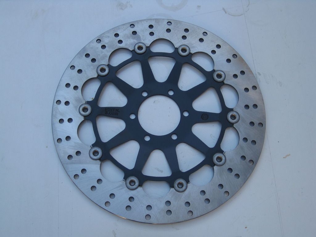

PostPosted: Tue Oct 20, 2015 1:46 pm    Post subject: Reply with quote
These are the disc's, got them from Piero as spare's , same as the last ef10 vdues he produced as the standard gold ones have 1 less or 1 more bobbin ( can't remember which ) on Ducati's etc, but got a spare set for each bike which I think is a bit over the top so if you want a set I can sell one set.
What vdue you after ? might be able to help there also.
