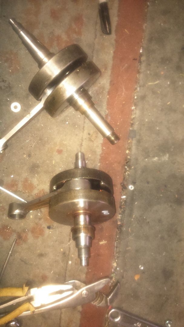

does anyone know the sizes of big end bearings please ?
piero doesnt have any, my engine is stripped
and i need to get the cranks sent off
anyone ?
ive emailed piero and im hoping he can tell me and if he does i will post here

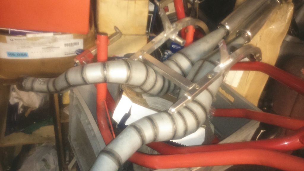

im going to be running the bike on the pump ,
the normal ones into the cranks and the other 2 lines are going to the carbs ,1 each and the feeds are going on the inlet part of the carb like kr1s ,tzr,
this is just a rough build , once its running and everything on and working i will strip it again and get it all painted ,plastic coated ,and nicol plating it should be nice once done

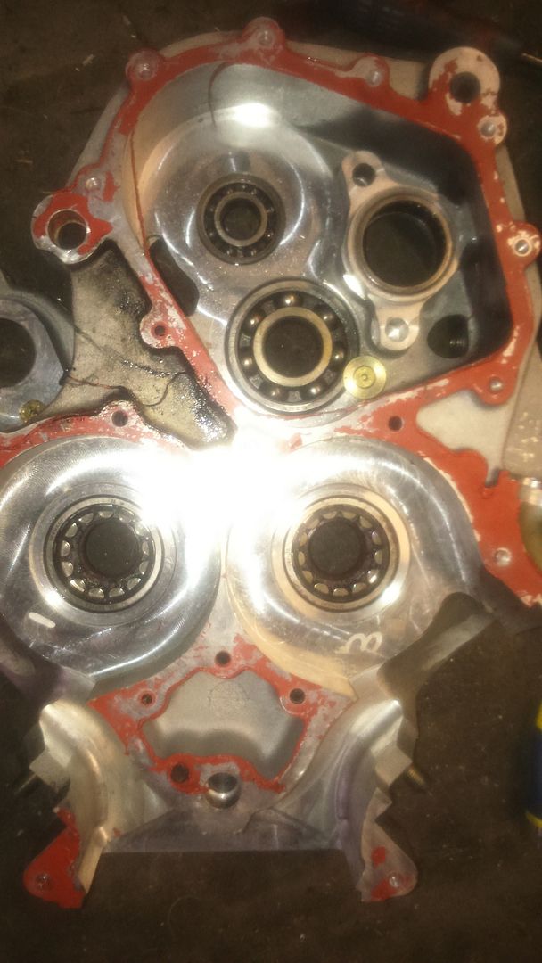

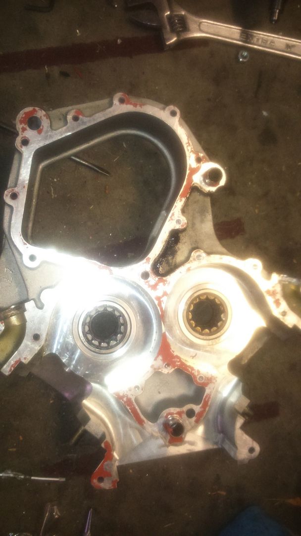

hi Guido good to hear from you again
can you look at the pics above of my crank cases please and the bearings ,what needs doing to make this a reliable motor ?
i was told that the engine had some mods done by the race team to
sort out the crank problems , ?
how would i know if it had ?
the mains are ok ive had someone look at them today but one of the big end bearings needs changing so getting both done while they are in bits ,
any advice you can give would be appreciated !
like how your getting better lubrication to the big end bearing ?
im having auto lube into the pwk carb same as normal 2 strokes and also keeping the 2 feeds into the cranks .
will it be ok like that ?

PostPosted: Mon Aug 31, 2015 10:35 am    Post subject: Reply with quote
Hi Gary
They are modded cases
not the standed set up
Cheers Trev

PostPosted: Mon Aug 31, 2015 11:45 pm    Post subject: Reply with quote
Your set up was the 500 cup bike mods
I run the same set up
but with even more up grades
- drilled cases for fuel mixture to main bearings
- slotted con rods
- no case oil feed , just premix
Run for years like this no problem
Cheers Trev

PostPosted: Tue Sep 01, 2015 2:01 am    Post subject: Reply with quote
THE DRILLED CASES YOURS HAS DONE IS THAT
looking down where the barrels fit either side of the con rod there is a hole drilled at each side with a chamferd bowl shaped bit to catch more oil ? if yes mine has those also
or is it a different drilled cases ?
my engine is no 25 trofero so was a race motor
trev45
Joined: 15 Jun 2011
Location: Sydney Australia
PostPosted: Tue Sep 01, 2015 9:02 am    Post subject: Reply with quote
Yours is same same then
Lucky boy they go well
You just need some rod kits then Wink
Cheers Trev
