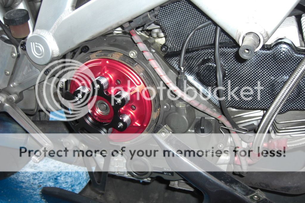

PostPosted: Tue Aug 09, 2016 5:26 pm    Post subject: Reply with quote
Picture of the sight glass on my DB4 900ss motor.
Sounds like the MAX should be the MIN on yours.
1/2ltr of oil in 500km is way to much, don't remember having to top up any Duc engine much between 4000mile services.
Something not quite right there as 134psi seems a little on the low side and smoking is also not something I have suffered with on Duc air cooled motors.
