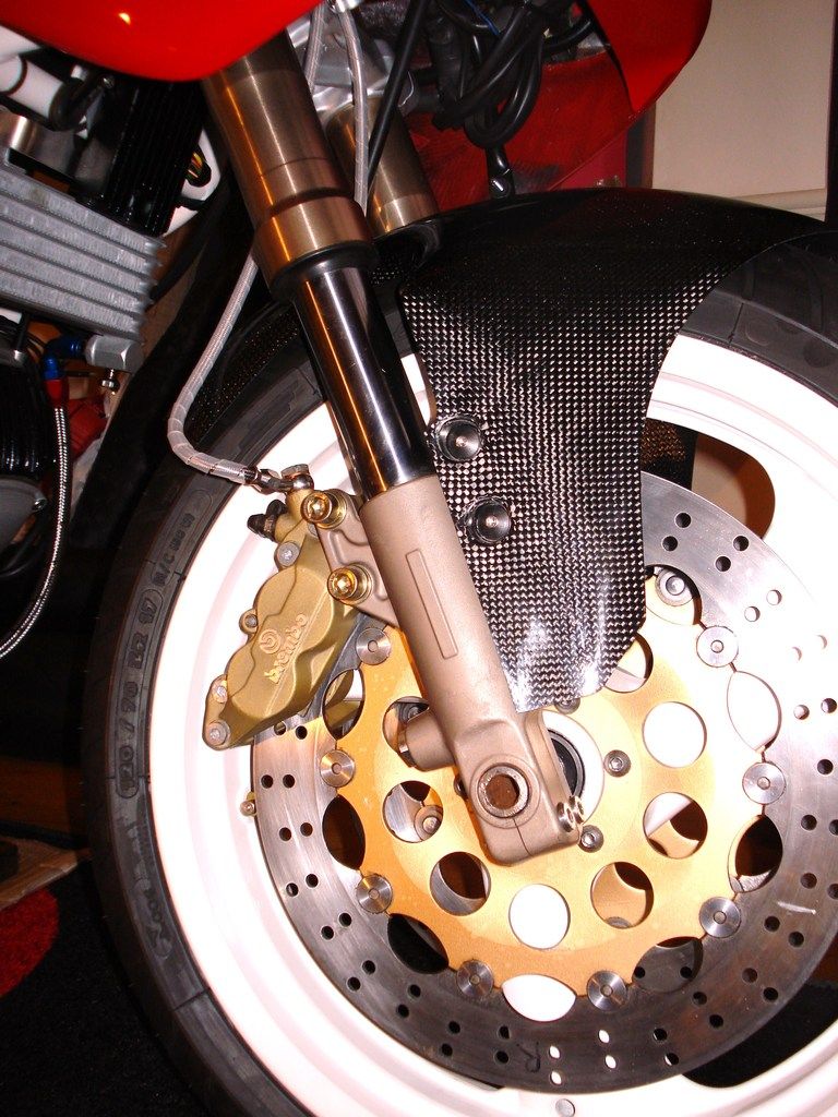

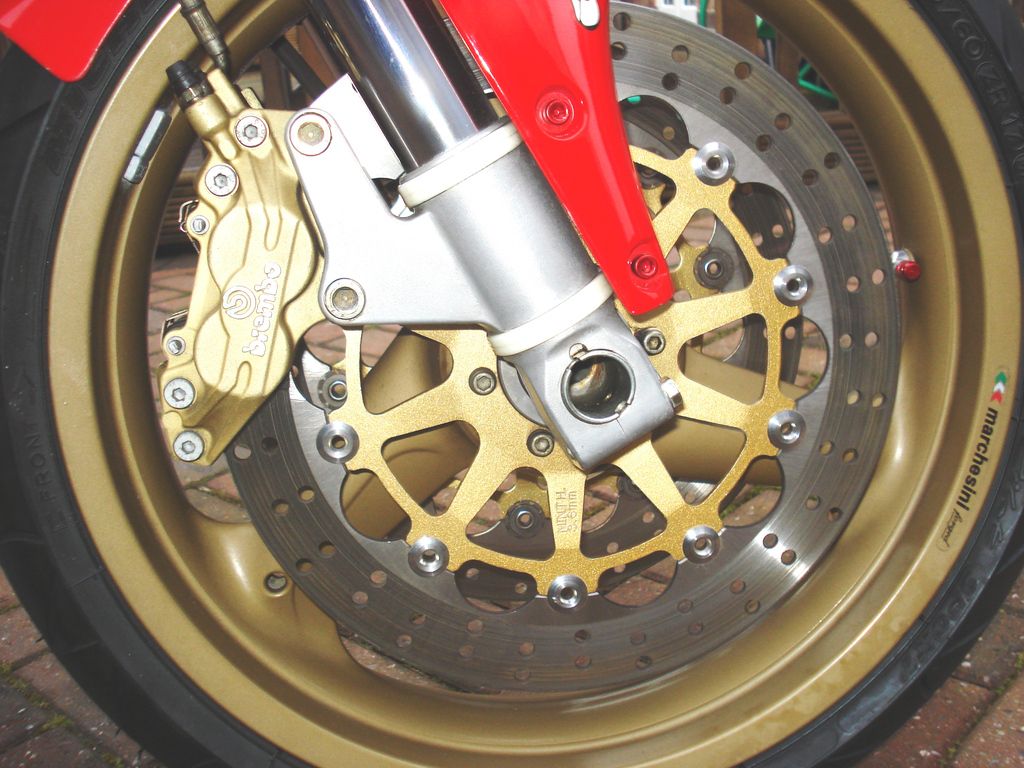

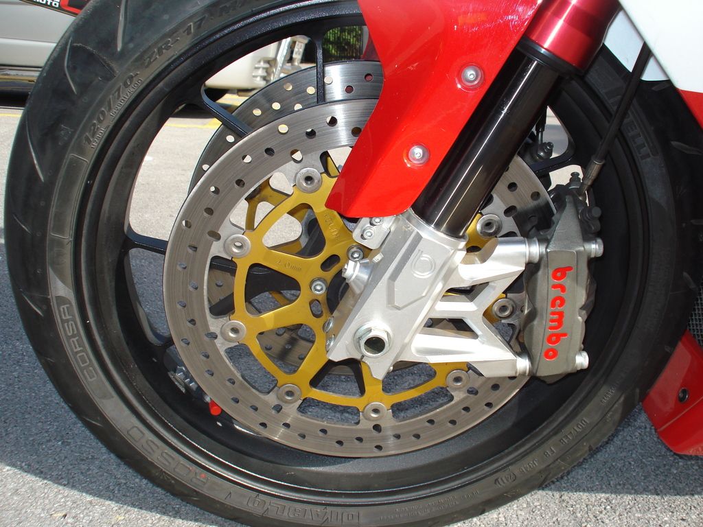

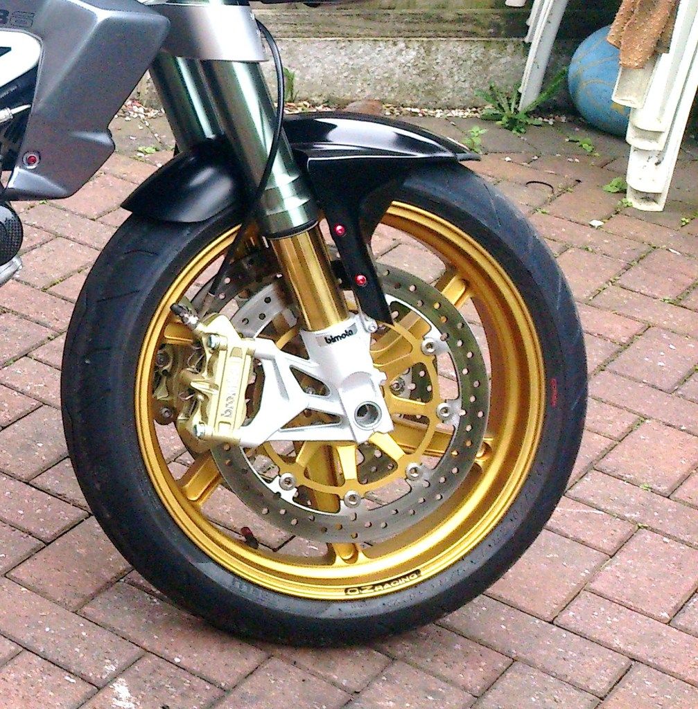

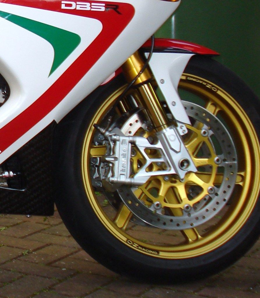

Posted: Tue Apr 28, 2015 2:40 pm Post subject: |
Front Brake Rotors
DB1 - Large offset, 280mm thick carrier, brembo, cast iron full floaters, no longer made by Brembo but identical discs now being remade...as used on Ducati TT1, F1 - So...pretty rare in themselves - rear is brembo 260mm cast iron, same as used on the FRONT of same period Ducatis, 600Sl Pantah etc
DB2 (Early Oscom Wheels) - 320mm Large Offset, thick carrier, Cast Iron full floaters, no longer made by Brembo but identical discs now being remade by others - As used on Early Sb6, YB4/5/6/7/8/9/10...Only used on one Ducati...the Supermono...so no use there then...
DB3 and BB1, later SB6 - Antera Wheels, Brembo ss discs,320mm slight offset, used on many Ducatis 1991-2000 with marchesini wheels, Laverdas etc, Still available
Db4 and Vdue (Antera Rims) - 320mm Also as used on Ducatis 1996-2000, slight offset, thinner carrier ss discs, still being made
YB11 - 320mm Cast iron full flloaters, slight offset, thicker carrier, also as on Sb6R...and fitted to the higher Spec Ducatis, 748sps, 916sps, 888 SP3 etc -
DB5 - Fixed thinner rotor Brembo discs, 320mm, stainless steel...also as fitted to Ducatis 2000-2010 ish (Ducatis like panigales have gone to 330mm discs)
DB6R - Fixed thinner rotor Brembo discs, 320mm, stainless steel...also as fitted to Ducatis 2000-2010 ish (Ducatis like panigales have gone to 330mm discs)
DB6 - "Braking" wavey discs 320mm, thicker than the brembos
DB7 - Fixed thinner rotor Brembo discs, 320mm, stainless steel...also as fitted to Ducatis 2000-2010 ish (Ducatis like panigales have gone to 330mm discs)
Generally..........if the discs have 12 bobbins they are Full Floater cast iron....and if only 10 bobbins they are stainless steel "semi-floaters"
