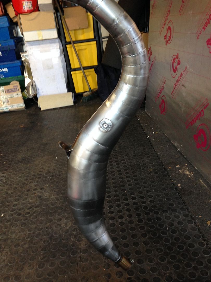

Results......
Looks like best solution is scotchbrite pads (I used a machine) to clean up the pipes..... It takes a while!!!
Then I clear lacquered them with 500c paint. They come up with a more silver finish than original, but still retain the nice look of the joins and welding etc.....

Results? Meed pictures for results....before and after??? Pretty please...never tire of looking at those welds

Cheers JRH....and Jeeso....you sure have been busy with the scothbrite.....could have put a warning on to "don" my sunglasses first.....didnt realise they had that nice stamped Jolly Moto logo on them...will have to rush and check mine now........Nice carbon gear rod by the way.......have one on mine....saved an almighty 6 grammes over the alloy one..
And nice to see we all have that pair of spare electrical connectors just hanging around at the swingarm linkage.
Weather all being well..should be out on mine this weekend.....
KTM Superduke in the background?
PostPosted: Fri Jun 26, 2015 11:16 am    Post subject: Reply with quote
Wow JRH you have been busy, mine starting to show signs of rust now also, really need to done something with them.
You do know this is going to end in tears Confused !!!! You and 2bims comparing shiney bits !!! Shocked
