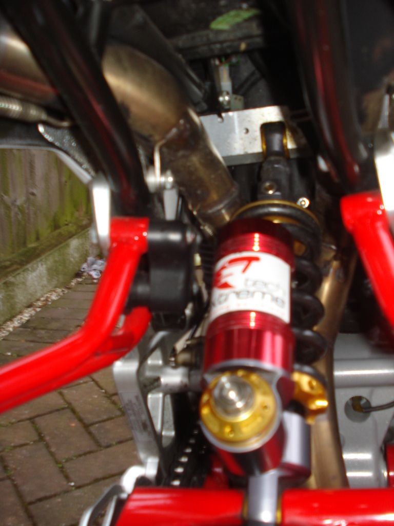

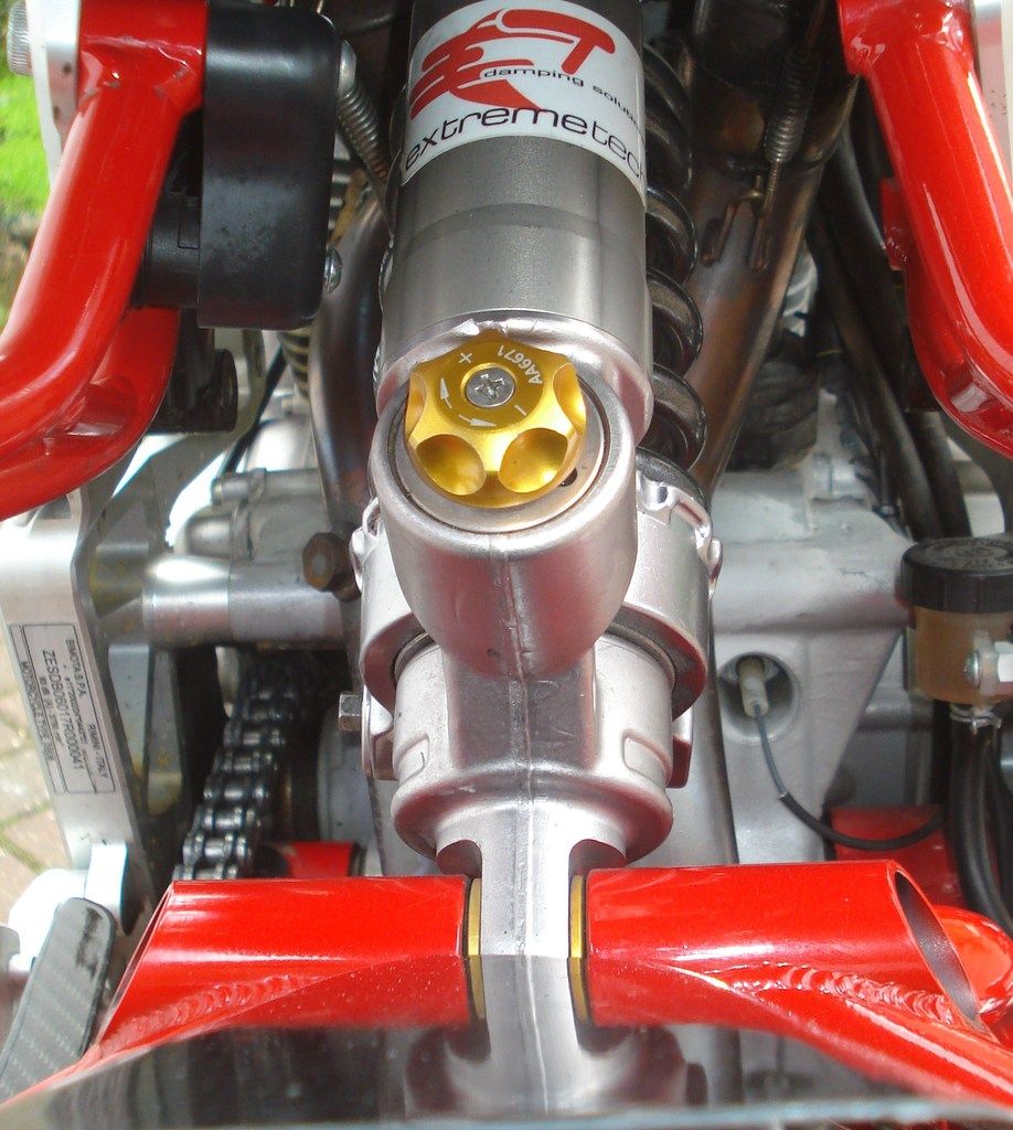

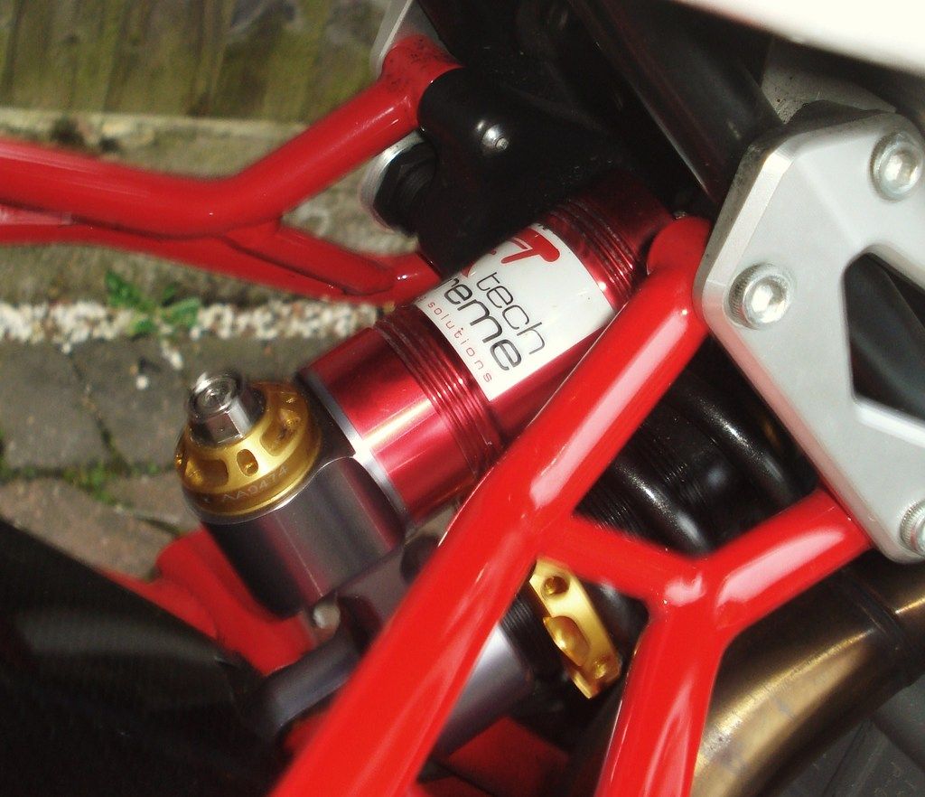

Are you on about the rebound clicker for the Front shock or the rear shock?
I can see that you have a Extreme Tech rear on there with an anodised remote body.....but cant quite see whether thats a clicker on the body or an allen bolt and hex nut?
Its an extreme Tech shock I've not seen before...either they are all anodised or all plain grey steel looking...as opposed to a combo of both
Standard Tech shock - DB5S
Standard DB6
DB6R

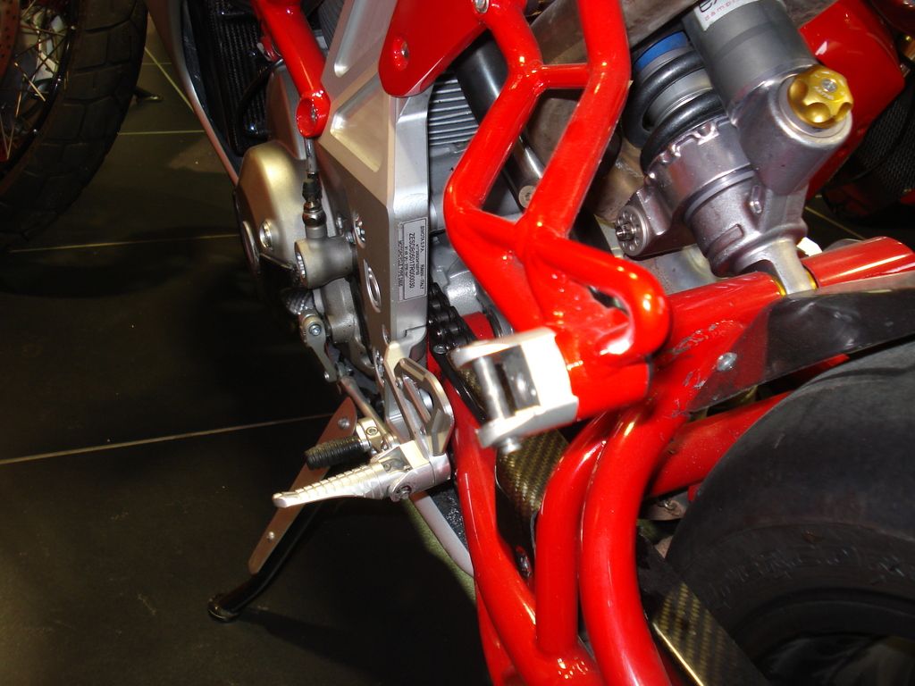

On the Extreme Tech shocks the rebound adjustment is normally an allen head located in the bottom eye of the damper shock....which on the rear shock would be uppermost under the seat...nicely sandwiched between the exhaust headers
On the Db6R shock the gold anodised ring on the remote body has High and Low speed Bump adjustment...as they call it....or compression/damping as we call it....The low speed part is the 5mm allen key with 22 clicks...factory setting is 12 clicks...the outer hex head nut, needs a 15mm wrench and is the high speed compression...with 14 clicks...factory setting 8 clicks....
On the second to last picture below you can just see the rebound screw gold adjuster at the top of the shock body...accessed more easily by removing the riders seat pad
