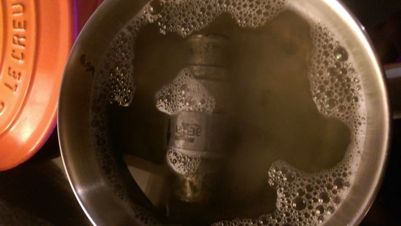

Third time it started and ran great, however it decided to take a piss all over the floor. Not really impressed, didn't think it was the headgasket, the radiator didn't get very warm so time to strip it down. Lots of old crud came out, system flushed. Thermostat tested, not gravy, it was stuck fast.
Boiled it for 20 mins, banged loads of shit out, repeat, now it works fine. Refit to the bike and put some stuff in as a flush.

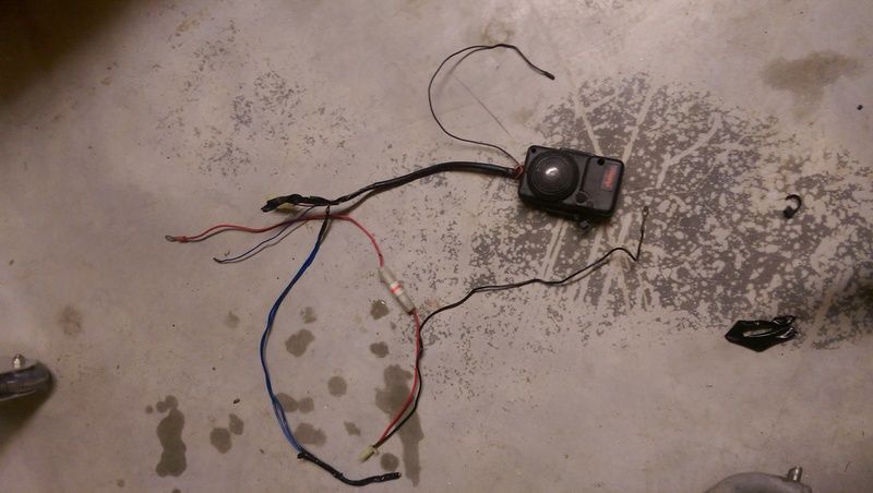

Go to start the bike, it wont. Remove old alarm

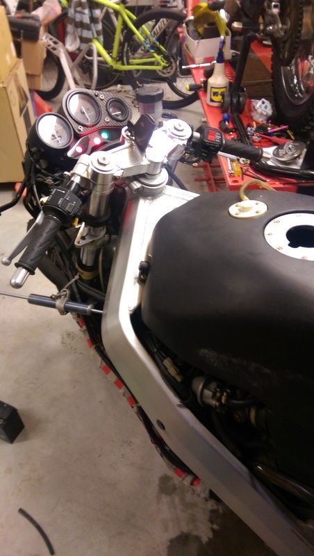

The batteries are parallel aren't they ?
PostPosted: Wed Feb 10, 2016 1:22 pm    Post subject: Reply with quote
There is 2 different set ups for SB6/7.
2x6v batteries in series or 2x12v in parallel , but as EC says, from your pictures the sb7 is in parallel.

PostPosted: Wed Feb 10, 2016 1:44 pm    Post subject: Reply with quote
They've been put in series, should be parallel!
I thought it was wrong but put new ones in as they came out......
PostPosted: Wed Feb 10, 2016 2:16 pm    Post subject: Reply with quote
Just blown picture up and I was missing the far right connection. Thought the batteries were pushed together but the right hand one is out of position , isn't it ?
So as I see it the connections are thus
Is that correct ????
If so you have the early set up which is 2x6v batteries, so you either need to get 2 new batteries or get negative loop made for the negative.
Later 2x12v is this
PostPosted: Wed Feb 10, 2016 6:09 pm    Post subject: Reply with quote
I don't have a picture of my batteries but as you sit on the bike looking at the clocks
Left battery Negative pole = Main earth and short negative cable
Left battery Positive pole = short positive cable
Right battery Negative pole = short negative cable
Right battery Positive pole = Short positive cable Main positive
I've also got other bits attached to the positive
Vort - In the picture, you cant see the negative on the right battery because the fuse box is in the way
PostPosted: Wed Feb 10, 2016 6:25 pm    Post subject: Reply with quote
Just to make things 100% clear.
Later parallel twin 12v batteries connections. Connections part hidden by fuse box have 'jump' cables only connected to them and obviously +ve battery jump connections go to +ve on second battery , and -ve to -ve.
Used blue for -ve as black don't show up to well on black dash. Obviously this set up requires 2 short extra 'jump' cables.
I can get a picture of my other SB6 at the weekend that has a single jump cable and 2x6v batteries in series if anyone interested.
PostPosted: Wed Feb 10, 2016 6:32 pm    Post subject: Re: SB7 restoration de-hibernation Reply with quote
franky wrote:
My steering damper was on the other side
PostPosted: Fri Feb 12, 2016 11:02 pm    Post subject: Reply with quote
Yeah as said above, check if you've got 6v or 12v batteries, then you'll know if they should be in series or parallel. The damper on my 6 is on the right side too, maybe the 7's were different? 7 dash is different too
