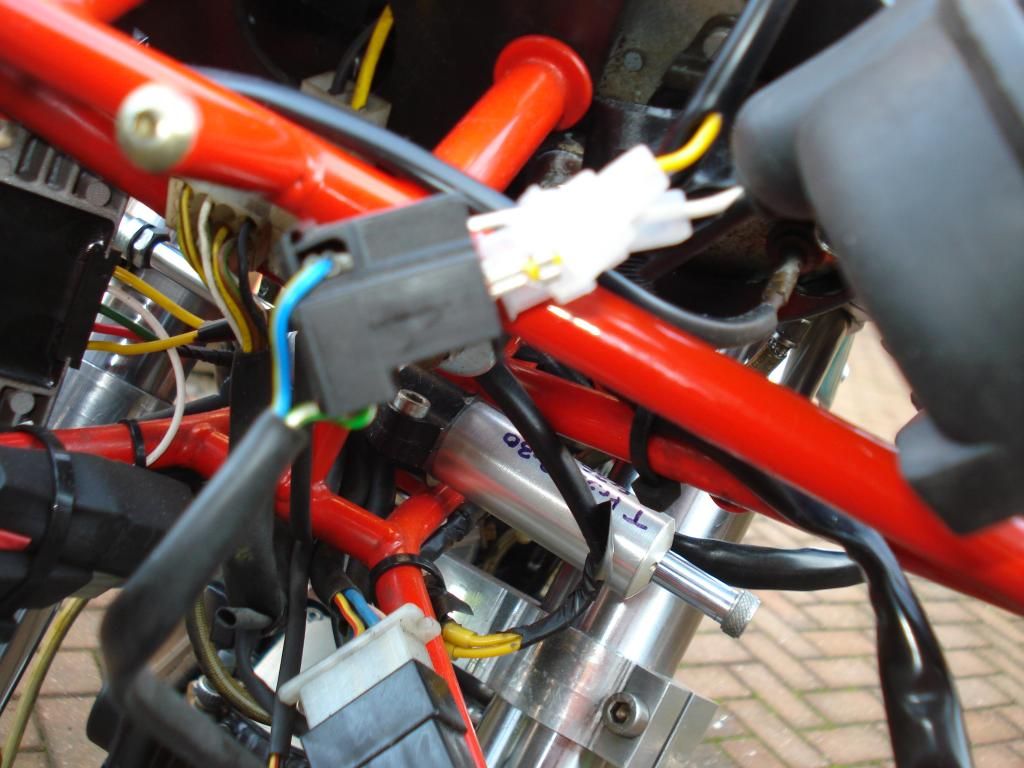

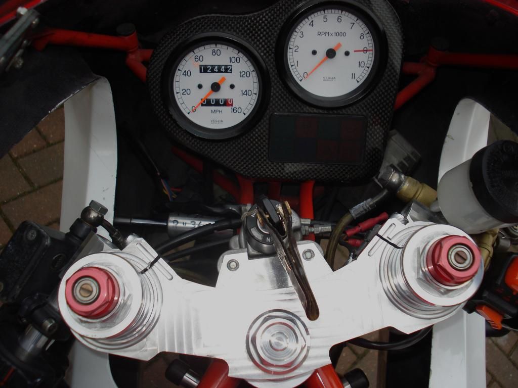

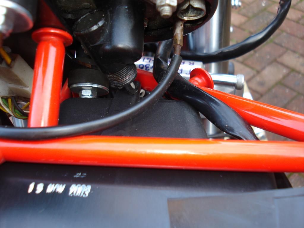

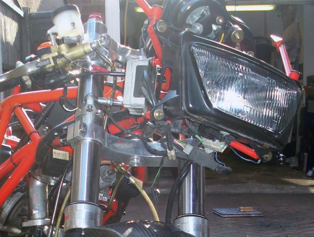

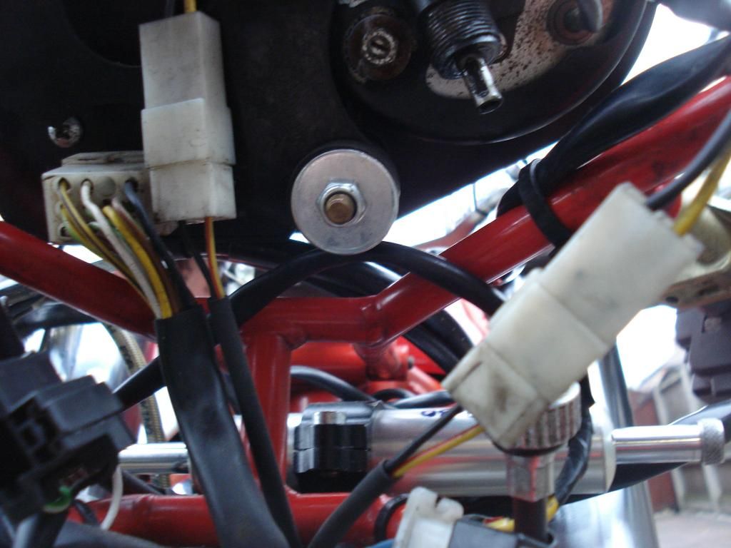

Posted: Mon Dec 08, 2014 3:36 pm Post subject: |
Anyhow....heres some piccies of the DB2 arrangement...that also shows the damper with the deeper DB4/Vdue projector beam assembly in place...didnt bother the damper...it was the speedo drive from the clocks that got blocked initially.....
And on here you can more clearly see the right side mounted bracket on the fork leg....between upper and lower yokes...

Thanks for the pics. If I decide to try to fit a short SD in the front I would give it its own sturdy bracket, not using the steel support (that did bend during the latest crash). If possible I could bolt the bracket to the two bolts holding the headlamp support to the headstock, thats sturdy enough.
A long SD on the LH side: if I can fit the damper body to the fork leg and the damper rod to the frame I can adjust it easily too. But I think I would need a 140 mm stroke damper and then fitting a long body to the fork leg is somewhat less elegant.
Looking at various db2's I'm starting to like them more and more....  _________________ Track riding on a Bimota: FUN!
