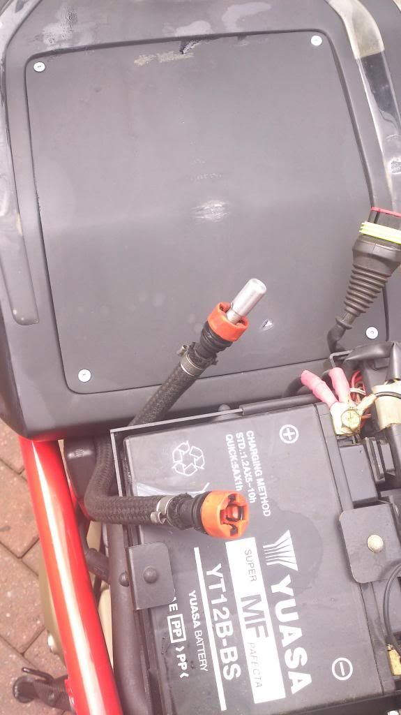

Posted: Mon Jun 30, 2014 9:19 am Post subject: |
Heres the connecters on my DB6
Dont ask me whats going on with the ally plug on the return hose...it was like that when I took it off the bike.......Db5 had 2 normal connecters...both push fitted into the tank..........and both a simple "pull" to remove from the tank |

Posted: Mon Jul 14, 2014 3:31 am Post subject: |
I had to pull things apart again, and this time the male end of one side broke off. I am not finding anything like these parts on the interwebs.
does anyone have any idea where these thing come from? _________________ Spike C.
1965 Triumph T100SC |

Posted: Mon Jul 14, 2014 4:10 am Post subject: |
is the plate on the bottom of the tank the same as that on Ducatis? _________________ Spike C.
Posted: Mon Jul 14, 2014 7:14 am Post subject: |
| I'll pop into my local Ducati Dealer today and ask them with the aid of the photos for you........... |
