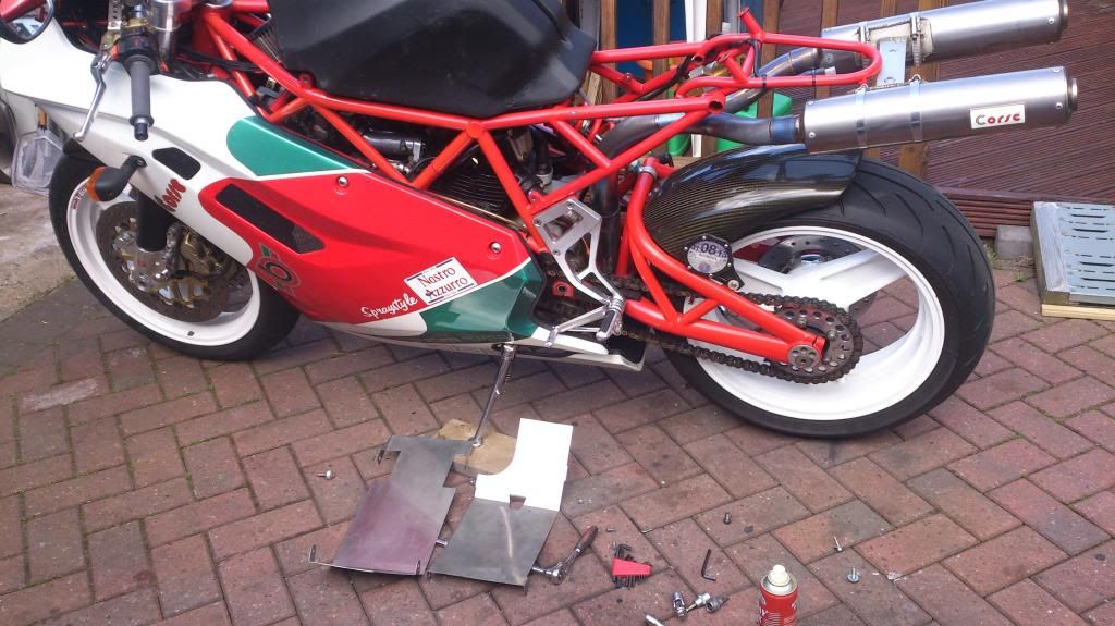

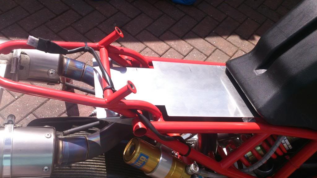

First thing was tank/seat unit off as I also had a hydraulic leak from somewhere that was running down the swingarm and dripping onto the rear wheel......and I was hoping it was rear brake related and not my trusty Rear Ohlins remote res..........

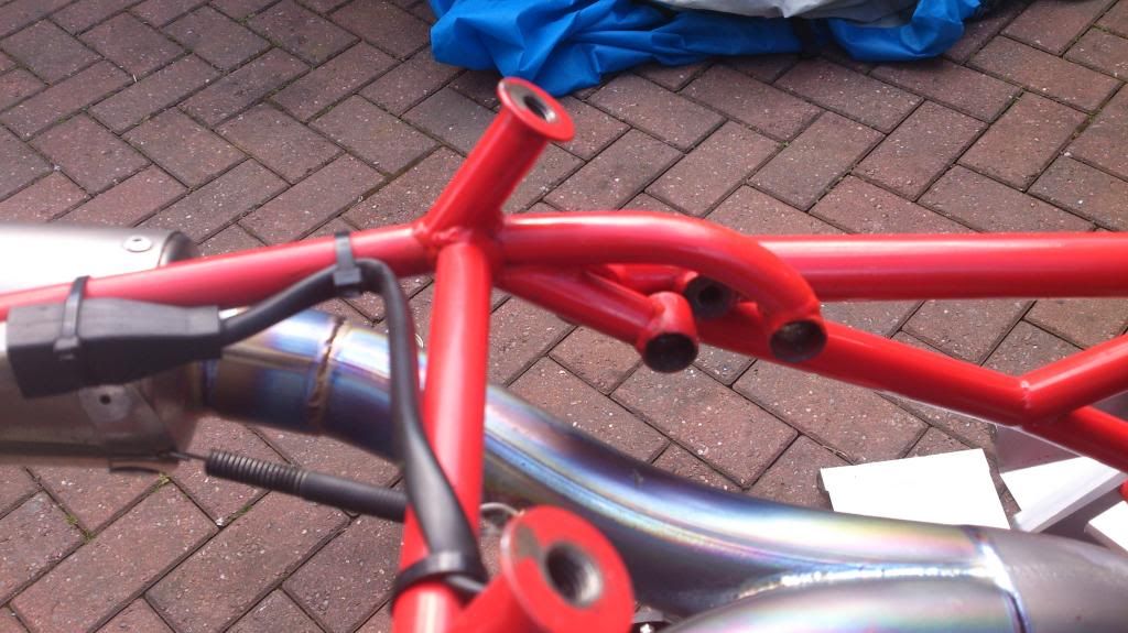

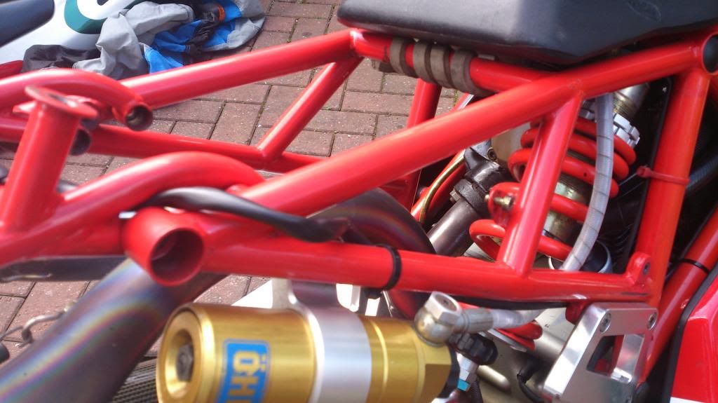

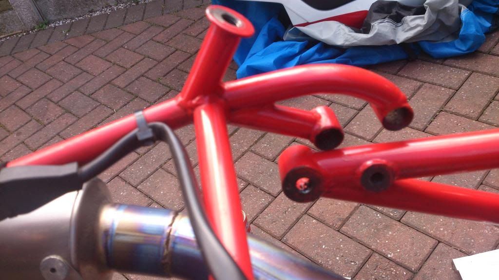

Then it was time to pull off the stainless steel heat baffle plates to get a good look at the rear shock also....which is when I discovered that the tubular rear subframe was only held on by 2 of 4 required bolts......Most strange....2 of the bolts fix from the outside of the frame and 2 others fix from the inside going out.........Now I know I had issues fitting this before as the heat baffle plates have tangs on them...bottom plate fixes to the front two bolts...top plate to the rear 2 bolts...and you have to ahve the top plate "floating" and in the air slotted under the rear subframe whilst you fix the front 2 bolts...the darn thing is a bit of a chinese puzzle and the sequence is just one way works and all others fail.........Do recall quite some time ago my local un-named dealer calling to ask how to fit the baffle plate....me now thinks they didnt figure it out and left both bolts out...Grrghhhh...quite sizeable bolts that they are also..and unlikely both would come loose and fall off...as when you sit on the bike they are under tension of your own weight.........Hey Ho.........
Fortunately the Remote for the ohlins...and the main body of the unit were all fine.....the top connecter of the back brake reservoir pot was beyond its best and the overlong connecting hose had seemed to swell over the years and no longer made a tight fit to the reservoir brembo pot...so off with the unit...and on with new line and new connectors for a nice snug fit once again...and back on with the clothes.........perhaps another day for the HT coils and leads........... |

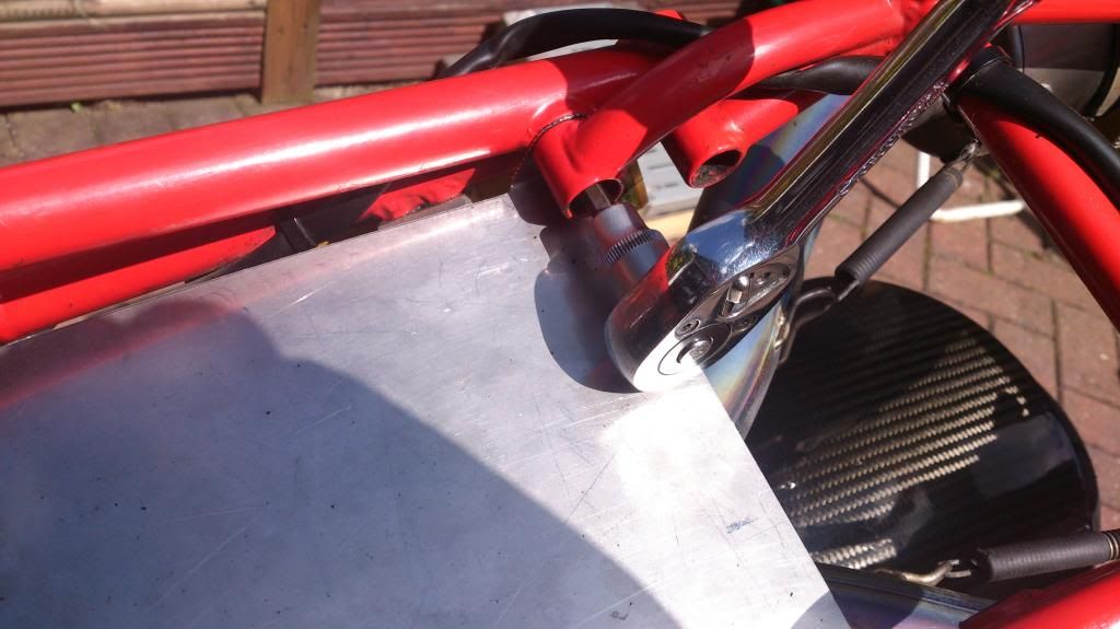

| Its is with these bolts now...and doubled up with locking washers and a good heavy twist wth a pry bar for triple measure.... |

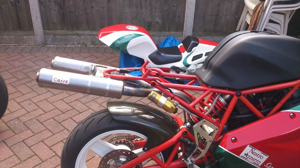

I'm with you on the dealer front also Brian......Grrghhhh....I do like the lattice spindle stuff...and still today.....people look at it and some think its new...and most go.."oh look...an offset rear shock...just like the panigale" to which I have to add...not quite...this was done 20 years ago and the rear shock doesnt hit your leg like on the Panigale..........
Bimota could have just used straight tubes like on my Duc 900SS....but then that would be more welds and not perhaps as strong or well braced...so yup...bends put in....and places everywhere for things to bolt onto....Only exception is the Corse rear cans that are SS Jubilee clipped onto the original cans mounting piece that bolts to the frame...but I've accepted those clips now as part and parcel of the look...especially given the cacophony of wail and noise they emit...pure music....  |
