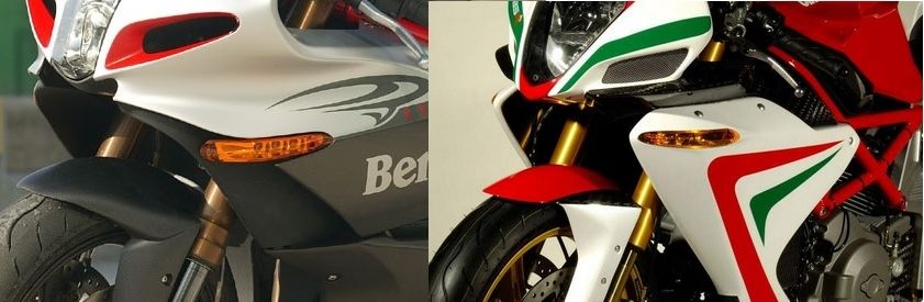

Does anyone know where to acquire one of these? I was parked on a headland overlooking the ocean and a gust of wind blew the bike over. The tank bag didn't help. The handlebar got bent a bit, and the right side turn signal lens got broken.

I brlieve they are Benelli Tornado, but opposite hand, so the left is fitted on the right and the right on the left, but don't take my word on it.

I think Vort is right, they look the same and the turn signals are placed backwards as you can see on the picture.

Yes they are from Benelli... the rear ones too

Benelli is just as rare here as Bimota! Bob at Bimota Spirit here in the colonies is getting one for me, he says. He has the toe piece for my broken shift lever in stock.

A Db5 owner over here needed a new indicator lens...and knowing they were Benelli Tornado Tre...ordered a left for his new left......Yes they are fitted backwards to Benellis...but also the left is the right, and the right is the left.....as they are shaped for left and right....one side will not fit the other.....
Always park into the wind if there is any...leaving the bike in gear....They are light bikes and yeh...a gust of wind can topple them

Bob at Bimota Spirit has ordered me a lens, and I have sent an order for touch up paint from provided code, thanks so much!
