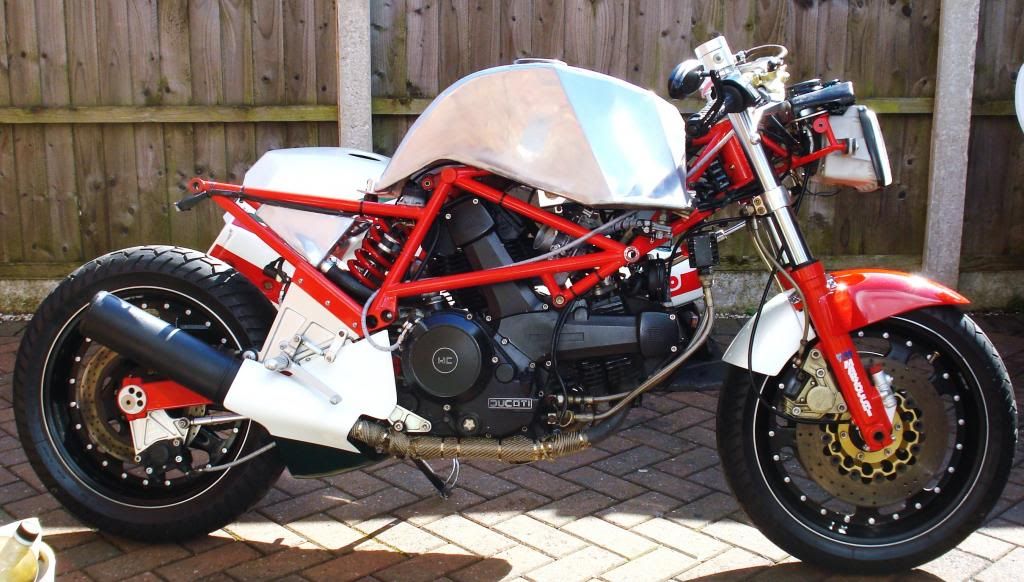

Mrs DB1 hasnt been wanting to start since her winter snooze..........and I've time on my hands so its striptease time..........well the clocks going forward gives me more hours and rain seems to have abated......Also posting here for another on here that wants piccies of bodywork...as they are doing one up thats had its bodywork hacked by an axe murderer.....
Ally tank off...........
Ally crankcase breather tank off.........may just leave it off and put a vented cap on the hose........all its doing is acting as a crud catcher to keep the rear spring clean
right ...thats the clothes off so now nakedness...........must have been bored as I counted theres over 30 separate frame rails cradlling the engine in total........

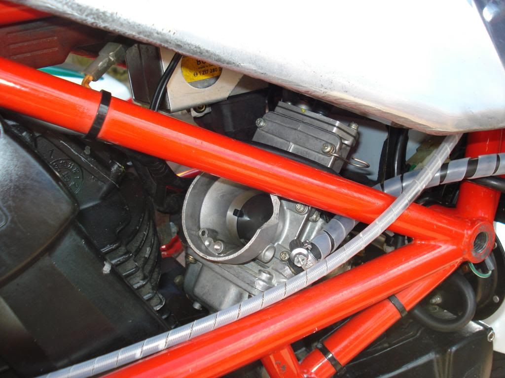

Carbs off ready for a clean........no airfilters at all as its running Mikuni square bodied 40mm flatslides.......

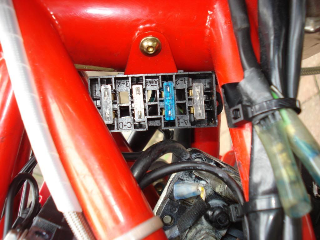

Not the best place for a relulator/rectifier...right under the tank...and the colouring matches no way no how the wires that go into it.........typical....bit like there being a fuse box...total 4...but no fuse box cover...........some things never change

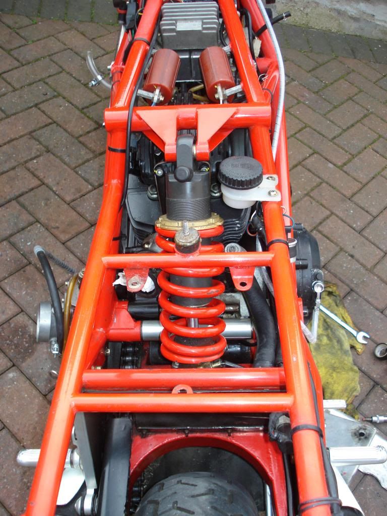

Well it was a lovely sunny day yesterday so the clean up commenced further........A few touch-ups here on there with the rear shock

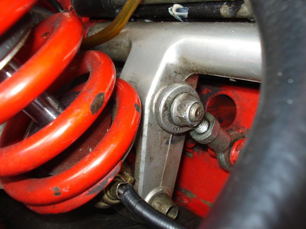

I've a spare NOS Marzocchi rear shock for the bike....but will keep existing for now but change the Knurled cabled remote adjuster as the other one has come disconnected from the shock to some extent...
Most of what I thought was either paint missing or corrosion turned out to be just muck...courtesy of the rear chain.......although there is a decent rubber "mudflap" that keeps most muck from the rear wheel at bay.......
Which is bolted to the rear swinger, and rivetted to a top frame mount....

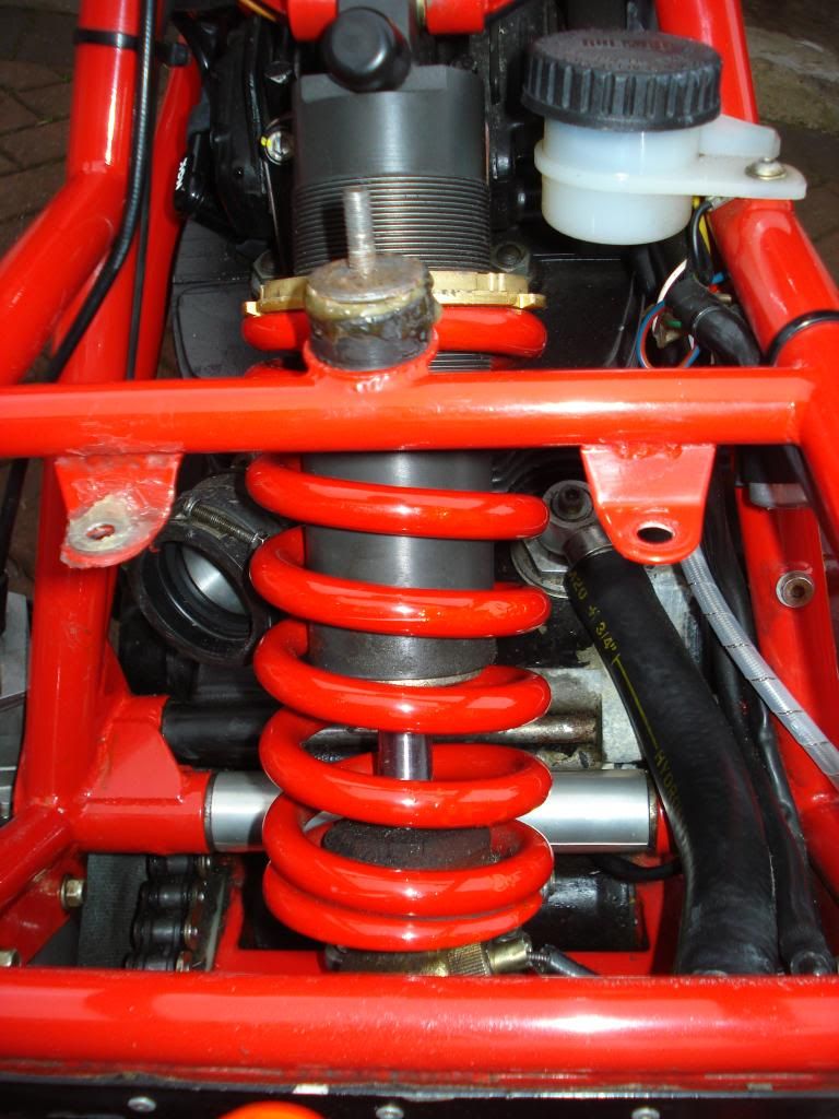

The back of the tank is held in place by a captive bolt and a top nut....Bimota could have used one of these...
(bottle of superglue for scale purposes...)
But instead they made one of these out of alloy....and you only see it when the bodywork is off.........Detail...detail...always with the detail even if unseen.....No wonder they were so expensve to buy when new....
Hardly "weight saving" but I know what I prefer.....
The Crankcase expansion tank did have a "cobbled together" bolt fixing that had been silicon sealed into place....whereas it should have 3 No. rubber wellnuts....so where was the missing third one??? Rattling around inside...so I had to go fishing with my needle pliers to find it and yank it clear...like getting coins out of a money box when you've no key to open it...

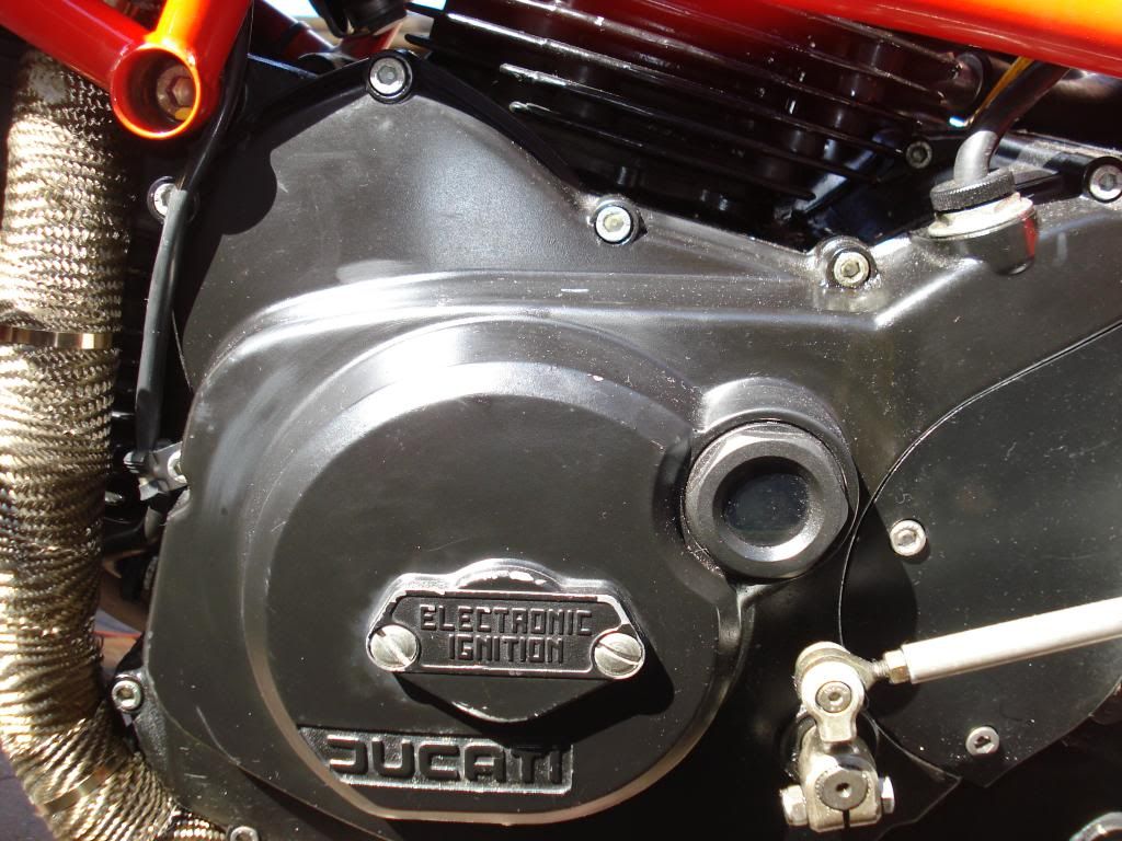

the rest of the bike is still pretty tidy. even the notorious Ducati Crankcase paint......

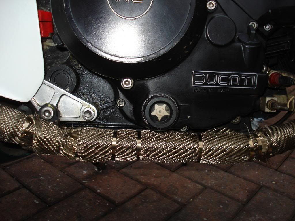

I've wrapped the headers in "titanium heat wrap" to safeguard at the temps that build up under the all enveloping body...

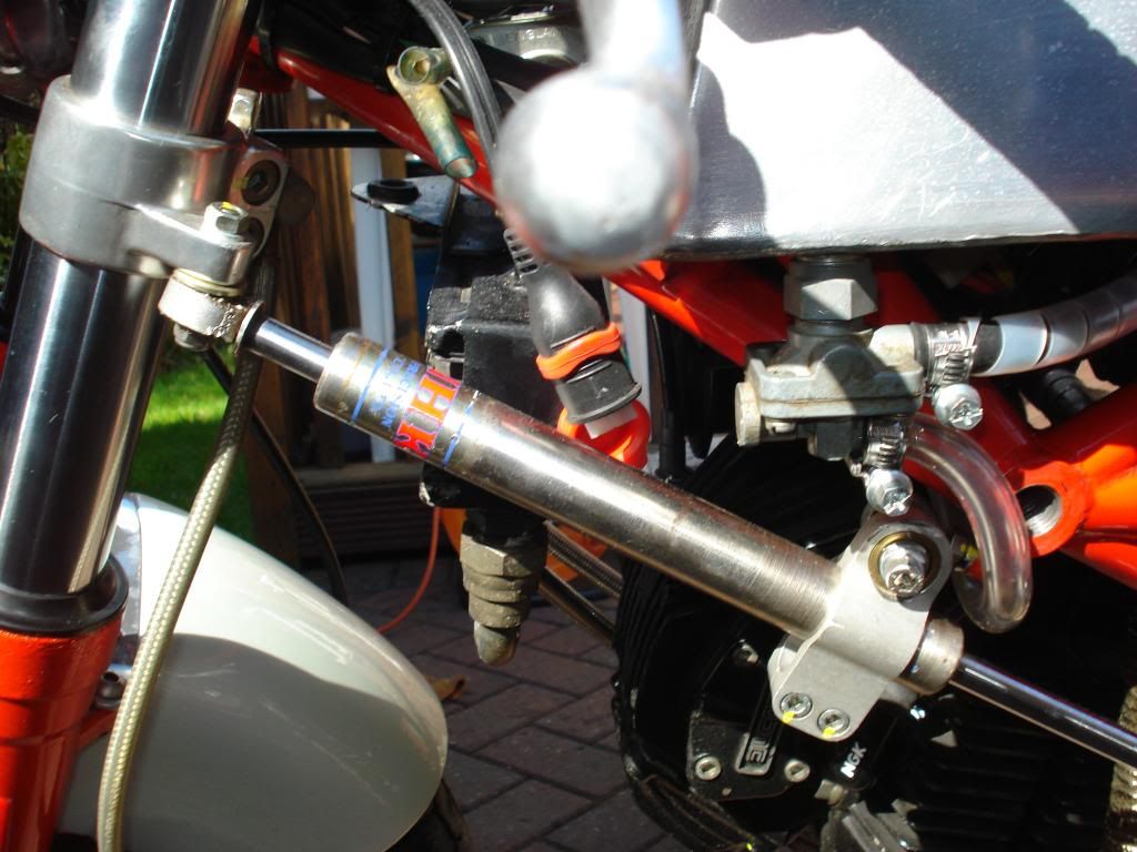

Fitted a spare steering damper I had lying around.....bracket was already on the bike for the frame mount and the lower yolk incorporates one already built in...just the damper that was missing........
I stripped out the carbs next for a full stripdown and clean.....as the low idle was not running right and kept fouling the plugs......separate carbs for each cylinder made it easy......note half moon cut out of aftermarket Mikuni square bodied flatslides to clear frame rail.......

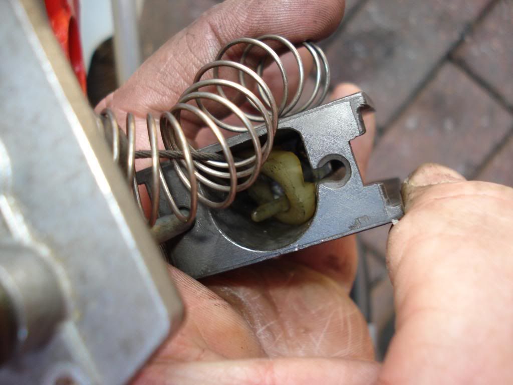

Trying to disconnect the throttle cables was a nightmare........integral to the flat slide....with massive slinky spring....plastic cover and then two tiny screws to remove the catch for the nipple....I gather when you buy they come as a kit complete with the throttle assembly already attached.........Grrgghhhh...
The bodywork and paint is already about as good as you can get...a couple of gelcoat cracks appearing from the occassional ride that I should expect.....and the frame and engine werent as bad as I was expecting...so I reckon another season or two of riding before I consider a full strip........
