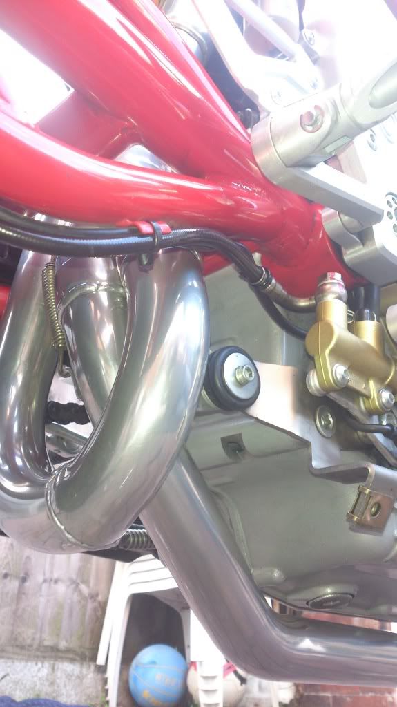

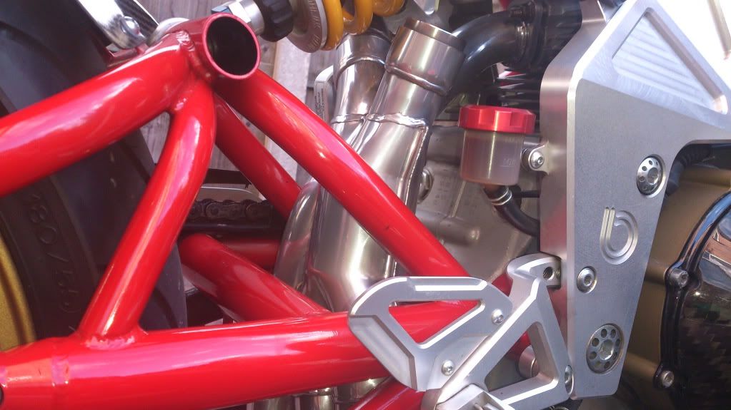

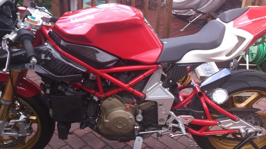

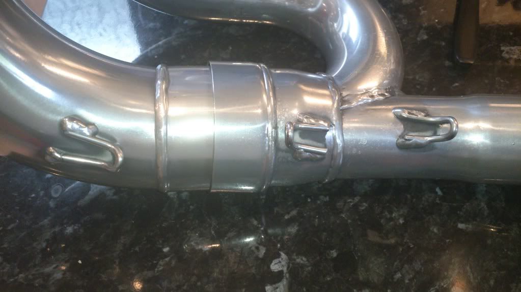

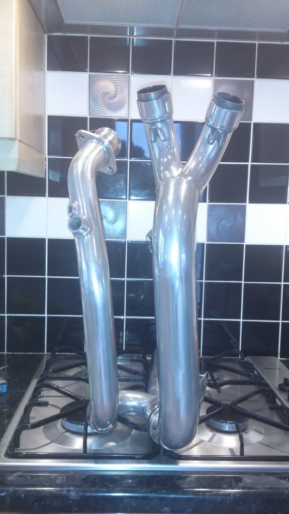

New straight through race series (cat free) pipes from zard received back after receiving shiney, fit and forget ceramic coating, inside and out...nice finish...2 sets done, for db5r and db6r..

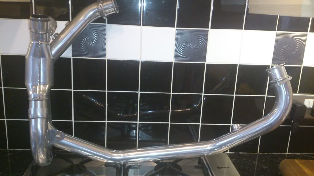

Pipes are "normal" stainless steel pipes direct from a lovely Italian lady at Zard italy, who speaks, reads and writes English....sold me directly the "open" pipes that have no Catalytic converters...still have lambda sensors in the front and rear headers, so the rear header needs a blanking plug as theres only one sensor on my Db5 and DB6....but 4GBP of SS blanking plugs from ebay solved that one...fitting the Db6 pipes at the moment....pipes didnt come in that finish, they;ve been ceramic coated inside and out to stay cool and clean....delicate stuff when fitting as they scratch easy but can be polished back...seen a Ducati that had it done a while back and his were 4 years old but looked like new...has a shiney polished alloy look to them....Will post up pictures when finished...you have you use your own cans,,,but if interested I can pass on details of the nice lady...took around 3 weeks from ordering until delivery...

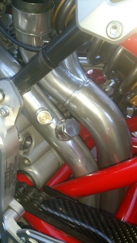

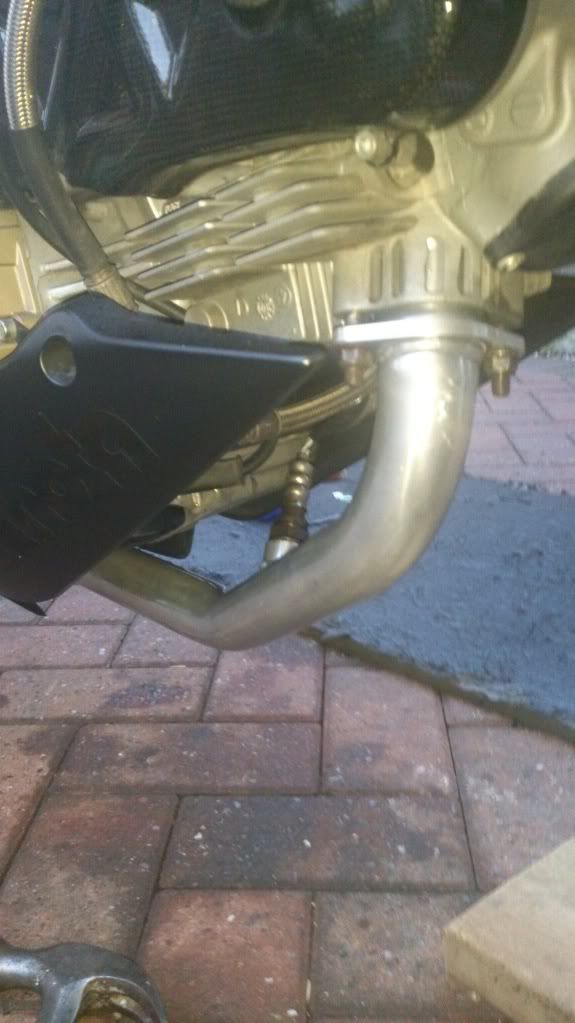

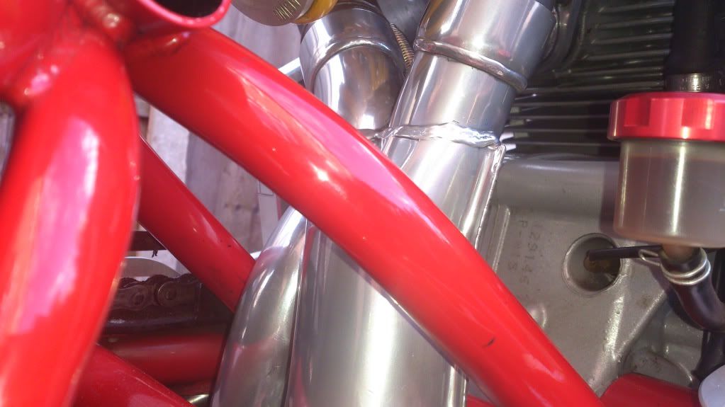

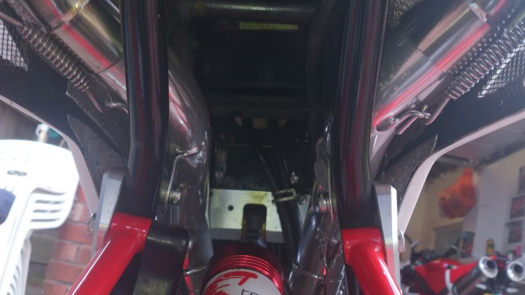

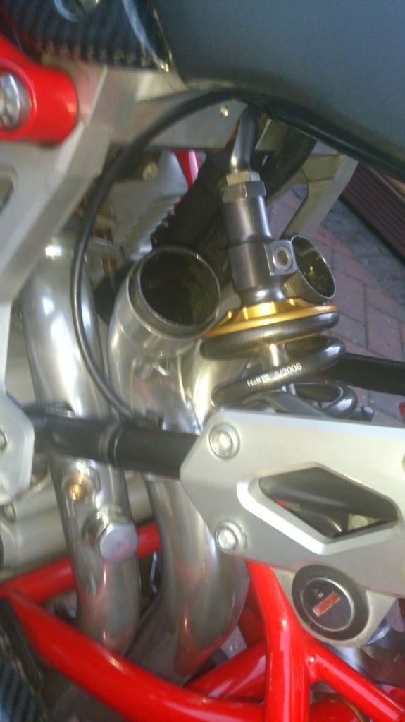

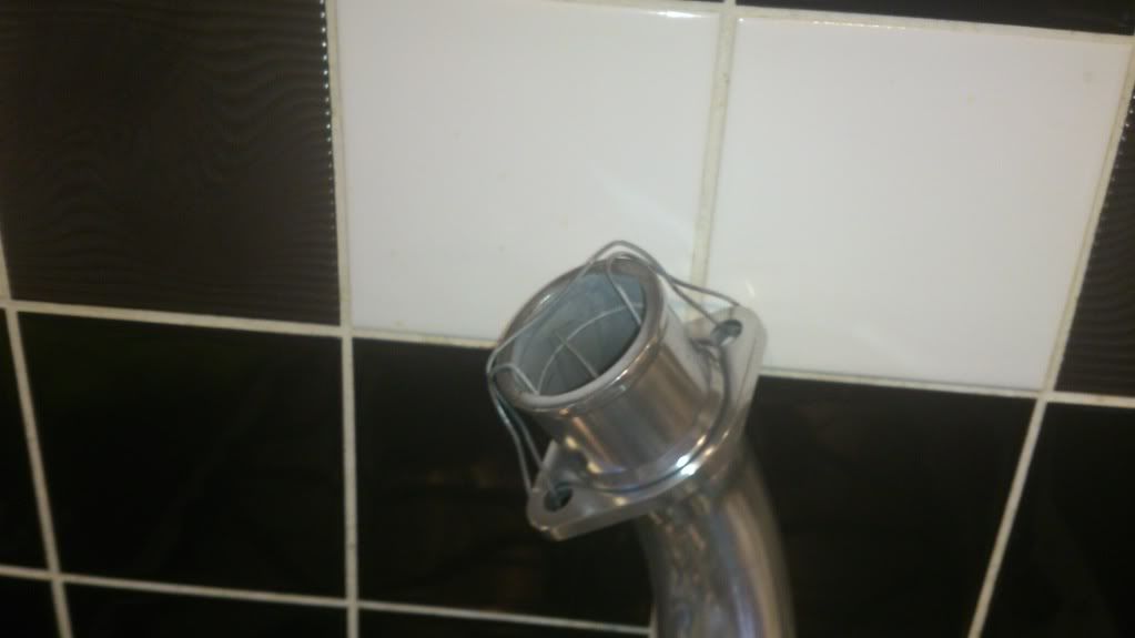

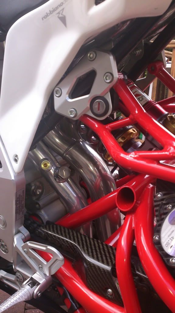

And heres a few shots if part fitment onto db6r first, as that was part stripped down already...ss polished blanking plug fitted into rear header, as theres only a lambda sensor on the front header..

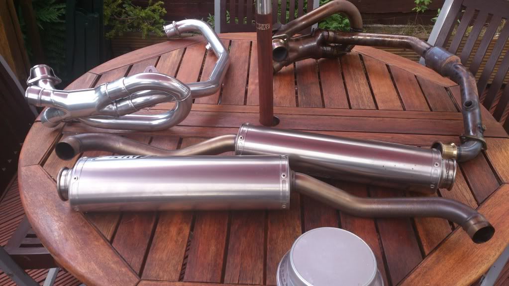

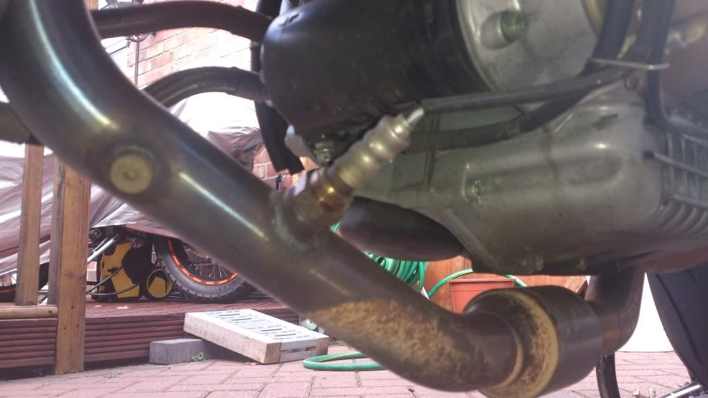

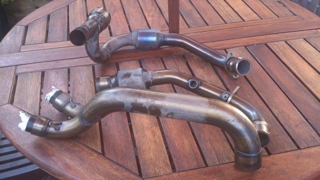

And heres the old pipes....

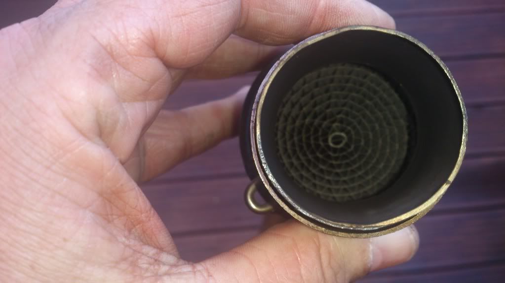

And heres one of the 'offensive' cats on the old system

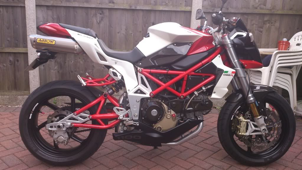

Now just got two more link pipes, two end cans, a rear subframe, bodywork, electrics and seat to refit....then its Sound of Thunder time Laughing ....oh and same repeat process for the db5r also....

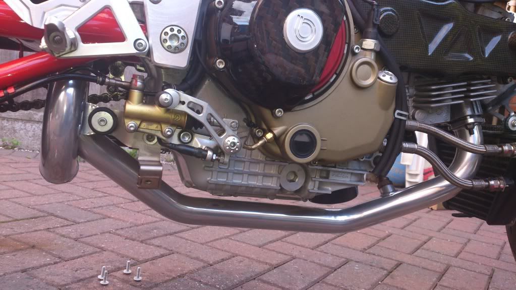

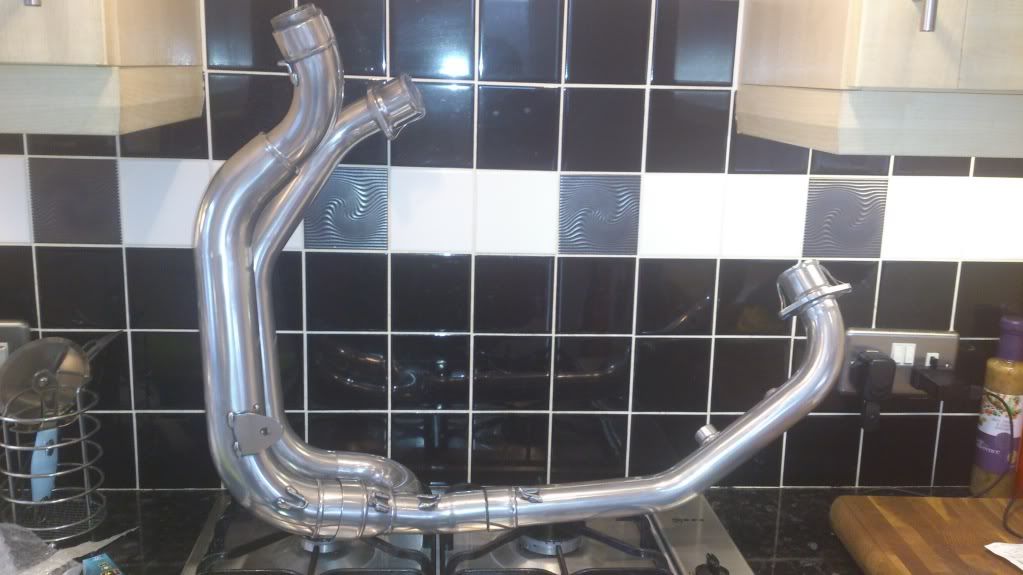

As regards pipe envy...I was so impressed with the running after on the Db6R that I promptly rushed to fit the same to the Db5R also...

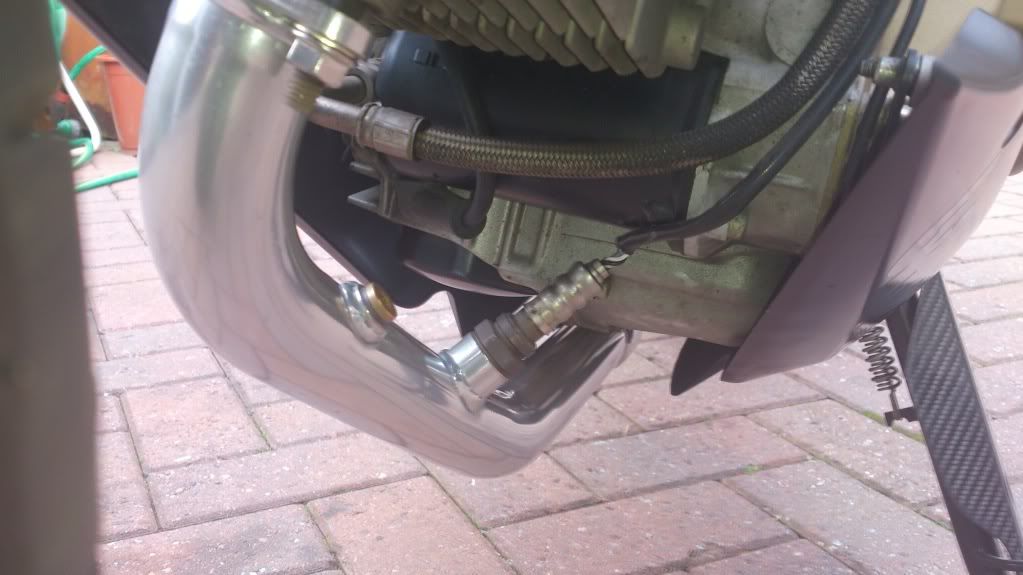

DB5R before stripping and during...
Old and new systems weighed....5.5 Lbs for new system, Old system with cats 6.5lbs...so even with ceramic coating inside and out, a weight saving...

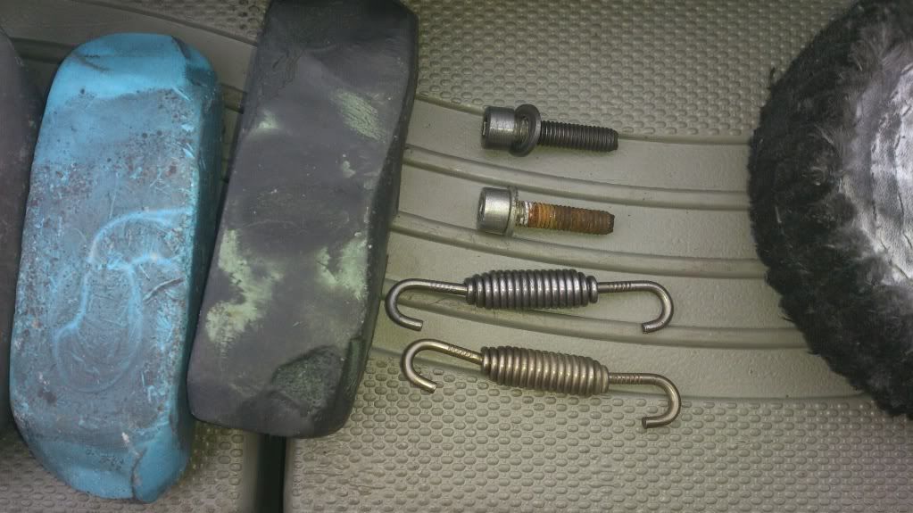

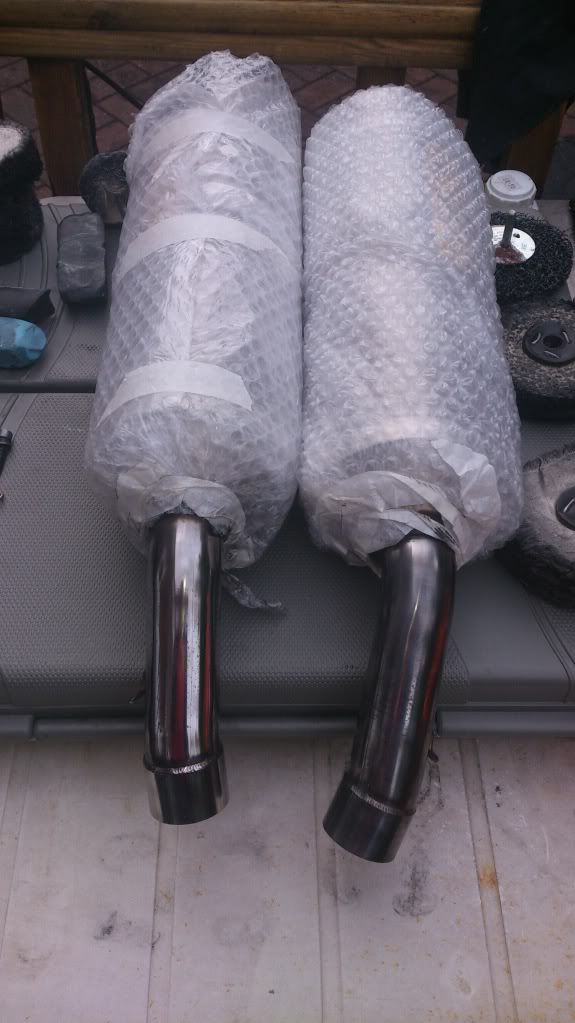

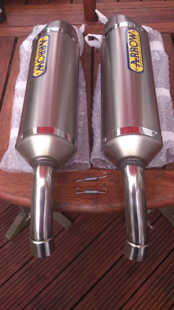

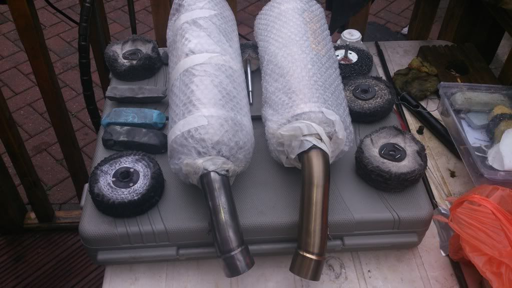

And As i'd fitted the pipes to the DB6, I decided to buff and polish up the exposed start tubes for the End cans also, complete with springs of course...Can on left after first stage, can on right fresh off bike, no work done yet
First mop of coarse and grey wax done on one, other unfinished yet
And then the softer mop with green wax, followed by the final soft mop and blue wax..

Now I fancy doing a few others...Db1 first though, but in black, satin, to get some heat out from under the bodywork...have to say am impressed, after a run and cool down of five minutes, you can grab and hold the headers...yet the tail cans cant be grabbed for anything like the same period...
