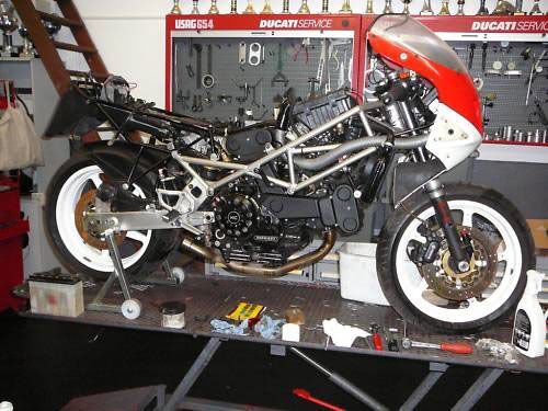

as the follow on from the DB2 rebuild.

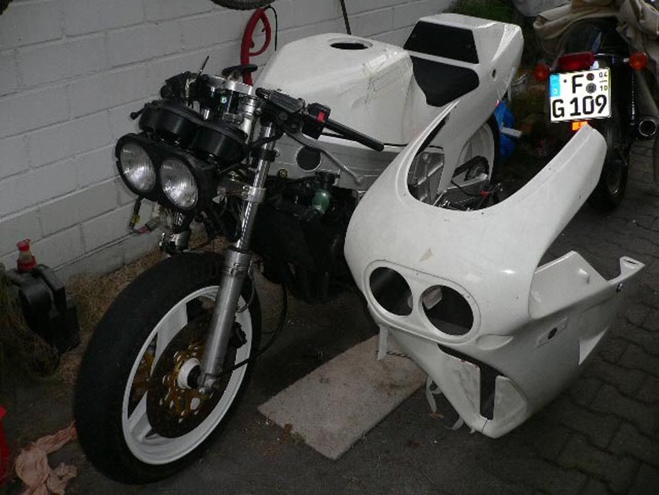

Here's how it looks now.

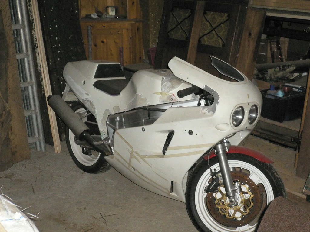

Restoration imminent, as I've found all the missing parts including a new YB8ei wiring loom (which will do the job).
Looks much worse than it is because I’ve just ground away all the cracks in the paint and fibre glass. After repair, it’s off for an original paint job. I lived in a paint shop for 5 years so I should know my way around that one.

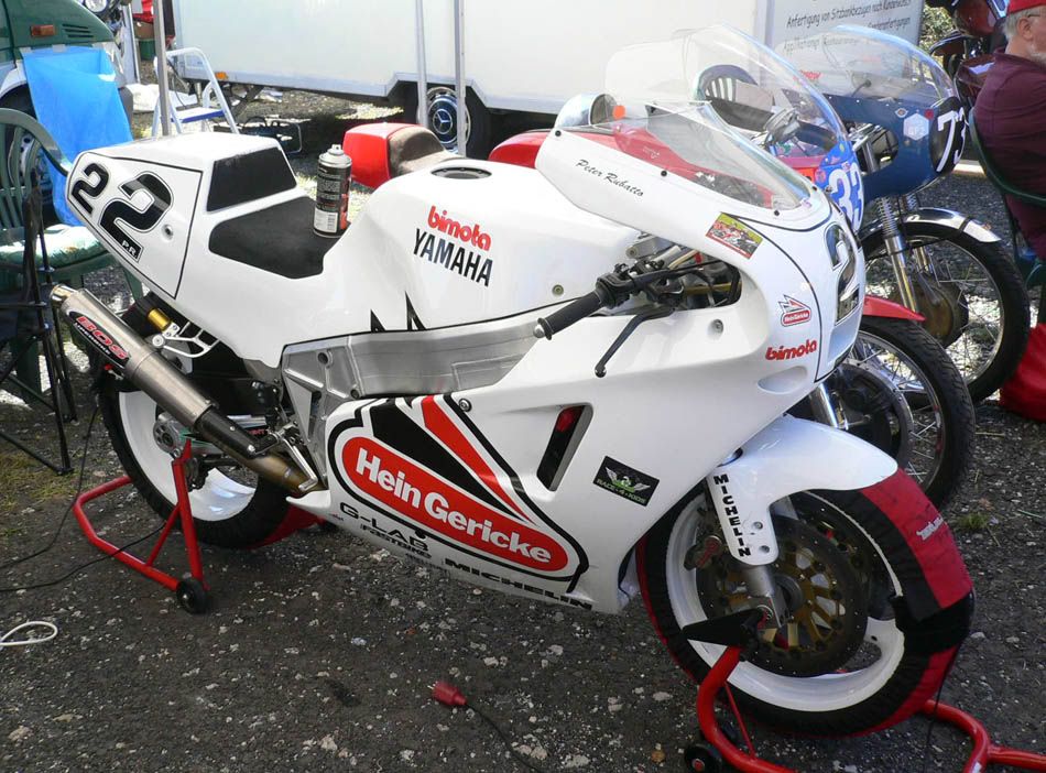

And here’s an interesting find at the Schottenring oldtimers GP last August
A German Superbike YB4 being paraded by it’s rider/owner Peter Rubatto, doing wheelies out of every bend on the tight street circuit, brilliant. And it doesn’t look too disimilar to Brigittes bike in mono white.

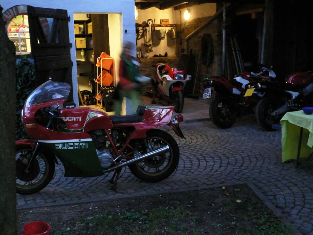

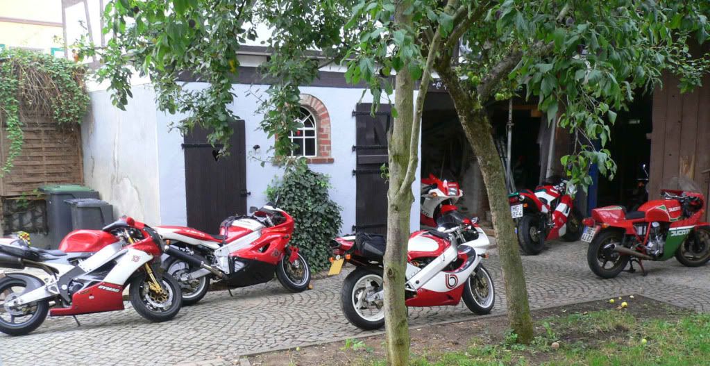

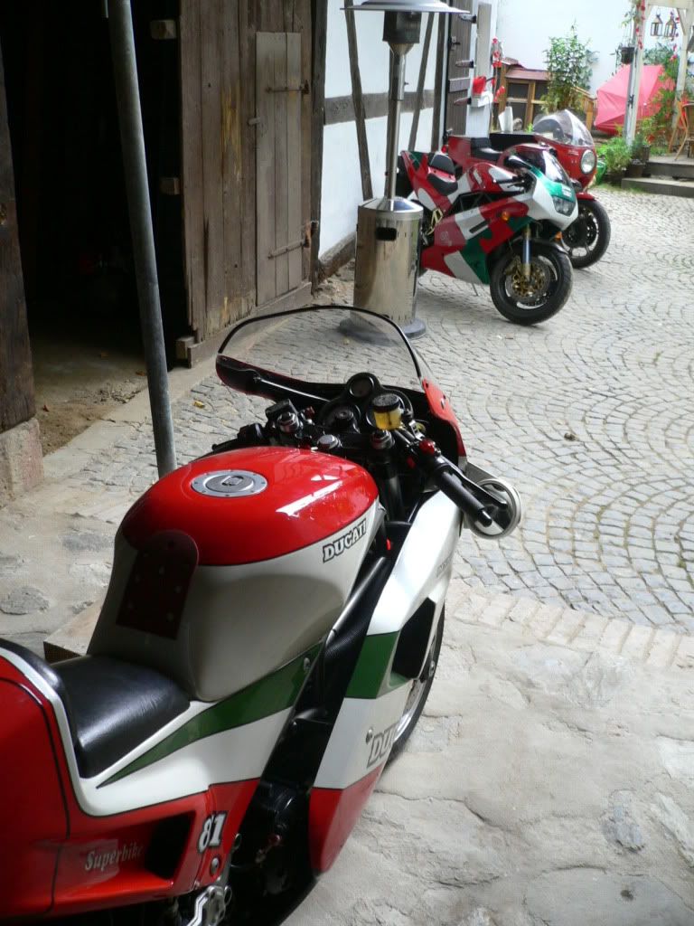

shouldn't have too many non Bimotas in here, but where would all your Tesis, DB7s and so on be without this happenning first?
and I know Pompey won't mind this because he's got one too- excellent taste. Show us your new blade Pompey.
first owner was the Mercedes Benz racing department, obviously showing renewed interst in desmodromics. It got some nice updates, such as cutaway airbox lid, the modified headers and exhaust cross over, I suppose they did the other updates on the factory sheets too: 0.3mm head skim and port mods as the engine has obviously been apart. I picked up some kit pipes last week for it, for which I'll need a new chip only to find it's got a replacement chip already. It also came with 17" Marchessinis, which I prefer not to use, so I'm sorting out some later Ducati wheels to put on. I've got a pair of brand new 16" tires but it's no sense to use them as there aren't anymore.
A Mercedes employee bought it off the company who used it very little and stored it until I got the chance to buy it. Still only 6100 km on the clock.

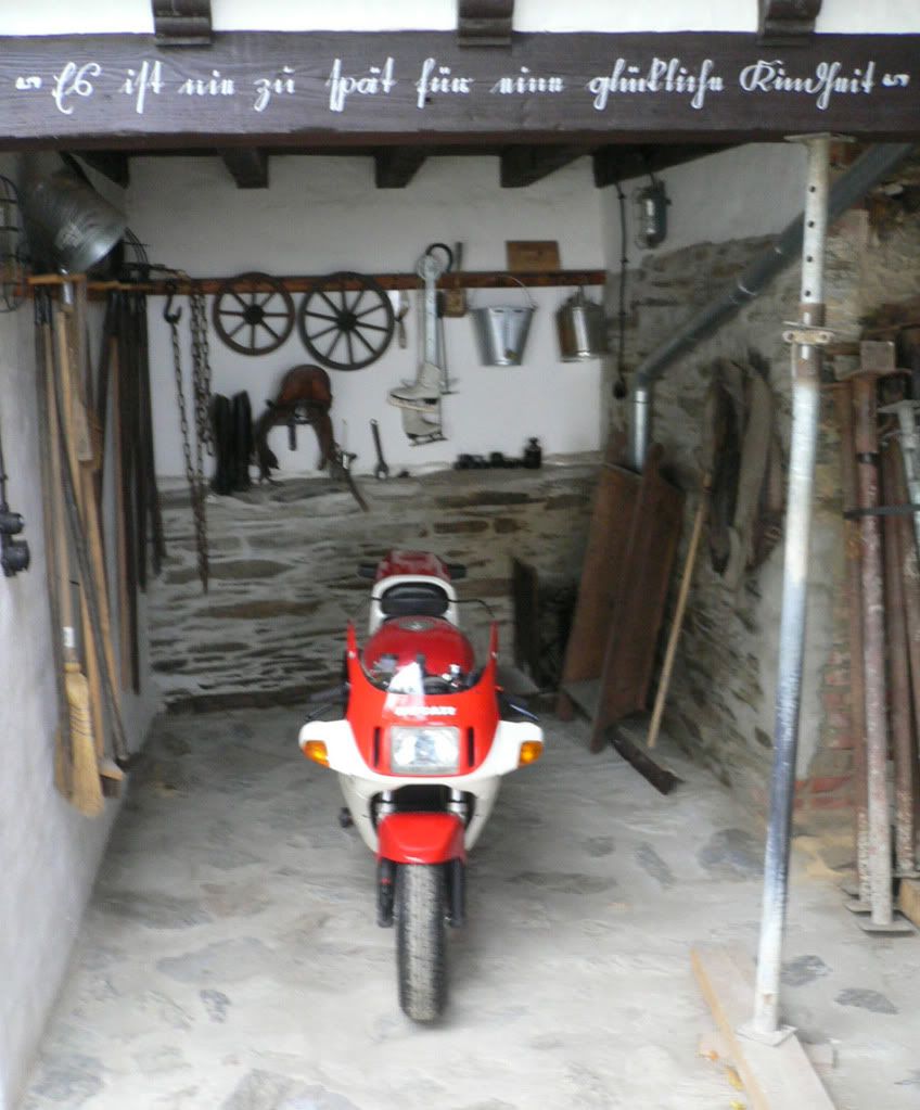

The writing says: it's never too late for a happy childhood- too right.
That's what I like to see, plenty of nice gear, other Bimotas courtesy of Andrew, John and Howard.

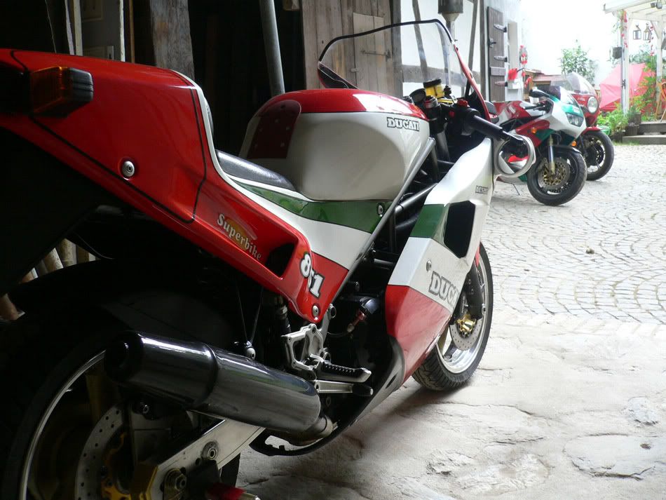

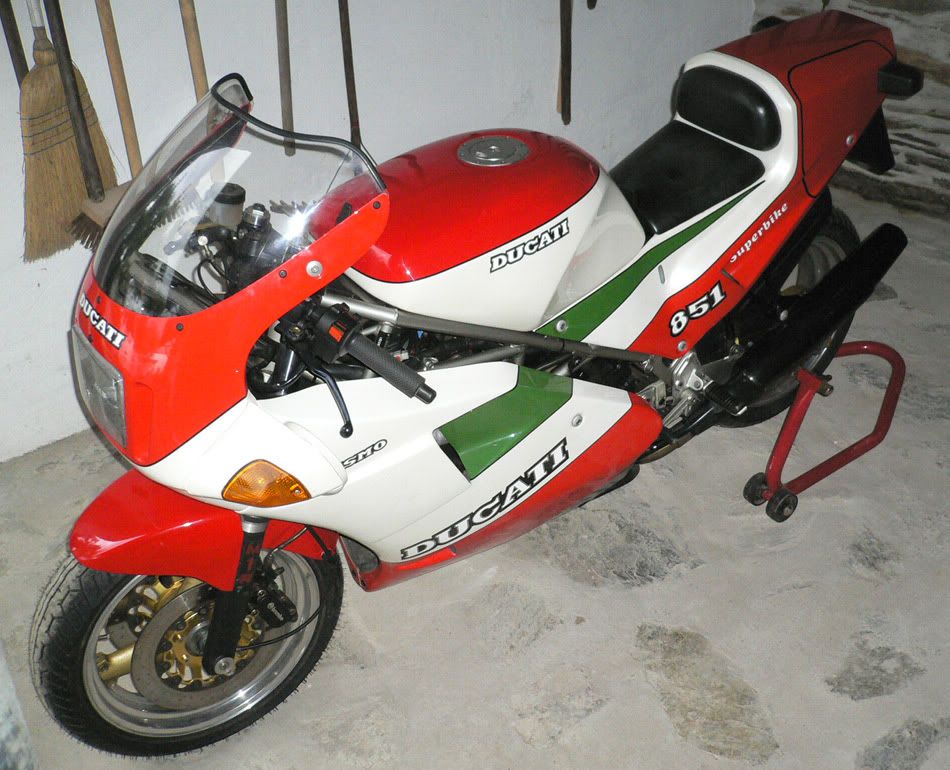

Love the kit! My 851 is a world endurance 93 model. It's having a full strip rebuild as I speak. I could do pics? My other 888 is a later sp model but the kit gets the vote in the looks department and it's the first of the line so great asset. I have to say I do fancy a yb now.

Alright Pompey, always game for some 851 pics- could always put them on the other forum I suppose if we're going too much off track. I'm '851 tricolore' over there. If anybody else is interested or doesn't know about it: http://www.ducati851and888.com/index.php is a brilliant petrol head site.
And I still want to see a pic of your new blade- I think early blades are deserving collector status now, must be original and unfiddled with though which will be a rare thing.

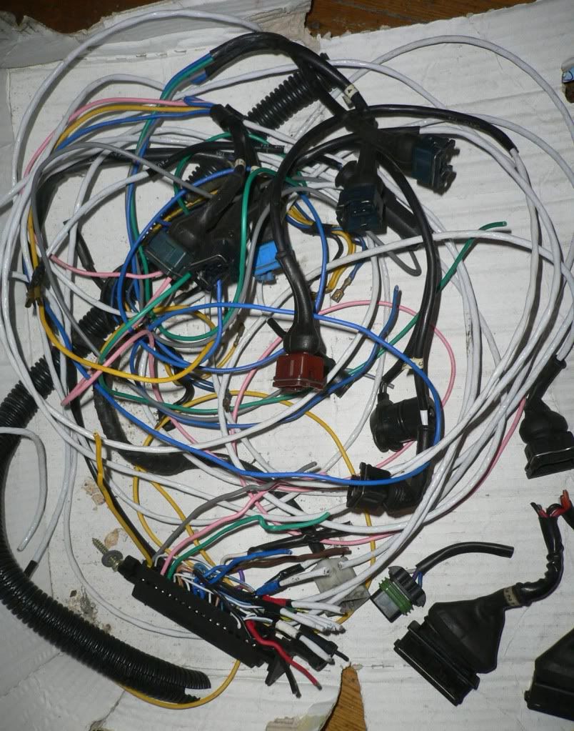

Here's a pic of a modified wiring loom:
I think I've got all the cut off bits, sensors and so on. The wire for the phase sensor on the cam cover has been cut off flush- very neat, but I've got one from a Ducati 851 which should be the same, just need to make sure the clearance to the cam is between 0.8 and 1.3mm with plasticine I suppose. The new YB8ei loom should fit because all of the components are the same and there's the same number of connections to the ECU in the same places.
Can anybody tell me if and how the EXUP valve on a Furano is connected? maybe I have to do something about it. But then again the YB4 loom is one piece incorporating lights, clocks, switches etc. This loom doesn't have anything for that, so I'll have to splice together a bit of Yamaha loom that I've got lying around.

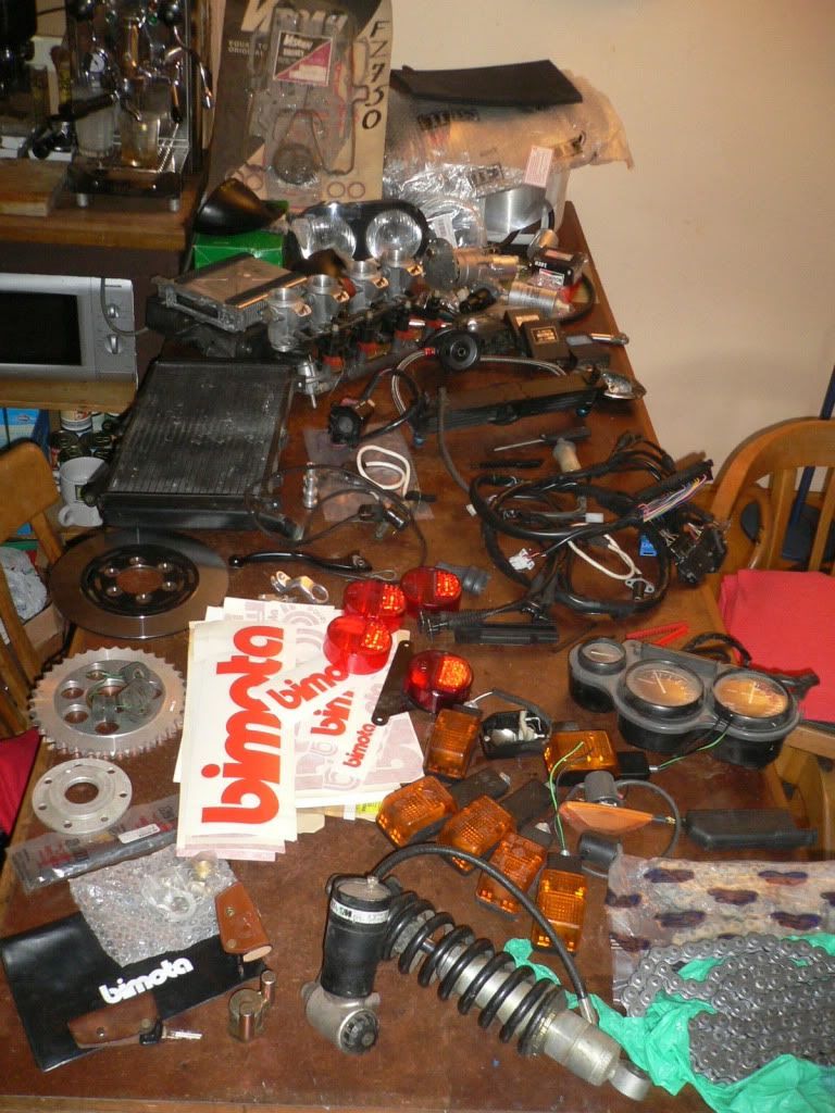

Here's my spread- not everything here, the other front indicator is on the bike and I know I've got some original style footrests somewhere- probably in my DB2 boxes.
It will be great to finally fit on the cool injector gear which I've had lying about for the last 5 years- doesn't time go quickly?
I've managed to accumulate 4 sets of headlights (same as early Aprilia AF1 and Gilera RC600), 7 rear indicators (same as DB1) and some meaningless stuff like an extra rear torque arm. As well as this lot, I also have 2 more sets of front brake calipers, another set of front discs (same as the DB2) and a spare number plate light- you never know.
But also some very nice stuff, the 4 into 1 was bought from the motorcycle company in Holland because the original had been modified (cut in half), spare radiator with all the brackets in good nick, rear light lenses that don't have the clear number plate lense insert and an original style rear reflector- (also same as the DB2).

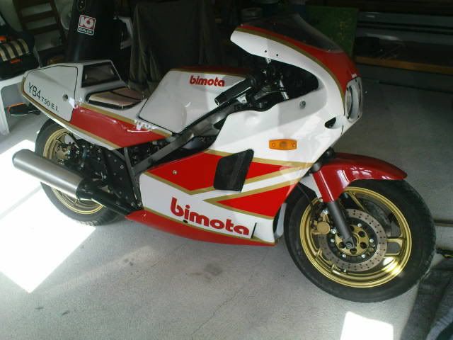

Another old pic, just after we (alright then Brigitte) bought her, already got the front subframe on which I bought in the local classifieds! unfortunately it only has the headlight fixings, the clock and fairing supports have been cut off, but they are reasonably easy to replicate.
and a front quarter shot how she stands now

I've got a nearly complete wiring diagram for the YB4 that I created on CAD, if you pm me an email address I'll get it across to you.
I bought a new sensor for mine (magneti marelli), I'll get the brochure out when I get home and send you the contact info. IIRC they were fitted to old F1 cars.
There isn't an EXUP valve on my YB4 Smile

I've already found the missing air temp sensor, new in 'bay, looks to be the same as Cosworth Fords and Lancias, costs about 15 or 20 euros.
Trying to sus out where everything on the YB8 loom goes, one wire must be for the exup servo, I suppose I can just leave it disconected- your diagram will surely clarify a lot of things.
I hope to be able to attach the YB8 loom- just for the injection system (which is all there is of it) and cut down an FZ750 loom for the lights, charging, clocks etc.
Looks like that's what Bimota did, as there isn't another loom mentioned in the YB8ei parts book.
