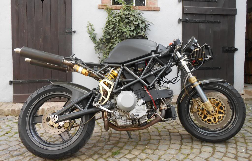

naked photos
needs to be street legal- so I'm going to make a very minimal seat unit- just enough to hold the licence plate, indicators and a rather natty 1960's BSA tail light with fins on it.
Then some fixings for the front indicators and maybe some mini mirrors clipped onto the ends of the handlebars.
THE CRANKCASE. COM logos on the tank, for that professional touch . .
Actually a Manx Norton style tank strap would be nice to hold the tank on properly- aqcross the tank between the airbox and the tank for a 50's cafe racer touch.

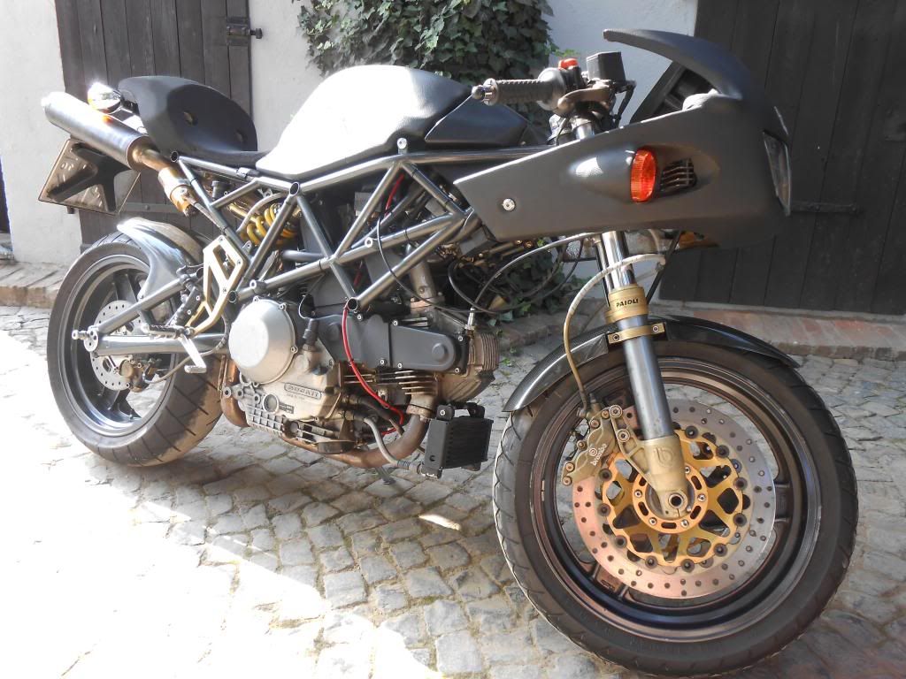

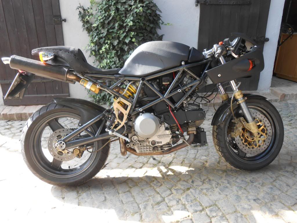

well, it's not completely finished, as usual, still need to connect up the electrics and a few detail things- mirrors not arrived yet.
But the application deadline is this week- so I took some pics and sent them off.
I'm convinced that I won't get in because I just found that the bikes should be 'classic styled' so my 'non round' headlight is going to kill it ?
for all it's worth,

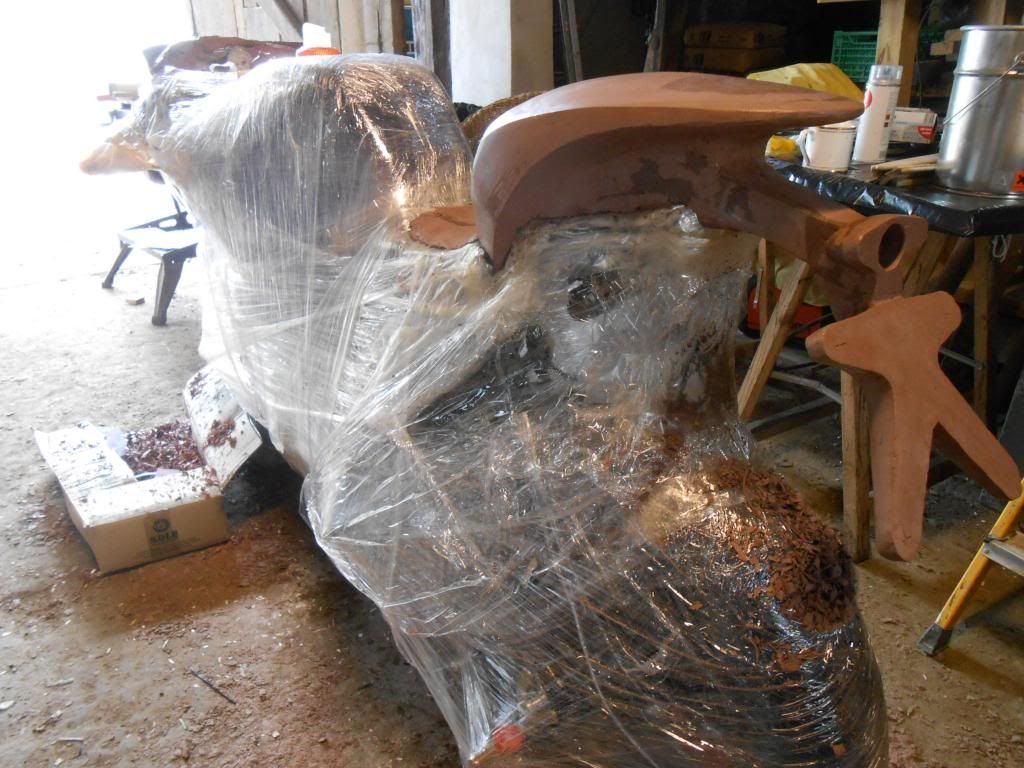

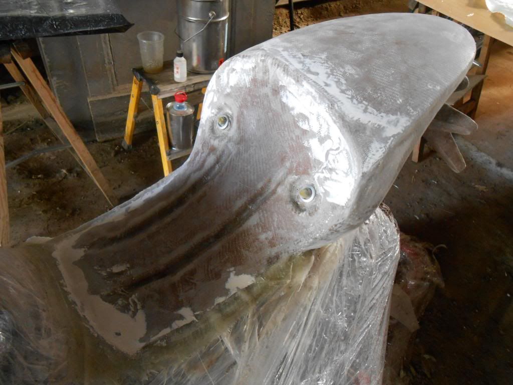

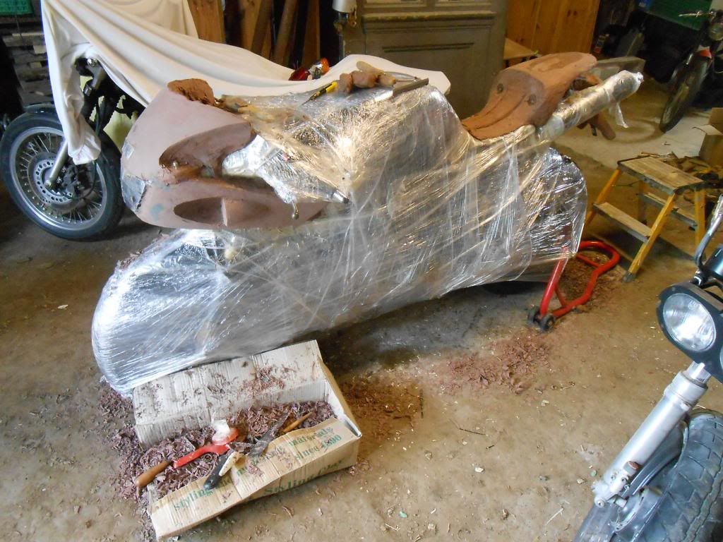

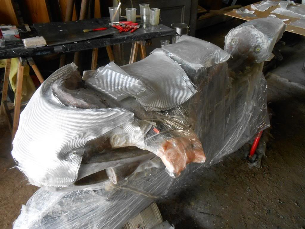

how I made a cafe DB2 in 3 weeks . .
wrap the bike in clingfilm, always a good start.
get some modelling clay on
3 days of modelling

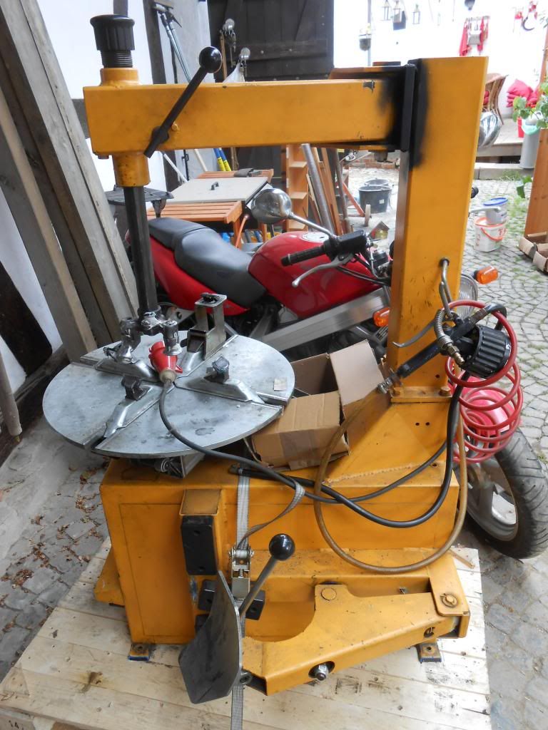

tyre changing machine turns up- brilliant
layer of fibreglass tissue with resin to get a base
filler and sand between the layers to keep it smooth
prepare all the glass for the next layers, woven drapes better.
do that for a couple of days or until you run out of resin and have to order some more.

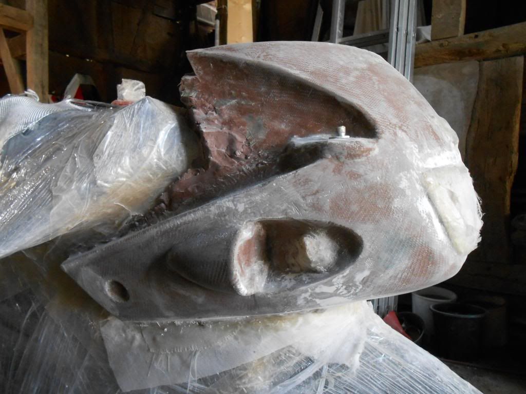

rip the bits off and dig the clay out from inside
try them on for size

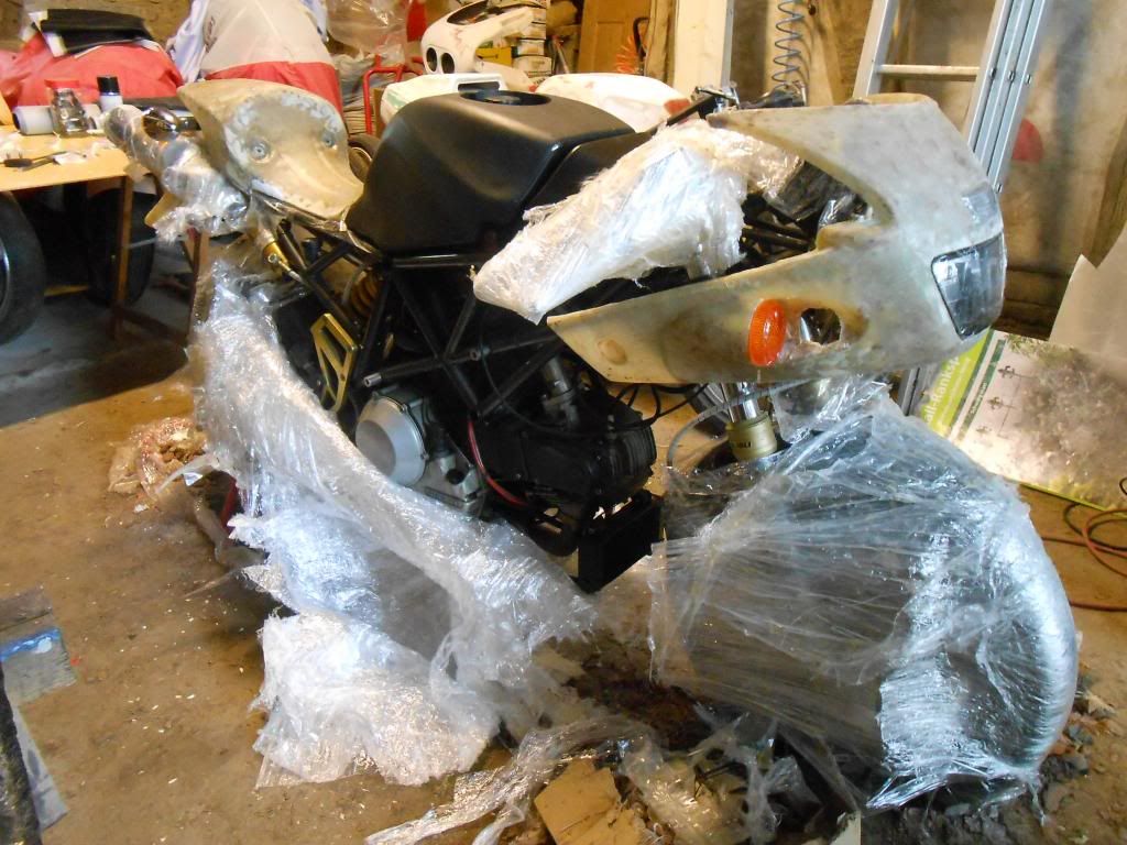

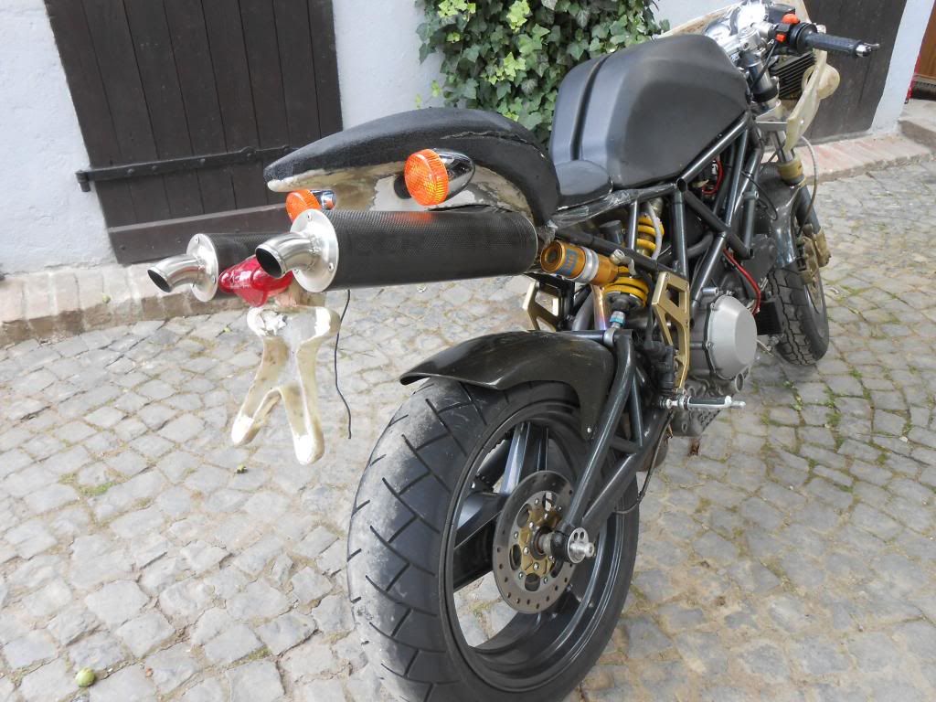

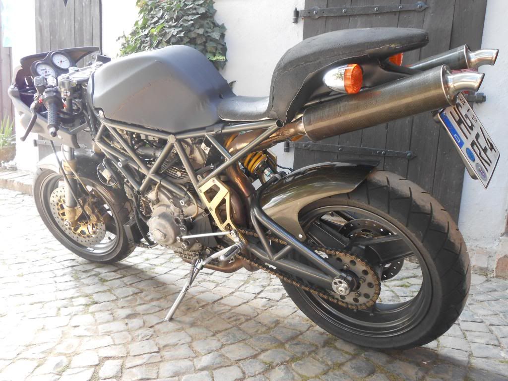

in the meantime start covering the other parts with seat leather- because I decided that's how it's all going to be done
push the bike out to get an idea how it's going to look

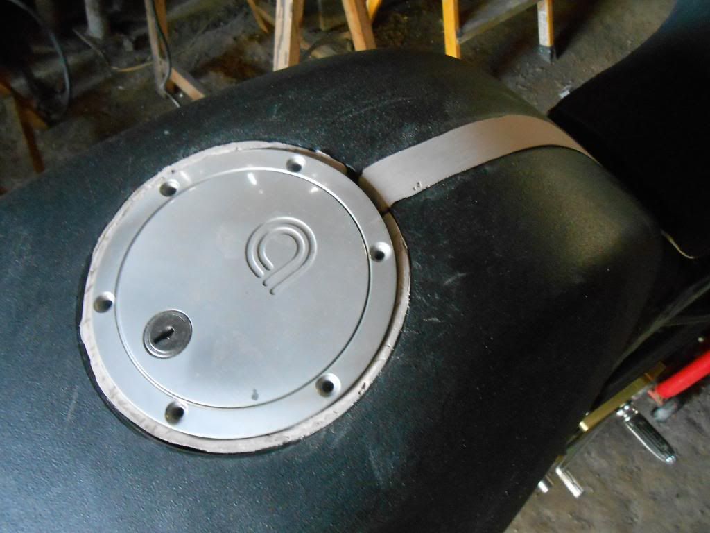

make a plug in the filler hole for the filler cap before skinning up

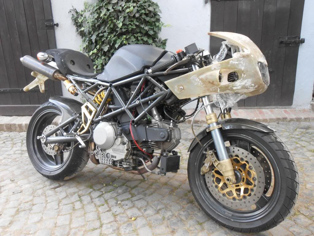

and that's about it really, haven't covered the seat yet, because the suede imitation that I bought doesn't stretch, so there's going to have to be some stitching going on.
And I would like to do the tank again because I did it on my own- with a couple of helpers, we might be able to stretch it down a bit further and avoid the cuts on the side of the tank- looks worse in the photos than reality, but it really should be better . . .

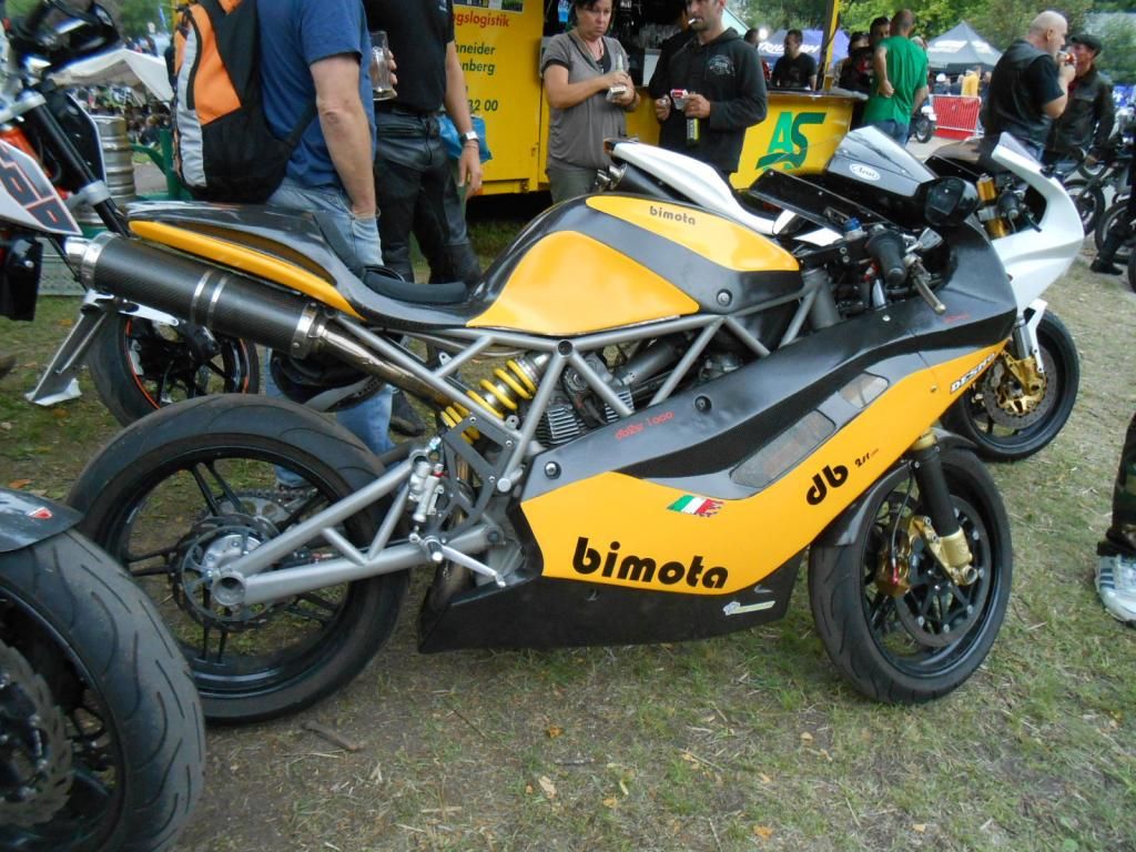

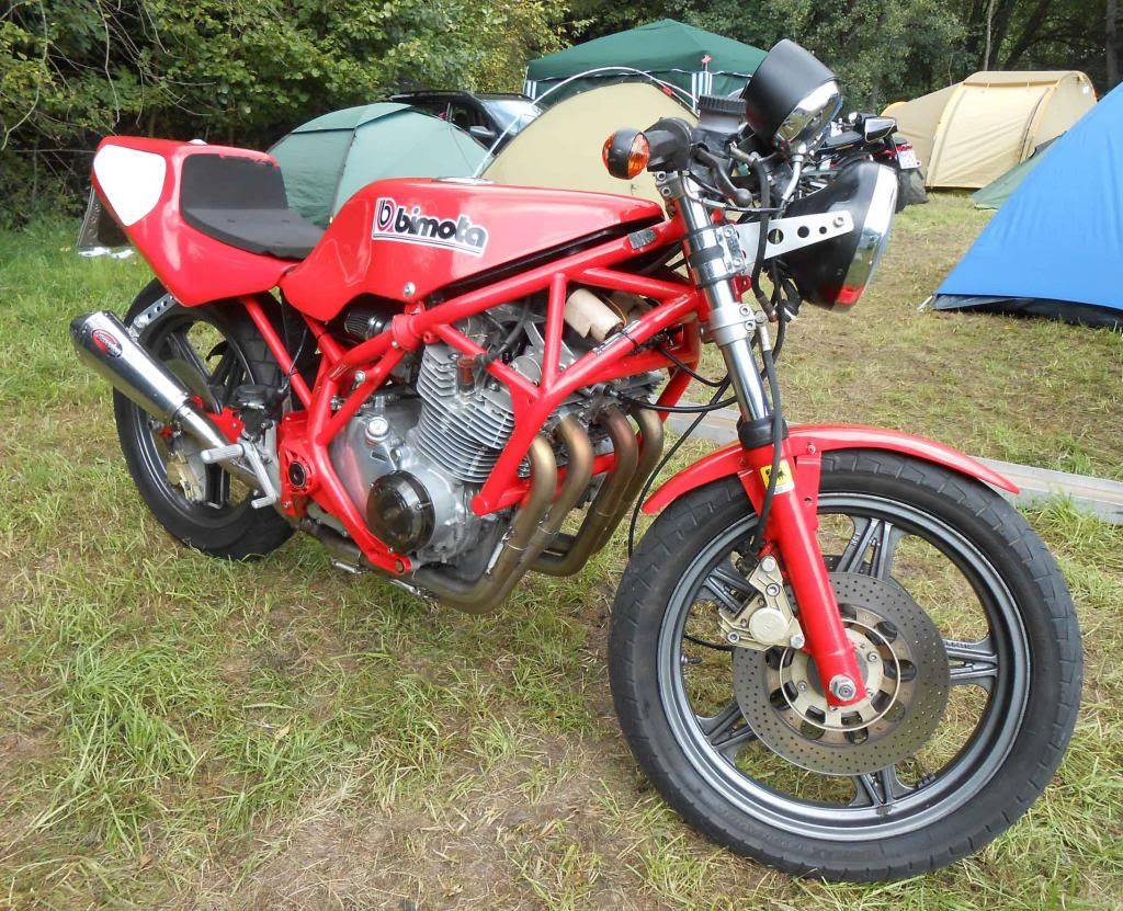

I saw 3 other DB2s there, all painted and modified, this one with a 1000cc fuel injected engine and carbon fibre bodywork.
Very nice SB3, which took part in the Classic Sprints.
