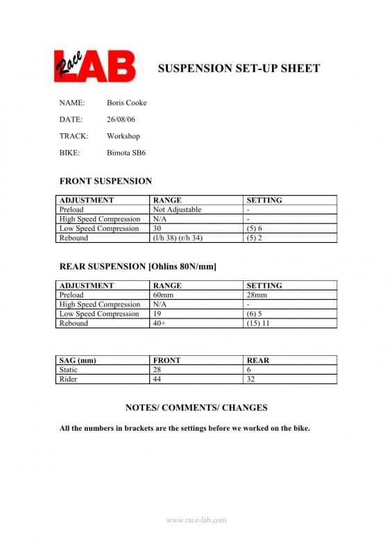

Posted: Thu Jun 06, 2013 1:15 pm Post subject: |
Try this

Evilchicken0 wrote: |
Try this
Many thanks!!!  _________________ Honda CB450K1 - CB750K2 - CB500K1 - RC30 - Ducati 750SS - Bimota SB6 |
