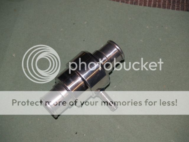

How difficult would it be to use some other thermostat, modify it if necessary, and custom fabricate a housing for it to fit in the same location as the original or very close to it? I'm not familiar with the thermostat on the SB6, so I was wondering. Have a pic, Oily?
Edit - From the picture from crankcase's link, it looks like they make similar ones for marine applications - http://www.ebay.com/itm/Marine-Inline-Thermostat-Housing-Fresh-Water-Cooling-Bypass-/370584615898
Same as this one - http://bpi.ebasicpower.com/p/SEASK3002/Inline+Thermostat+Housing+Fresh+Water+Cooling
That one looks to be 1-1/2" (38.1 mm) water connections and 5/8" (15.8 mm) bypass and probably from a Seadoo watercraft by the part number.

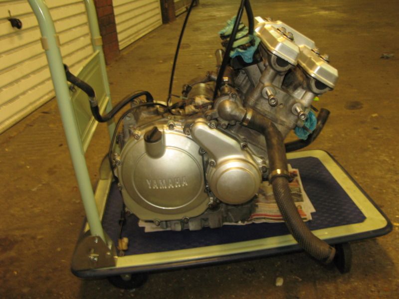

Are we over thinking this though ?
The thermostat housing sits behind the block on this FZR400. If we were to use two bottoms bolted together it should work and it would be inline. I can't remember where the recess for the thermostat is, it has an integral gasket and different themperature openings are available. _________________ Don't read everything you believe |
Posted: Thu Sep 20, 2012 2:43 pm Post subject: |
That's where I was going (eventually, when time allowed) two billet caps bolted together BUT there is still limited space so a compact solution is required.
I like the idea of being able to change the stat (unlike original) for different temperatures  _________________ SB6 mk1 (project mega light, big bore)

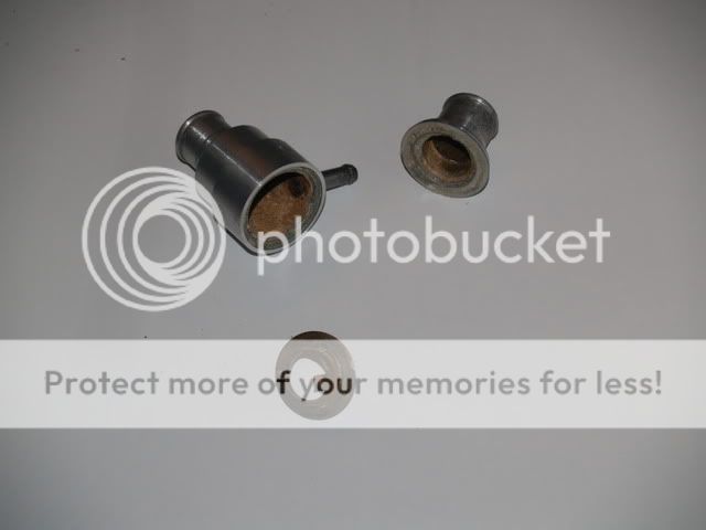

Posted: Fri Dec 14, 2012 12:44 pm Post subject: |
... Donated by a very benevolent forum member....
...destined for the first big bore when I get time.....this means I now have a working thermostat for each Bimota in the garage........for now  _________________ SB6 mk1 (project mega light, big bore)
Posted: Fri Dec 14, 2012 12:59 pm Post subject: |
But does that mean you'll be cutting an old thermostat up ? _________________ Don't read everything you believe |
Posted: Fri Dec 14, 2012 1:09 pm Post subject: |
...pay attention .....
I cut up the original fooked thermostat which came with the "big bore". Did it last year.....
...anything in particular you need?...dimensions? _________________ SB6 mk1 (project mega light, big bore)
