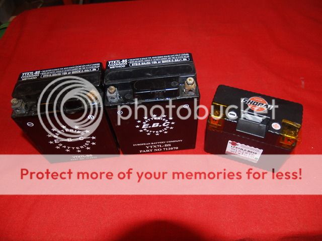

Now stealing the Shorai battery I bought for my project to fit on to my latest SB6 which has a couple of duff battery's.
Should be a good test.
2 X YTX7L-BS Vs 1 X LFX14L2-BS12......
...The 2 YTX7L's weigh in at 5350gram's measured on M's scales.
...The 1 LFX weighs in at 676 grams
as long as it does the job, it's a no brainer .
The LFX is a bit over double the price of two YTX's.
Me thinks a bulk buy could work here.
Any body have a contact at carrot cycles (the importer)? _________________ SB6 mk1 (project mega light, big bore)

Posted: Mon Nov 19, 2012 2:44 pm Post subject: |
...First impression....
No problem cranking over a SB6 that hasn't been started for a while  _________________ SB6 mk1 (project mega light, big bore)

But is the Shorai the YTX9 equivalent? Are we comparing like for like? There are a whole range of SPS batteries available, maybe running a YTX12 equivalent would give you the desired Ah? And were the 2 SB6 batteries used to generate the required cranking power? The Lithium batteries are some 40% better for CCA, so can maybe run a smaller unit for running power.
Can tell you for sure though guys, the Lithium YTX9 on my SB6-R starts it far better then the lead acid battery did.
The offer and the option is on the table though, I'll do whatever I can if it's a help on the supply side.
Daz. _________________ It's mine and I'll wash it as fast as I like! |
Posted: Mon Nov 19, 2012 7:14 pm Post subject: |
...I'm no expert Daz...i've just googled this info
Sb6 is normally 2x YTX7's each @7ah and each @ 120cranking amps
The shorai LFX7 has comparable ah and cranking amps
BUT the shorai LFX14 has the same sized case but has 14ah and 210 cranking amps, this is the one I'm testing.
Most modern bikes have about 12/14ah battery's depending on electronics and engine size/compression etc.
YTX 9 has 8ah which if that works, then that's superb.
What I do know is....1 X ytx7 which is 7ah and 120 cranking amps, is not man enough to start my sb6 in anything but optimum conditions and I'd call that a marginal battery
I imported my shorai from the states and got stung with the duty. It cost a bit over a £100 so comparable in price with the SPS.
Carrot motorcycles, the importer want £130 for them  _________________ SB6 mk1 (project mega light, big bore)

Basically you want the size of a single YTX7 with the terminals on top but 200 CCA
Manufacturer: YUASA
Battery type number: YTX7L-BS
Battery type: Sealed maintenance-free battery
Filling kit included: Yes
Dimensions: 114mm x 71mm x 131mm
Capacity rating: 6Ah
Cold-start performance: 85EN
Maximum charging rate: 1 Amp
Weight (filled): 2.5kg
Terminal layout: Left: - Right: + (With the terminals on the edge nearest to you) _________________ Don't read everything you believe |
