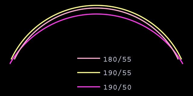

That 190/50 is a pretty flat profile and it's probably working against you.

The 180 is on a 5.5" rim and the 190's are 0n a 6".
FWIW- I use a 180 on my Aprilia's 6" rim. Going to do the same on the SB6.

My 6R has a 5.5 antera on the rear with a 180 tyre. practically falls into corners Wink
Bear in mind that it's missing 600lbs of ugly fairing which obviously changes the handling considerably Shocked
Nice schematics Cbar, rushing out the garage now to see what I have, and there seems a big difference in the 50's to 55's that should be noticeable on the road

PostPosted: Fri Aug 24, 2012 4:41 pm    Post subject: Reply with quote
Thanks, but it's not mine.
http://www.sportrider.com/tech/tires/146_0302_rear_motorcycle_tire/
