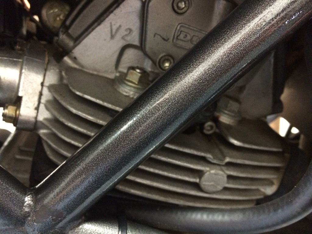

Photo of paint
[img]http://s1341.photobucket.com/user/Jimip86/media/IMG_0723_zps2luv3nxv.jpg.html[/img]
Jimip86
Joined: 15 Jul 2015
Posts: 49
Location: Derbyshire
PostPosted: Thu Jul 16, 2015 8:56 pm    Post subject: Reply with quote
looks like ive got the image post wrong haha
Jimip86
Joined: 15 Jul 2015
Posts: 49
PostPosted: Thu Jul 16, 2015 8:58 pm    Post subject: image second attempt Reply with quote
http://i1341.photobucket.com/albums/o752/Jimip86/IMG_0723_zps2luv3nxv.jpg
PostPosted: Thu Jul 16, 2015 9:36 pm    Post subject: Reply with quote
Jeese...I hope you get this posting of piccies sorted soon...personal secretary I aint..... Laughing
Does look like the normal grey used on the Db2's that had that finish....very hammerite-ish.......
